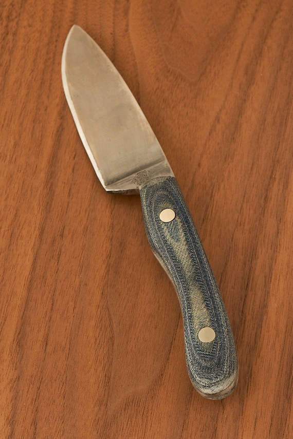

Fiberglass resin is just a term for any resin used to do fiberglass work. It could be polyester or epoxy ( or some other). It also may not be used wih fiberglass cloth, but some othe type material. As Natlek pointed out, fiberglass is a cloth and resin is a liquid.
Epoxy resin is the hardest. It is best for makin laminates for handles.
You need to understand, you can't make Micarta at home. It is made with phenolic resin and thermo-set under tons of pressure.
What people make is often called MyCarta. It is a laminate, but very diferent from Micarta.
