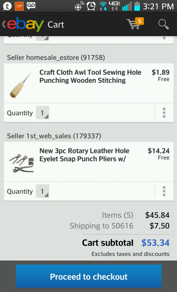

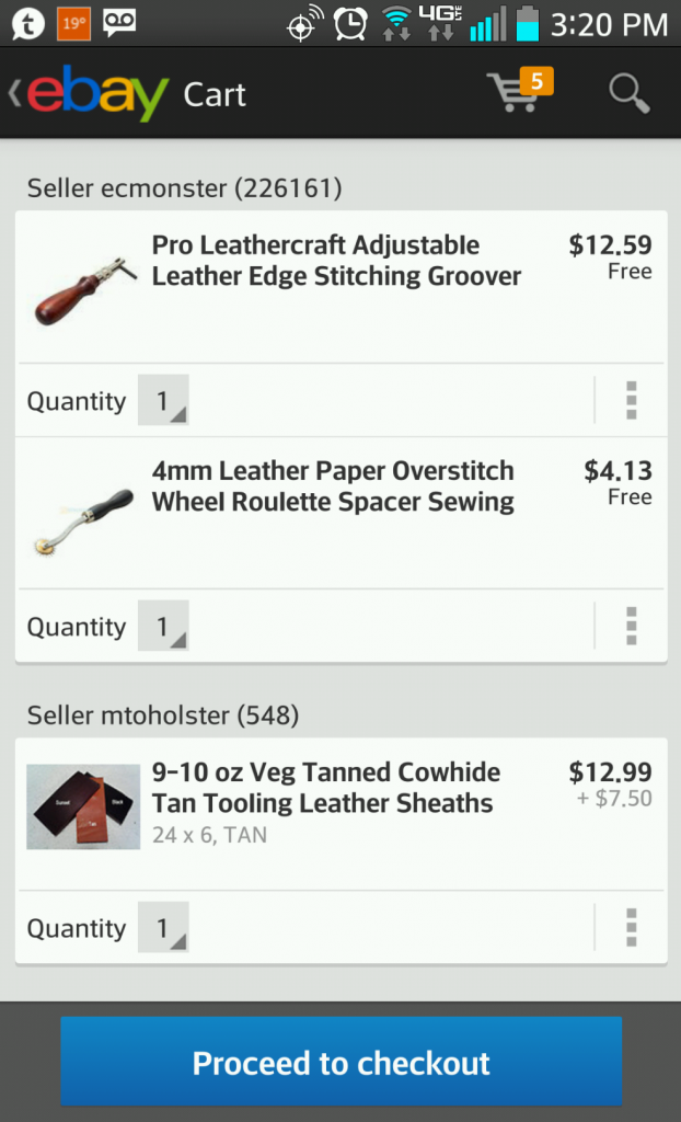

Hi. I'm new to sewing and making a sheath in general, but want to try it. I plan on using 9-10 oz leather and plan on getting all the basic tools and leather off eBay. Since its my first and probably make mistakes I want to keep the cost down. I got a drill press and plan on drilling all the thread holes. What size of drill bit? 1mm, 1/16"? And how far should the holes be spaced? I have no clue on needle size and types of thread to use. What would you guys recommend for a new guy?

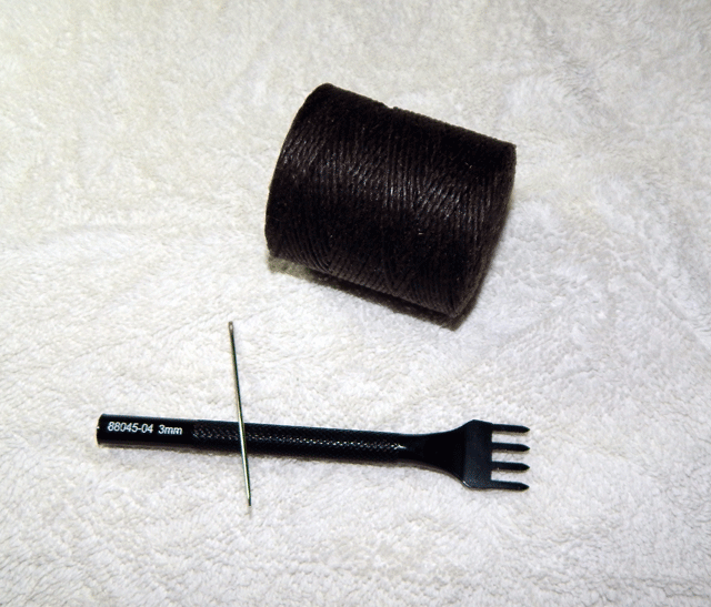

I have tried a few combinations but found I enjoy working with the following combination: stitching chisel, 00 size harness needle and nyltex waxed thread. I mostly use the 4 prong chisel to mark the holes and the 2 prong to make the holes since it is easier to pull out of the leather. The nyltex is a bit thick but it fills the hole nicely and is very strong. If you cut the end at an angle then it is very easy to thread into the 00 harness. This combination works well with larger sheaths and holsters, but for smaller sheaths the holes need to be closer and with a thinner thread.

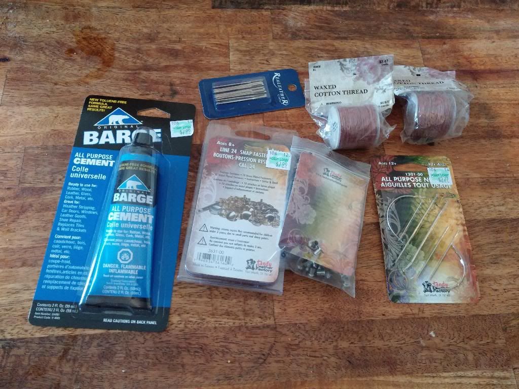

Thanks for the helpful informations. I think I have everything to make a sheath. Got some stuff from hobby lobby and some stuff off eBay.
Anything else i might need?

Just got my leather I ordered off eBay. Looks good, but I wasn't expecting it to be so thick. It's 9-10 oz and its a 1/4" thick. I'm going to have to order some thinner leather for the handle strap and belt loop part. What oz do us reccomend?
1/4" is approx 14 ounce leather, thats quite a bit over the advertised weight.
