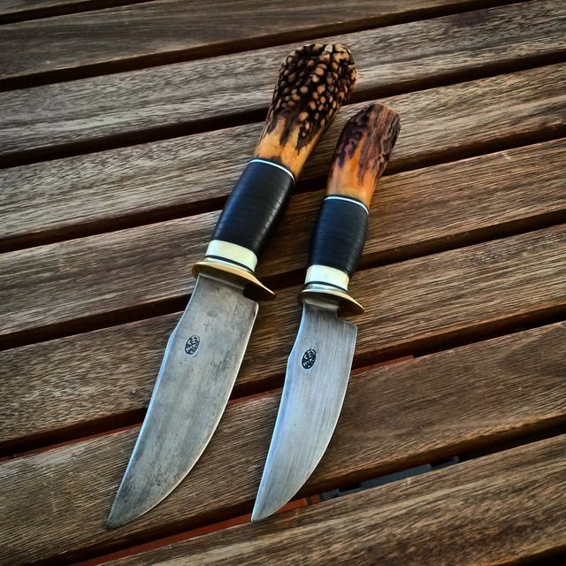

Morning friends. I'm looking for advice on a finish for the antler and possibly the Leather on this and other knives that I make. Any help is greatly appreciated. And any critiques on the knife are also appreciated. Sorry for the poor photography. Karl
