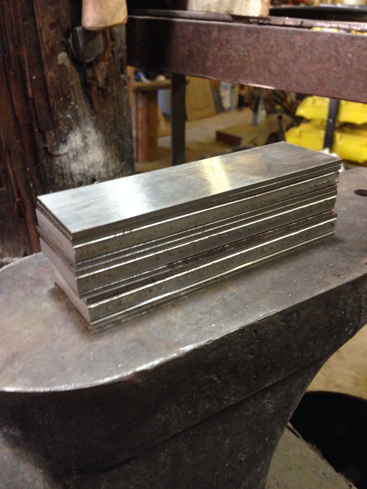

A four inch hunter that will be full flat ground on both sides and made from cpm154, it is going to have carbon fiber scales and pins, with a hidden lanyard hole.
Also in the works is a Small edc type fixed blade that will have orange and black scalloped scales with either a carbon fiber or a damascus bolster. This one will also be cpm 154.
Here is a Photo of these two patterns in the early stages of being cut out. Because at this time I do not have access to a band saw, the easiest way for me to deal deal with these alloys is to remove as much material as possible with a drill prior to actually cutting them out, either with a grinder or a jigsaw.

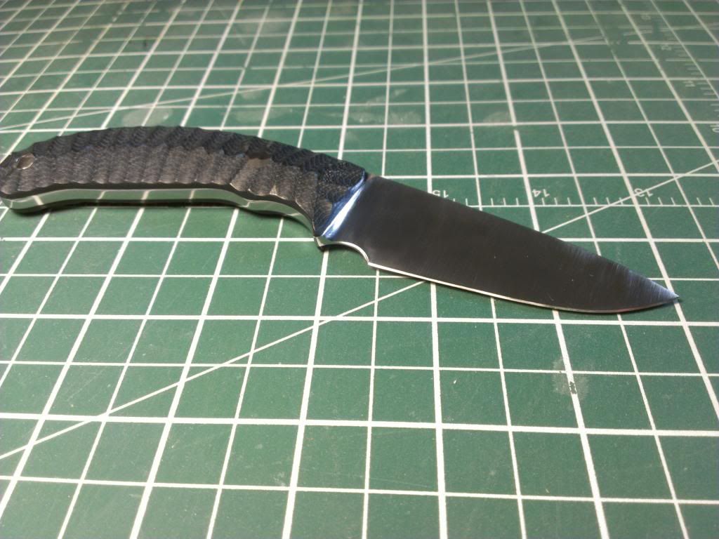

These two knives are nearly finished in this photo, the blue one has since been completed but the orange one still needs finish sanding.
Here is a closeup of the blue one now that it is complete, this one has a large choil that has been sharpened to prevent it getting hung up.

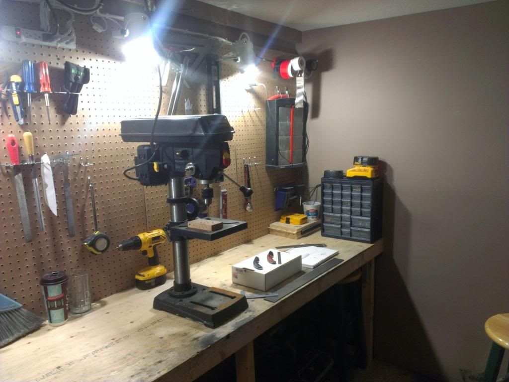

Here is the extent of my shop right now. The steel hanging on the wall covered in green tape are knives waiting for heat treat.
I recently started making knives. I ended up deciding to build my own tiltable 2x72 grinder due to cost, and because I have experience with machinery building.
