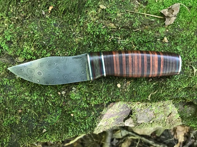

Well, I didn’t get to any pattern welding this weekend, but I did get this little knife finished up. It’s 0.060” S35VN, Rc62, with padauk scales. I took it to 0.002” before sharpening at 11dps. A friend of mine wanted a copy of my wife’s paring knife (I know it’s big for a paring knife, but she has arthritis, and she designed what she wanted.) I made hers nearly seven years ago out of 15n20.
