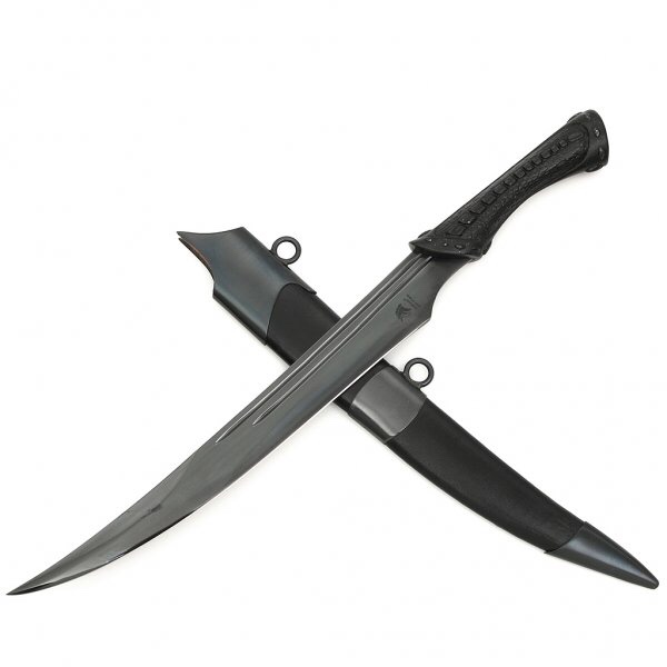

Attached are some knives that I like.

Now I see of the four knives the OP posted two alpear to be modern "tactical", one appears to be more traditional, and the last one seems to be some sort of modern fantasyesque sword? It kind of reminds me of something from Lord of the Rings.
