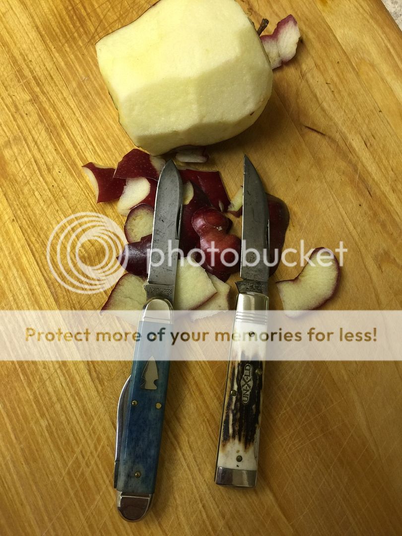

I've been cutting apples and strawberries with an old slip joint jack knife I've got and the results look pretty sweet.
