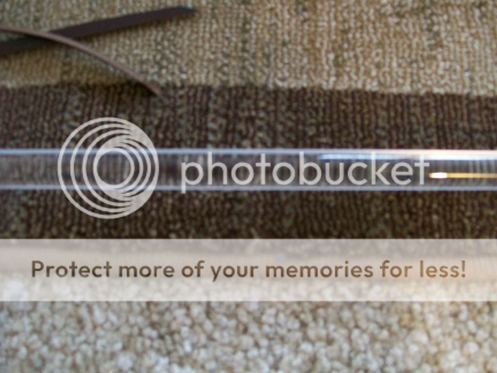

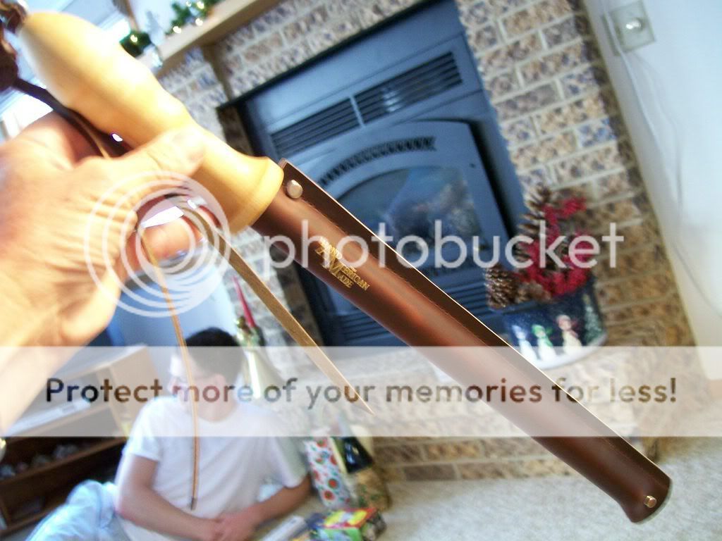

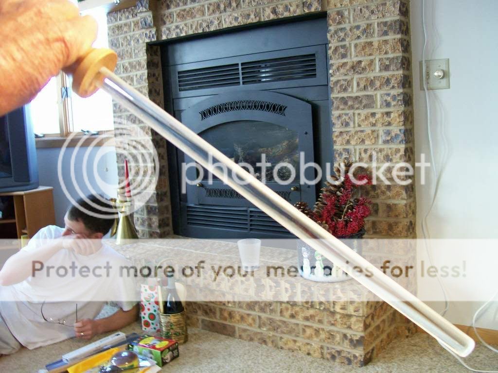

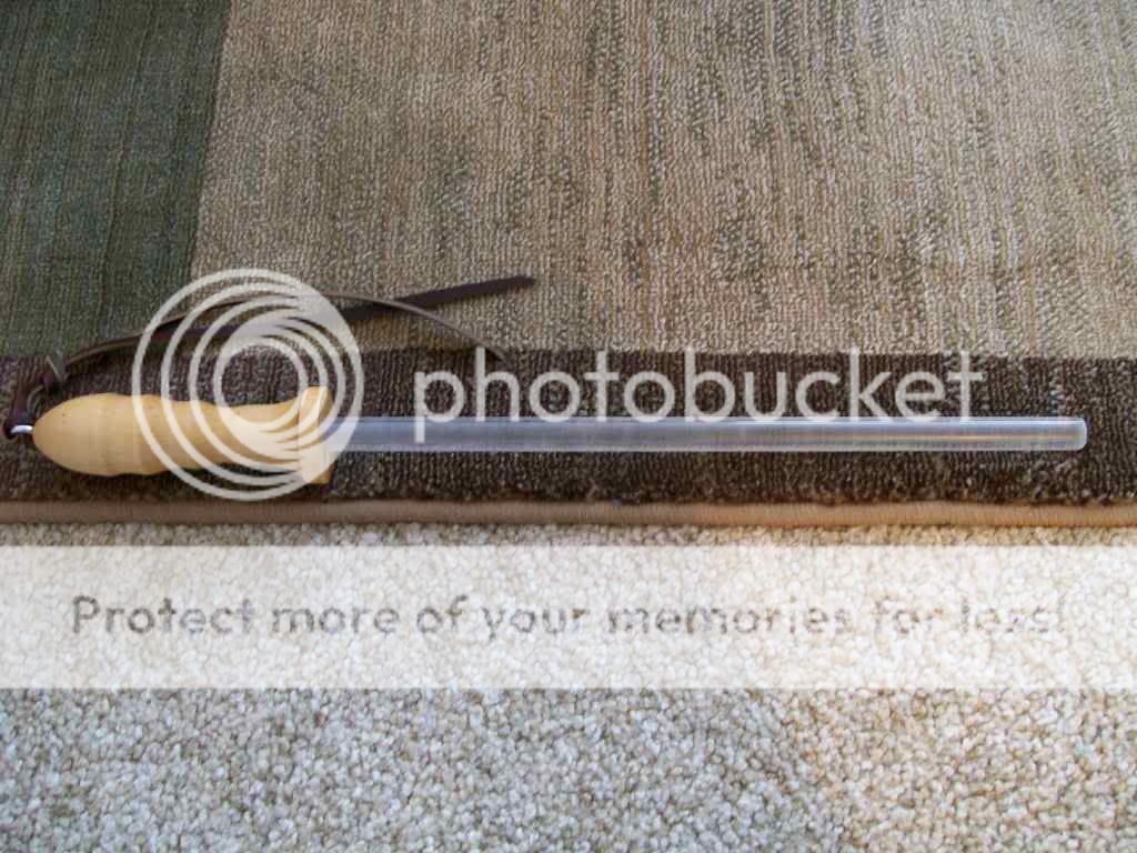

There is something new and better. Hand American Borosilicate (glass with boron) steels available at JKS. They are microgrooved and the experience is that they work equally well on German soft steels and Japanese hard steels. Caveat: Use VERY light pressure.

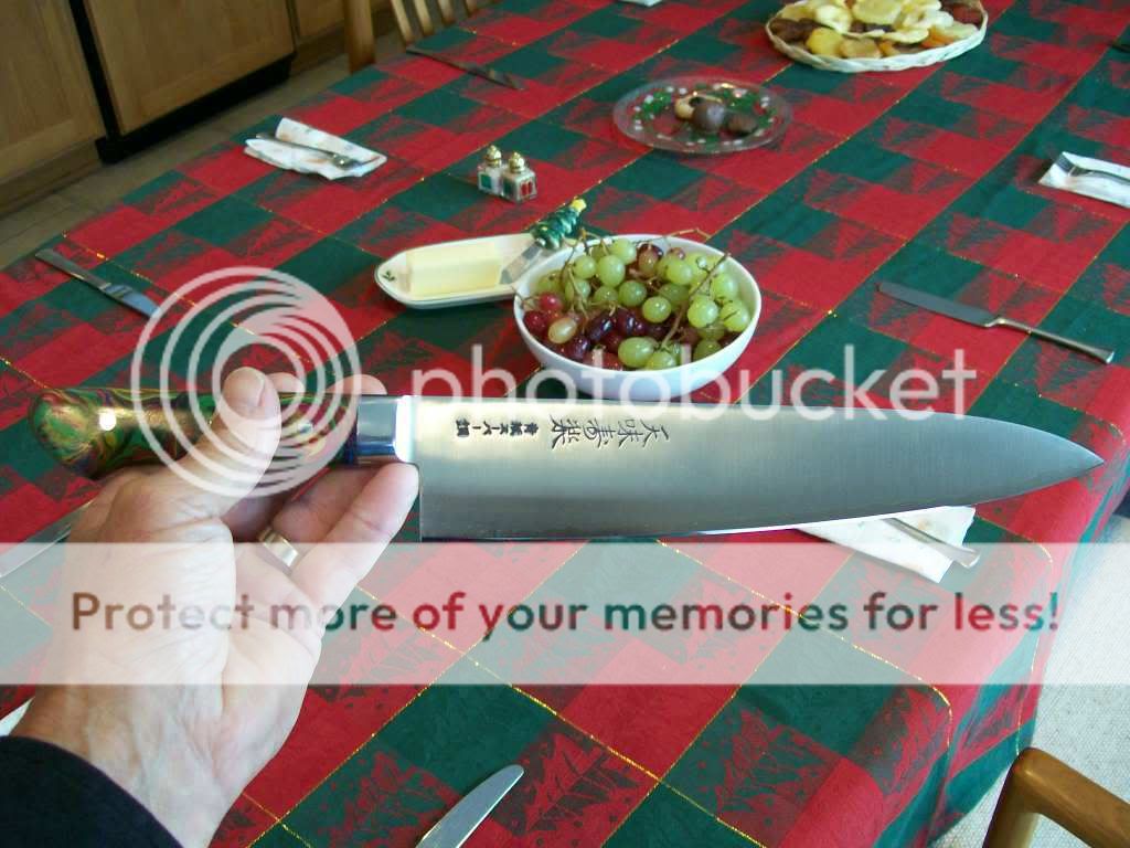

Do that. You won't be sorry. I should clarify something. Looking at the last of the four pix I posted you can see that it is clear. That particular boro rod was glass smooth on opposing quarters and microgrooved on the other two opposing quarters. The ones made today are microgrooved all the way around. The smooth sides on the pictured rod work the same as the glass smooth steel steels. That is, they work great for realigning edges on the rolled softer steels. Japanese knives are not very prone to edge rolling, they'll usually chip or merely dull first. The microgrooves seem to carry out the dual roll of both realigning and very slightly honing (like a ceramic rod). This is (my opinion, nothing more) why they work on both hard and soft steels. So far it has worked well on HRc 62-63 Hitachi Blue Super and Hitachi White but I have not yet tried it on harder steels like SG-2, Cowry-X, ZDP-189 etc.
I have gotten into the habit of applying the microgrooves before nearly every use of my Japanese blades. It only takes about three very light strokes on each side and the edge comes back to about 90%. Once this quits working the metal is fatigued (again, just my opinion) and it's back to the stones.
