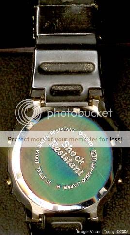

Could it be the classic Casio G-Shock DW5600?
This is one of the current variations
The original with screw-down back version was called the "Speed" (as in the movie) watch -
and has become somewhat of a collectible
The DW5600 is a Casio G-Shock that I knew I had (somewhere
This model DW5600 (with gold tone metal buttons and hardware) has got to be well over 10 years old - still on its original battery -
the watch did reset itself when I pushed the light button - but I was able to reset the time back in March/2005 when I took the photo - it was still "ticking" fine (I just checked, and it is still going....).
