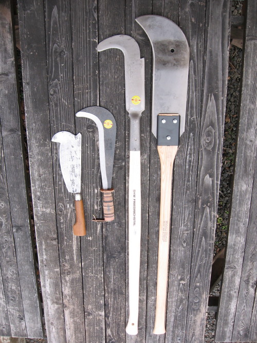

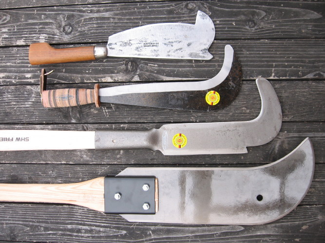

These were all bought in the USA (though the smallest is a vintage one from that auction site).
These were acquired fairly recently and have not yet been put to work.
From right to left, a Truper from Mexico, with 51" total length.
The next two are made in Germany by SHW.
The smallest is an old "Severquick" made by the Staniforth company in England.
The Truper is double-edged with a blade thickness of 1/8".
The long double-edged SHW has a blade thickness of 1/4" tapering to 1/8".
The other SHW has a blade thickness a little over 1/8".
The single-edge of the Staniforth has a single bevel, and the blade is quite substantial with a thickness of 1/4" tapering to 3/16". The tang is peened at the end of the handle.
