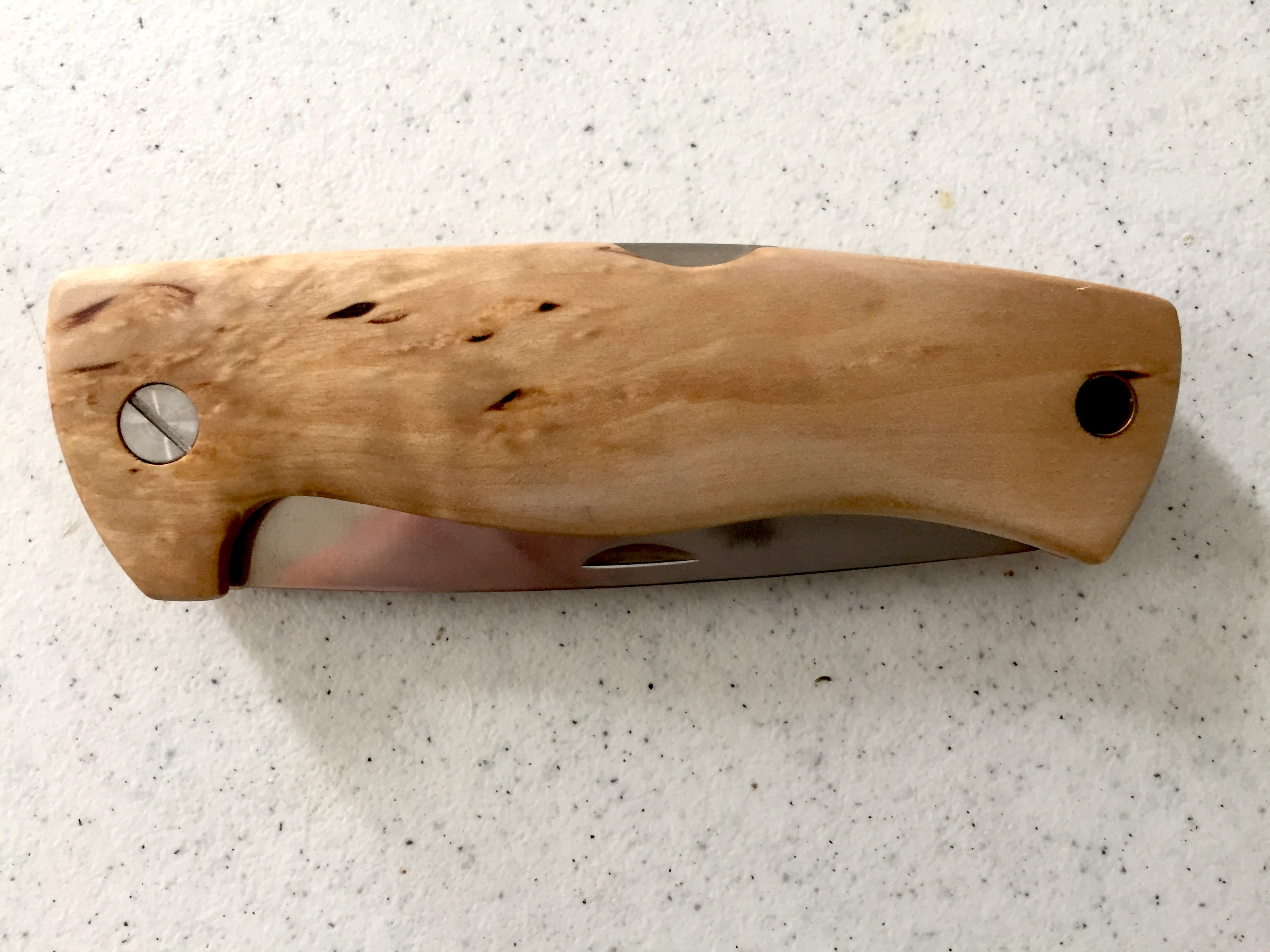

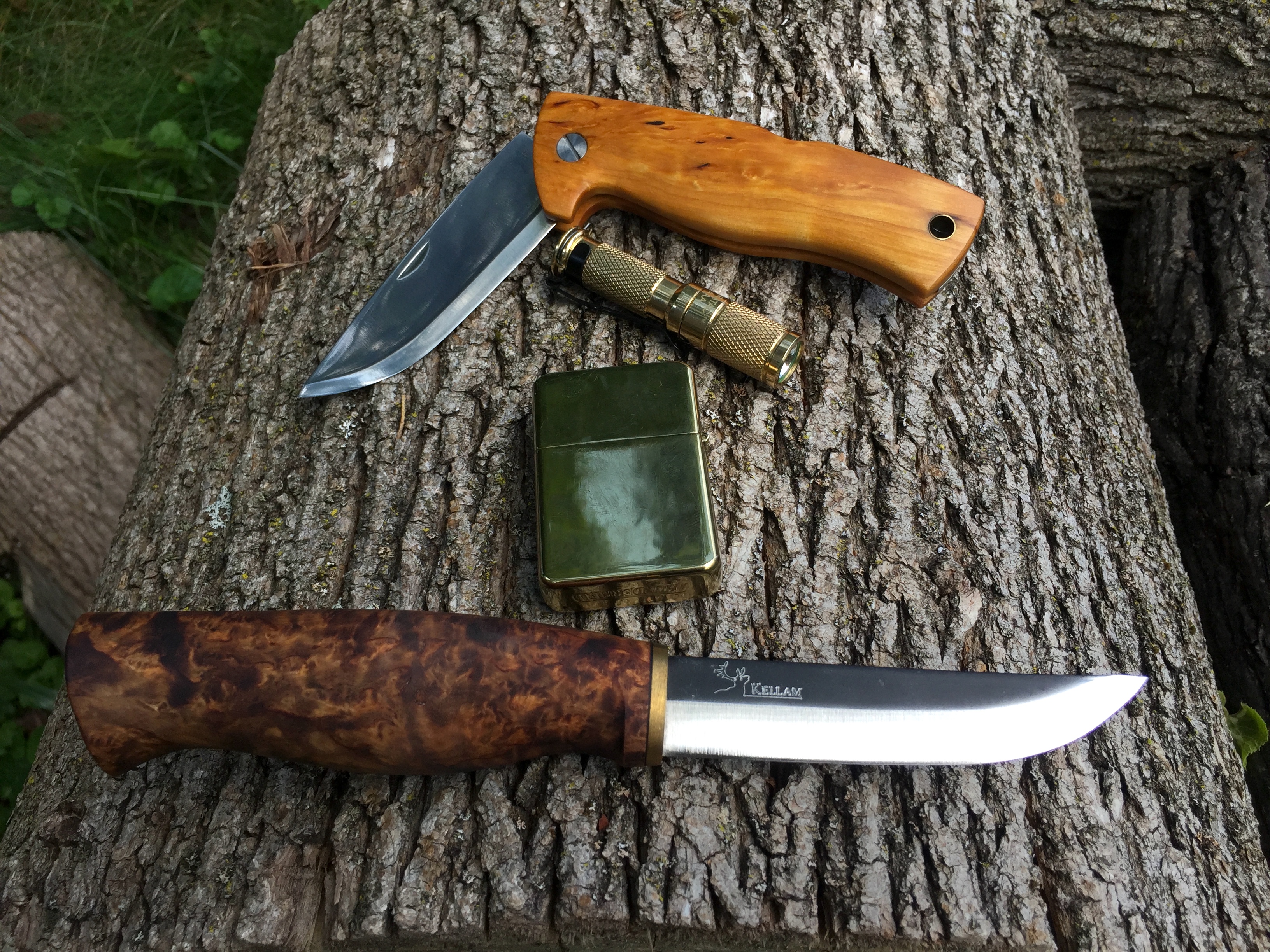

I like Linseed Oil or Boiled Linseed Oil followed with beeswax and mineral oil. Then just an occasional beeswax and mineral oil application (maybe once a year or so - more often for heavy use) to help seal against the elements. The Helle folder below was treated with three coats of BLO and then 3 applications of beeswax and mineral oil. The only down sides I can think of is that the treatment will darken and yellow the wood a bit (I rather like it), and periodic maintenance. The up side is that the finish is easy to repair and very comfortably smooth but not slick. This is also what I use on my axe hafts and I just refinished a rifle stock this way.
Edit: This is what the knife looked like before I did anything to it:
