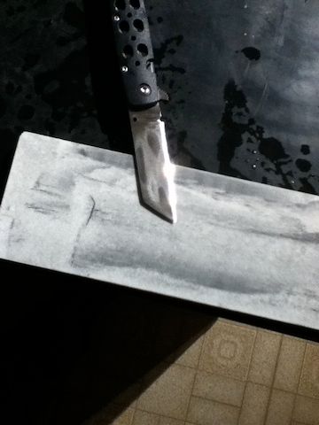

Shapton 120
. . .CPM154 and CTS-XHP steel.
PS:
That blade on the white 120 is CTX-XHP. As you can see that stone just loves to cut that steel. One of my favorite steels.

A little more info about the 120
I was honing out the scratches caused by my super coarse diamond file while flattening the sides of this blade. I was using the Shapton Pro 120. it seemed very different this time from the last time I did this with another Cold Steel Ti Lite IV. Gee this is going MUCH faster; honing large areas flat and much smoother. Hmmmmm. Was a real struggle and slow going last time.
Ohhhhhhhhhh
This is AUS 8
Last time it was CTS-XHP
Wow there is a huge difference here.
Don't get me wrong this stone was doing great with the CTS-XHP . . . I have similar and more coarse white stones up to 80 grit that would just STOP cutting and smooth over while flattening large surfaces of this and similar tough steels.
Any way if you are sharpening softer steels like AUS 8 this thing blazes through that stuff.
