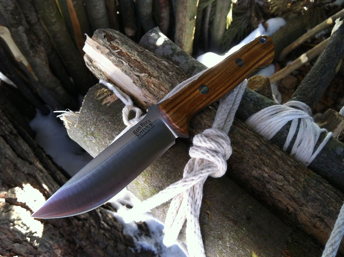

For a totally reliable knife I'd want either a Bark River in A2 or a Battlehorse in O1. However, given the criteria that you laid out, I'd also consider getting a couple of the 1/8" thick carbon steel Moras (They're 1095 IIRC). Three of them weigh about what one medium sized full tang sheath knife weighs, so you can carry spares. If you snap one, you won't be SOL - just dig into your pack for another one....
Also, don't sweat the rust thing. Carry a couple of chapsticks on you. After you wipe the blade down, add a thin coat of chapstick and your rust worries are history. Since they are made from a food grade wax, you won't poison yourself as you keep your blades from rusting.
