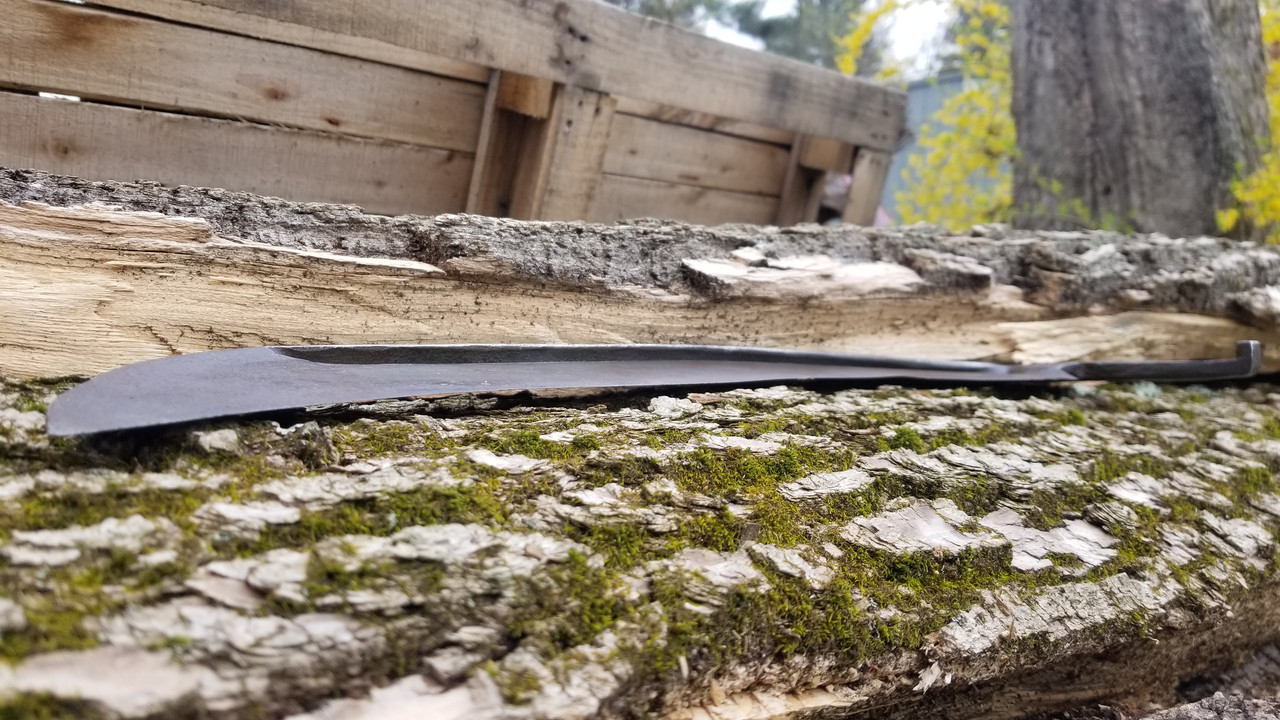

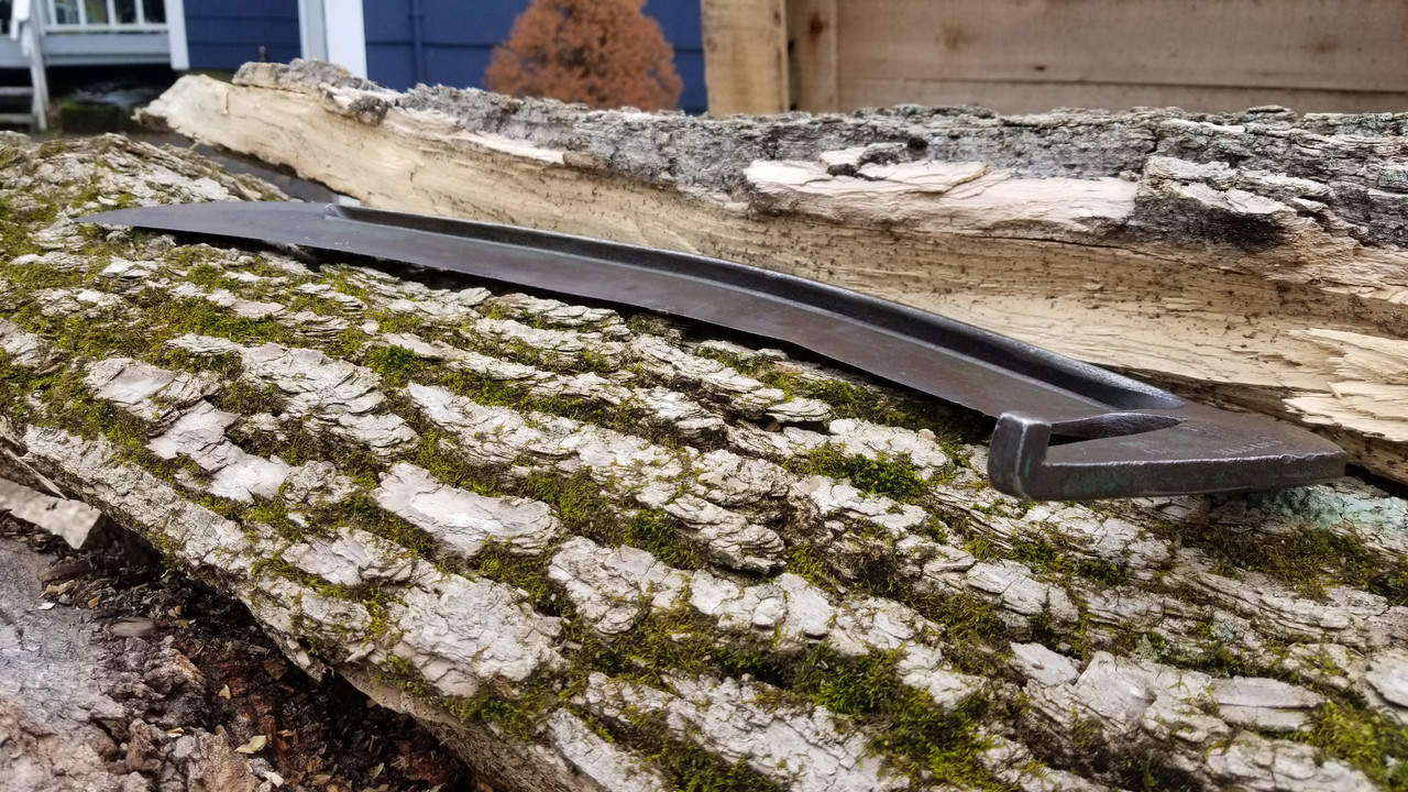

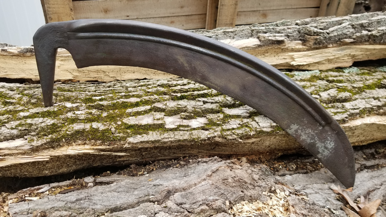

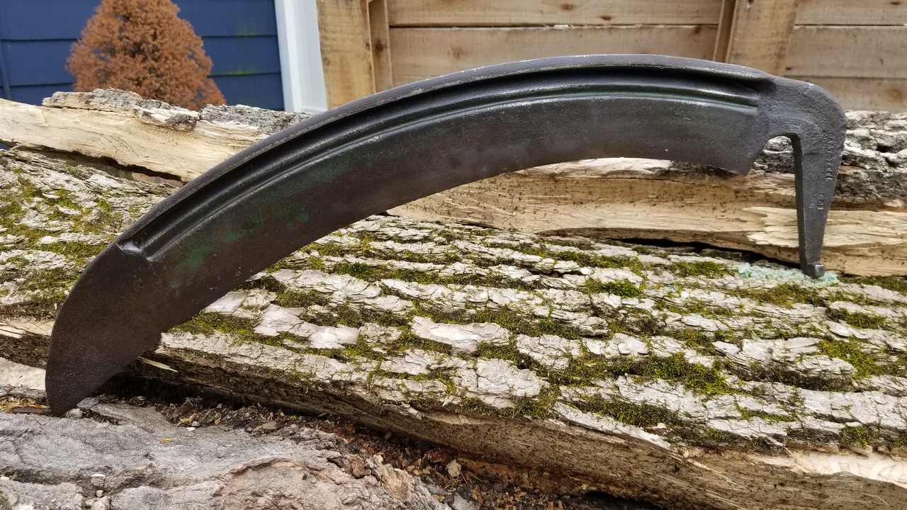

The collar was never hardened to begin with so no loss there, but the blade would definitely need to be heat treated. It's a True Temper Briar Edge from the 1950's-ish, and it's whole steel rather than laminated. It would probably be fairly safe to treat it like 1080 and target 55 RC. You'd need to send it somewhere that can handle tools that big, though.
  • Like
Reactions: A17
I'll need to buy or build a handle for it first. I have a peavey and a log carrier that (I imagine) are from the same fire. Now I'm curious as to where and what fire they're from. The only local fire I know of was back in the late 80's or early 90's.
Just use it like it is.
I really wouldn't. Either get it re-heat-treated or (more realistically) get a different blade that hasn't been through a fire. Annealed steel is not going to be able to support the thin edge angle that a scythe requires, least of all if it's a bush blade.
  • Like
Reactions: A17
And I'd try file-testing the edge just to be sure. It does have the look of a tool that's been through fire rather than the proper factory finish or simple rust from neglect, but it's worth checking before drawing any conclusions. Those blades should be moderately hard--about the hardness of a nice vintage axe. If a file cuts it like butter then it's definitely annealed.

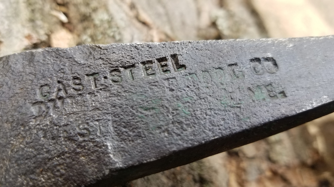

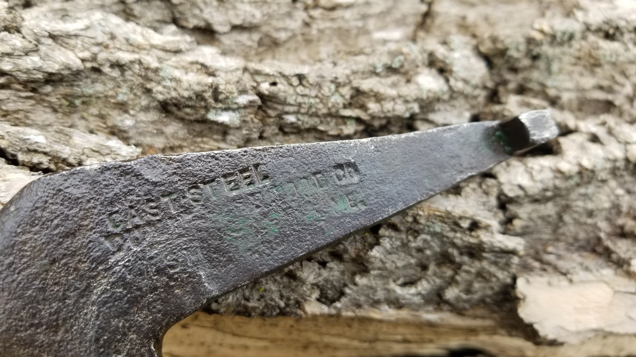

Yup. West Waterville. That's a decently old blade in nice shape. Treat it well! Dunn made some of the best!
Thanks for the West Waterville confirmation.
I have not looked into more than finding West Waterville was formed in 1883 and I am assuming, without any knowledge, Dunn stamped West Waterville is an earlier mark and maybe earlier factory/location.
The Maine collection grows
Yes they later moved to Oakland, and then eventually were absorbed by the North Wayne Tool Co., which started in North Wayne, but moved to Oakland while retaining their name.
