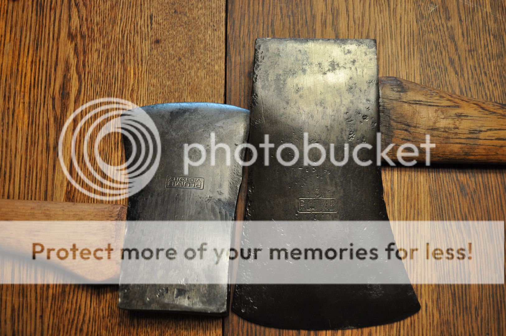

I have a 5 Lb Plumb Dayton. I bought it on a whim. I haven't tried to swing it yet.
It's on the top, with a 3.5 Lb Plumb Dayton and a Plumb Boys axe below it.
[URL=http://s810.photobucket.com/user/doubleott/media/Plumb%20Five%20Lb%20Dayton/Plumb5LbDayton005.jpg.html][/URL]
Even though the helve on the 5 pounder looks longger than the others, it is a 36 inch helve.
[URL=http://s810.photobucket.com/user/doubleott/media/Plumb%20Five%20Lb%20Dayton/Plumb5LbDayton013.jpg.html][/URL]
Boys and a 5 pound.
[URL=http://s810.photobucket.com/user/doubleott/media/Plumb%20Five%20Lb%20Dayton/Plumb5LbDayton023.jpg.html][/URL]
