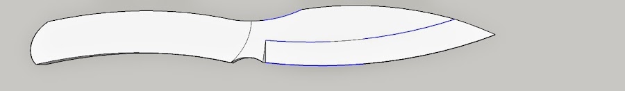

I've been looking for a good medium-large fixed blade (5"-8" blade) for over a year. I want something high quality and I'm willing to put some money into it so I've been waiting for something to grab me as a "I must have this" knife but haven't had much luck until I started checking out the offset design of the nessmuk / canadian belt knife. I was tinkering around on google sketchup and came up with this design that's been growing on me more and more. I feel like I'd love to have something like this riding in a horizontal or highly canted sheath:
Anyway is there anyone out there already making something like this? Is my design a sound one? Would you call it a nessmuk, canadian belt knife, abomination or something else entirely? If I need to go to a custom maker for it I am willing but I know so little as to what I should ask for that any help here would go a long way.
Thats a good design, its definitely more canadian belt knife than nessmuk but a solid design either way. The grind appears to be a scandi though, was this intentional? A design like that may be better suited to a hollow, flat, or convex grind, however a high angled scandi may work well too (perhaps 18 to 22 total grind angle).
As far as production knives, check out the Bark River Canadian Camp (6.5") and Canadian Camp II (8") as your sketch is fairly close to the same profile. I don't have either of these but have the smaller Canadian Special (4 1/8") which I really like the design of. They have a convex grind where your sketch looks more like a scandi grind as JCKT noted or perhaps a sabre grind.

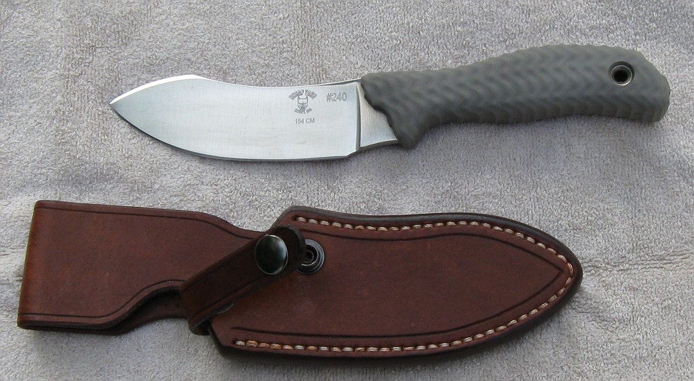

JK Handmade Knives (also has a subforum here)
Busse Hog Muk (only on the secondary market) (image from zknives.com)
SYKCO ScrapMuk (also secondary market only) (image pulled from ar15.com via google)
