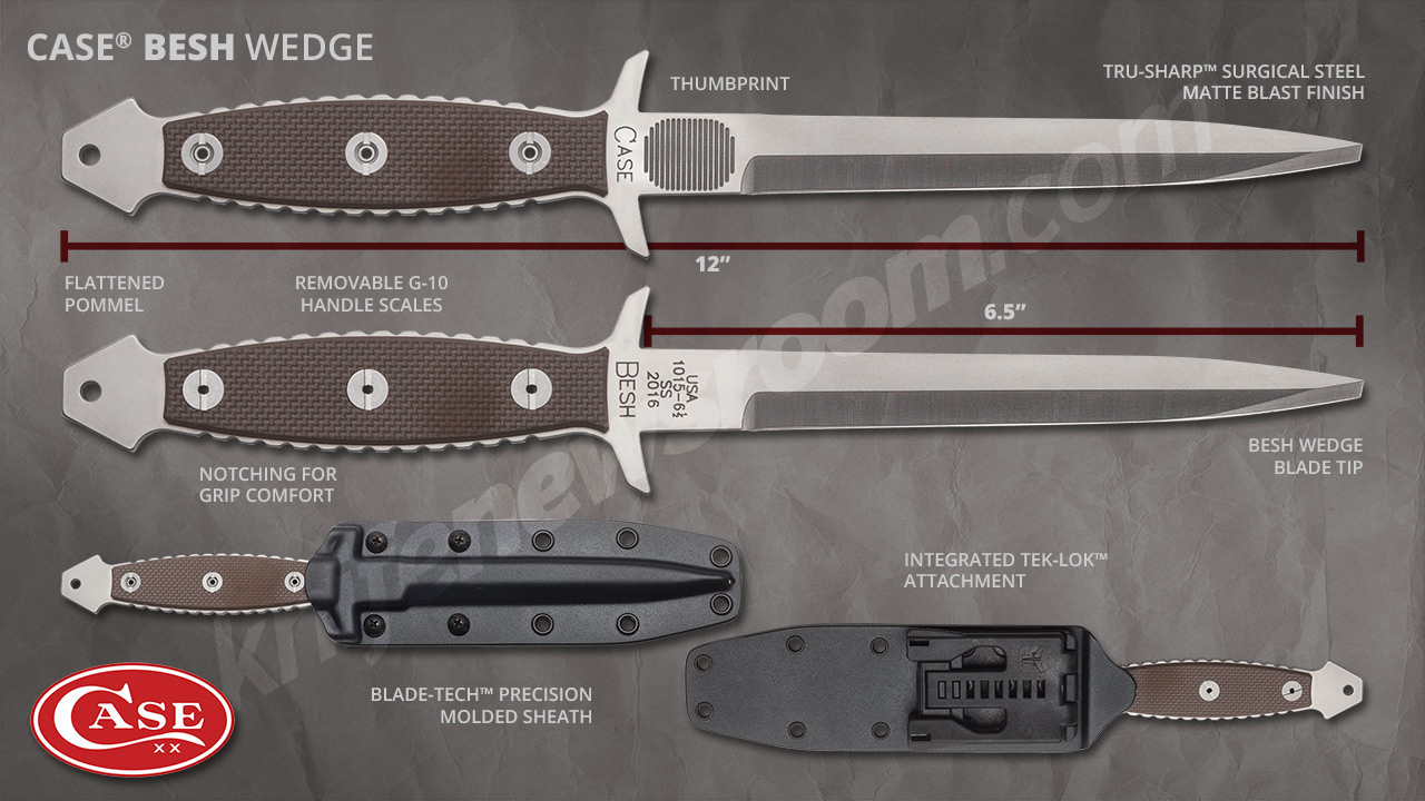

Hickory n steel Hickory n steel yes case did make some of the originals. Here is their updated version featuring the Besh wedge. (Should be a strong enough tip for OP)
Surgical Stainless :rolleyes: oh Case, you friggin’ guy you...
