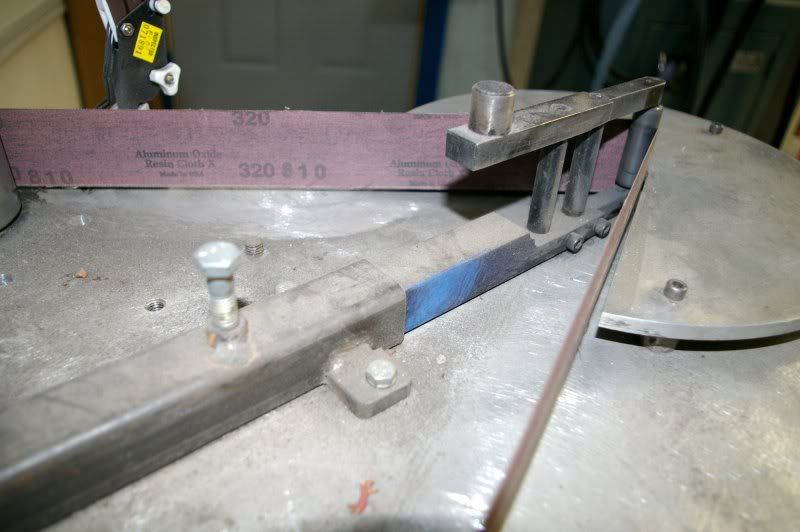

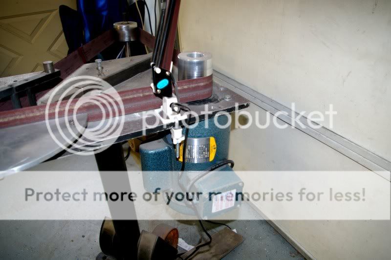

Bad couple of pictures of my home built horizontal grinder,

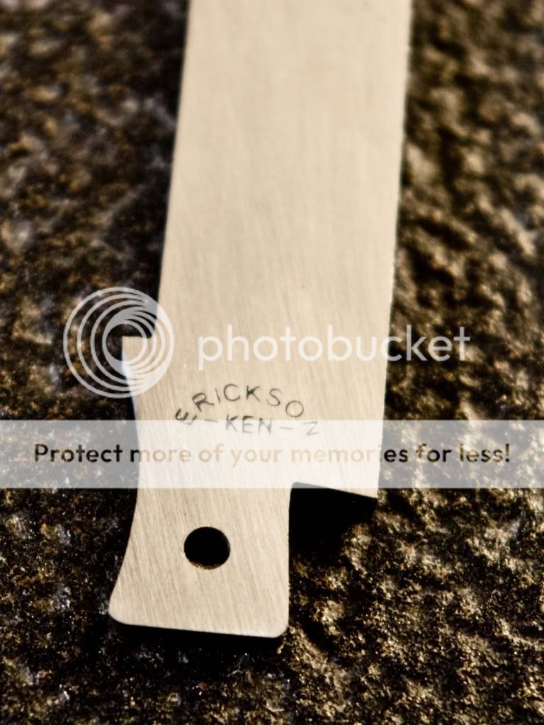

I find it invaluable for grinding the inside radius's that are found on slipjoint backsprings. Keeping things square on these springs is extremely important.
I also use the grinder for grinding the "kick" area of the tang along with thumb notches.
The only thing in my mind that would make this grinder better would be to add variable speed:rolleyes:

I don't believe I've made a knife straight blade or folder,-esp. folder where I have'nt
used it since I flipped one of my square wheels on its side. Pretty awsome for the inside
of guards. Variable would be nice though I find 2 7/8" drive pretty sweet.

Contraption that it is, the height adjustment is pretty accurate and fast.
I don't seem to end up with stuff wanting to twist. Ken.
