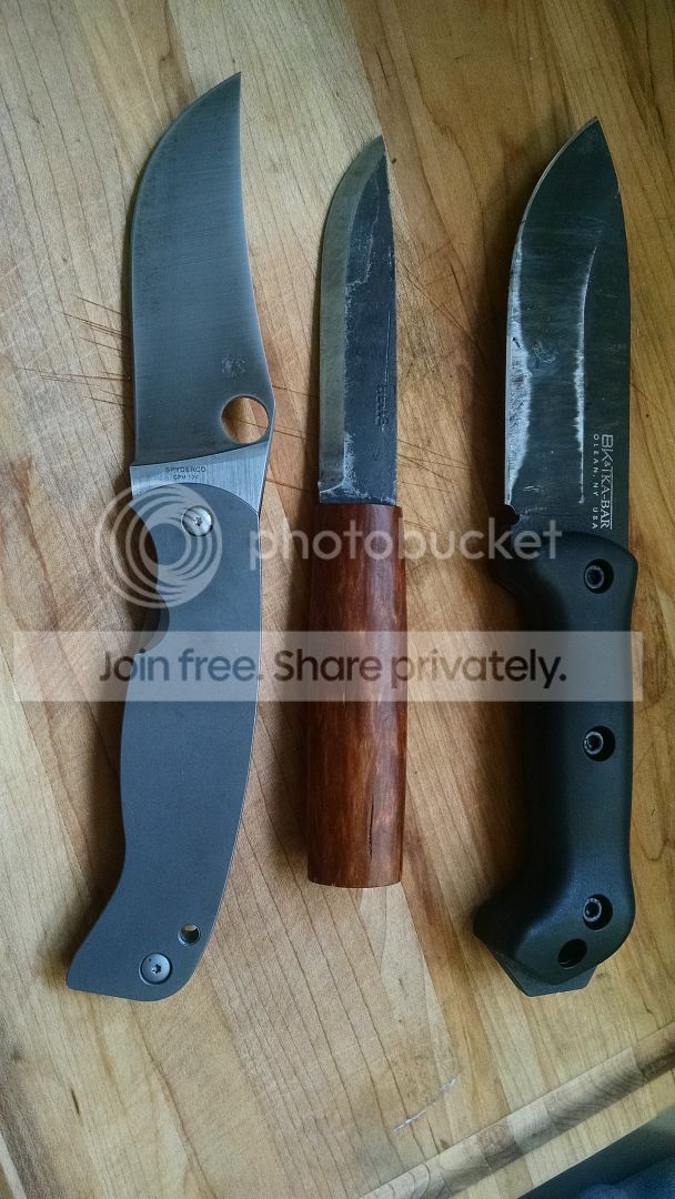

Flat, Scandi, Saber

There are manufacturers, like Buck, who would refer to that Becker as a flat grind, and who would distinguish that from a full-flat grind, as on the Spyderco.

This is how I understand it.
Scandi grinds are a single "flat" grind, with no secondary bevel (a zero edge).
Saber grinds are a "flat" grind that goes up the blade, but not as far as the spine, that feature a secondary bevel.
Full flat grinds are ground "flat" all the way to the spine, and feature a secondary bevel.
DeadboxHeroes photo shows each of those, and he identified them the same way that I would. I also agree with his and Marcinek's description of what they are good at. I am no expert though, so this is merely anecdotal evidence (that I agree with them).
I find that Full flat works great for slicing through things, as such, they make great food prep and general utility knives. Saber knives are more robust, but sacrifice some cutting performance, particularly when you're completely "submerged" in the media). Scandi's are excellent wood carvers in my experience.
Thats just my two cents though.

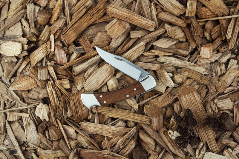

You would think, right?
But the folks on the Buck sub-forum have "educated" me to expect zebras on this forum.
What would you call this grind?
Buck calls it (and thus the BCCI Buckalites will insist that is) a "Flat Grind". I don't have that particular secret decoder ring, so who am I to argue.
For the OP, I don't like pure Scandi grinds, so I can't defend them. Those who like them claim they can be easily sharpened by putting the full zero-grind bevel flat on a stone and that they give superior wood cutting performance. Personally, I find sharpening a Scandi grind to be a PITA in the field and I find the pure, zero-grind edge to be prone to folding. So for me, I view a Scandi grind as a decent out of the box start on a convex grind and I thusly put it on a stone and round the thing off to convex.
IMO, a thin sabre grind (like the H-15 posted previously) gives a good balance between slicing ability (thin) and wood splitting (the convexed sabre grind splits well). The thicker sabre grinds, imo, are designed to be sharp pry bars. If you need to open a lot of crates with your knife, then that makes sense.
YMMV.
the buck 110 is a hollow grind
