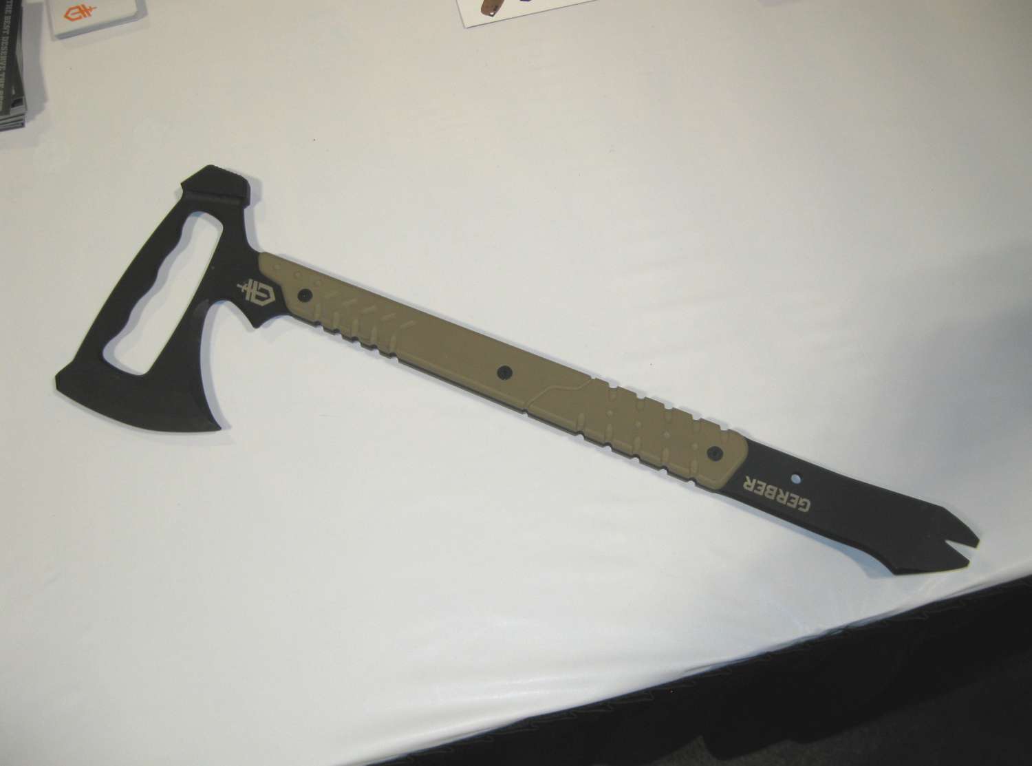

If I were to ever use a tomahawk camping it would be the Gerber Downrange:
Its pretty much the same as my axe, only slimmer, so whats the difference?

Yes, a sharp stick can do some of the same jobs as a spike hawk. In the Ozarks, plenty of them at hand. One of the enhancements of the spike hawk is that the spike is 90 degrees to the head. It's like trying to remove a nail with the claws of a hammer, you hook the spike under what you need moved, and roll the tool toward the bit. That works better than trying to remove a nail with a straight bar. Check the pic of the Gerber, even it has a curved foot to take advantage of it.
On the other hand, the open handle is lightened, and that big hole doesn't scoop so well. It's designed for deconstruction in urban situations, not field craft. Like having a double bit axe, it has some specialization that restricts other uses. Yes, the spike hawk, especially those cut from flat stock, isn't as heavy as the traditional polled handle axe or hatchet. That is the tradeoff - you sacrifice weight, add speed, and it still will chop. No, it won't chop down a mature tree well, but then most of the time, I'd use a Stihl FarmBoss for that. Not going to pack that in, tho.

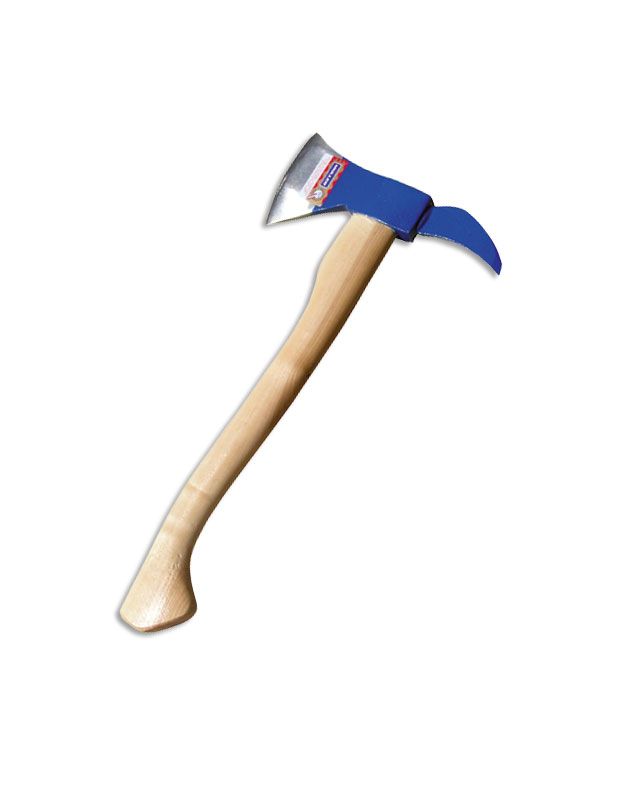

I've been using one of these for years:
I've never used it while camping, but it might be useful there too.
I heat my house exclusively with wood, so I am in the woods a fair bit during the winter season cutting firewood. This "Felbacher Handsappie" is extremely useful when delimbing smaller wood and picking up logs.
It's a tool, not a weapon - but one should be careful using it nonetheless.
