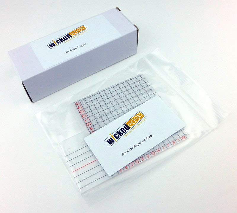

Unpacking the low angle adapter.

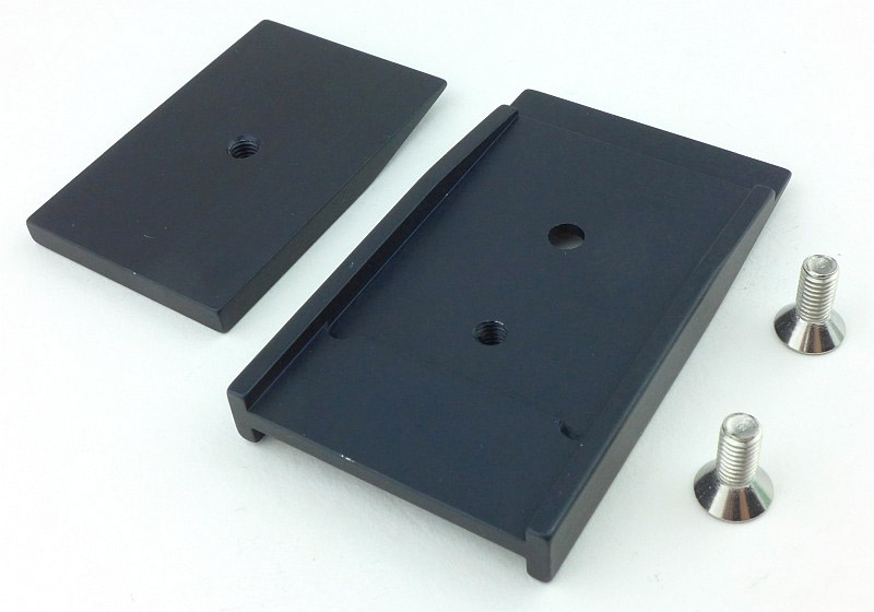

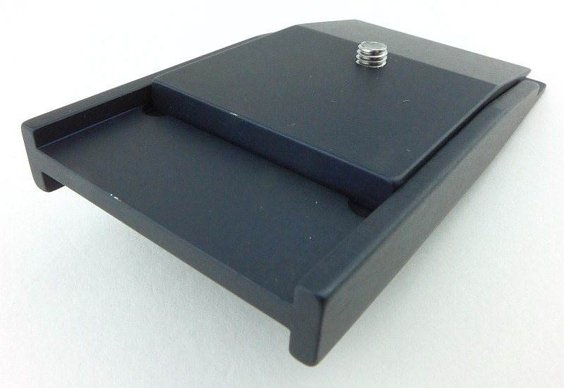

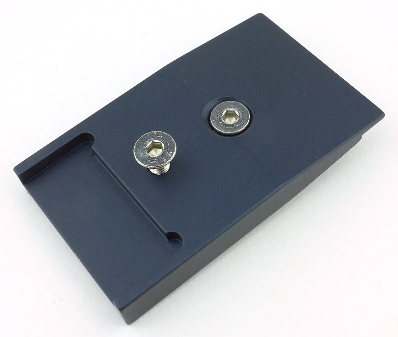

The main body of this clamp extension is black anodised aluminium.
An area is milled out of the adapter for the sharpener's standard clamp jaws to slide into and grip.
The other side has a different profile as there is the adapters blade clamp plate.

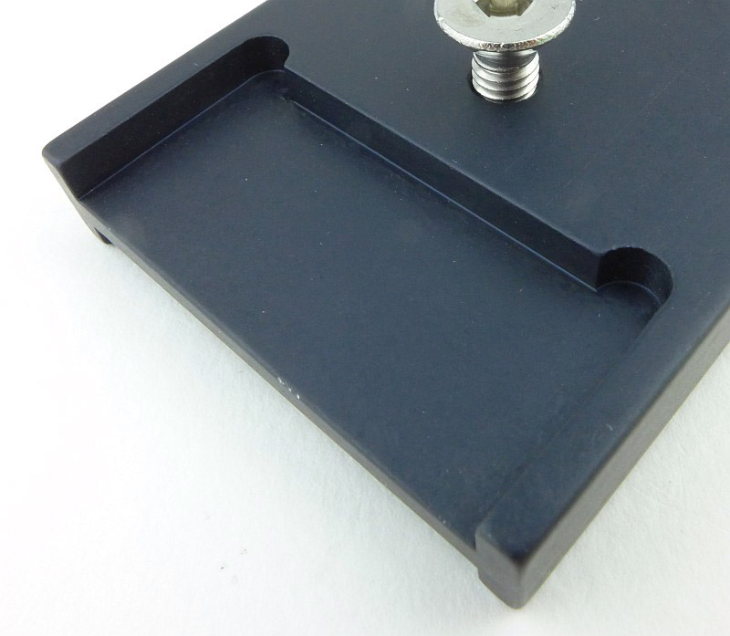

Taking this blade clamp completely off shows the milled pocket into which it sits. The milled out areas on each side (for the sharpener's clamp and the adapter's blade clamp) ensure precise alignment of all parts of the adapter during use.

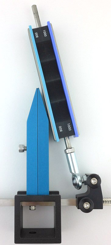

To clearly illustrate what this low angle adapter does, here is the standard clamp of the Wicked Edge, and at the low angle set for the stone, the stone is hitting the clamp jaw, so won't reach the knife edge (unless the knife is very deep).

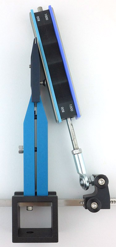

With the guide rod at the same angle, fitting the low angle adapter allows the stone to completely clear the main clamp and work on a knife blade fitted into the adapter.
All standard angles are still available even with the low angle adapter, but remember the scale on the main clamp will now not be exactly correct as the height of the blade has changed. Make sure you note down the fact the that adapter was used along with the angle shown on the scale for the guide rod.

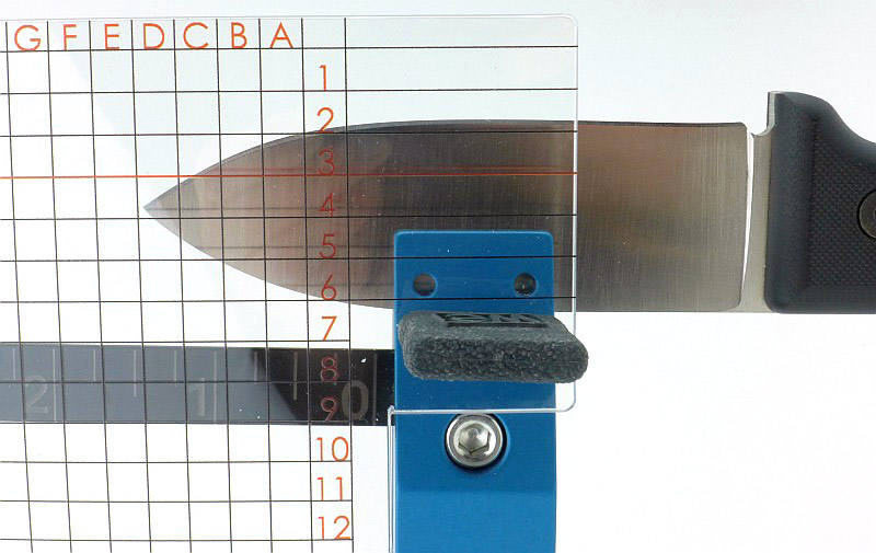

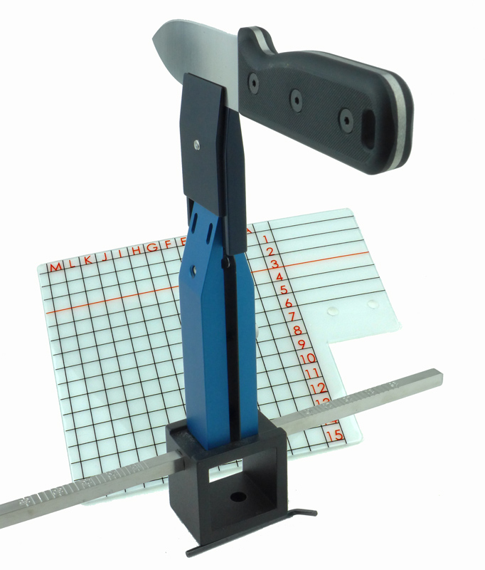

With the Wicked Edge system you note down the various settings used for each blade so that in subsequent sharpening sessions you can repeat the angles precisely, reducing the amount of metal removed. The Advanced Alignment Guide gives you a further level of precision for the positioning of the blade in the clamp, and allows you to angle the blade and record the exact position you used.

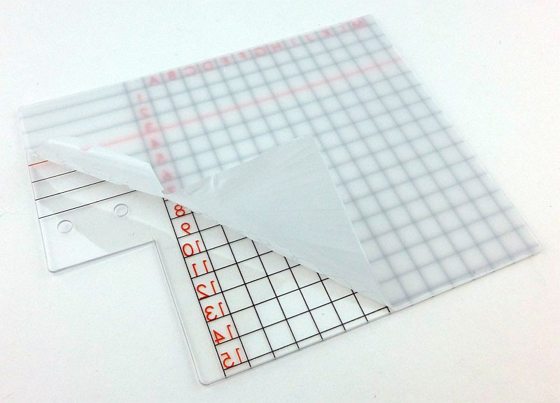

When it arrives, the guide has a protective film to ensure you get it completely free of marks.

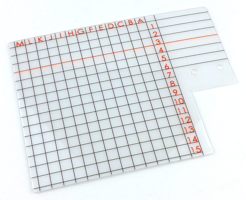

With the protective film removed you can see the grid printed onto the guide and two holes which are used to fit the guide to your sharpener.
Before this alignment guide was made, you had to use the simple ruler scale built into the clamp to position the blade, relying on the blade spine to sit squarely onto the depth key.
To use the new guide, when you fit the two pronged depth key into the clamp, first pass the prongs through the holes in the alignment guide and then into the clamp. Now you have a 2D labelled grid which allows you to precisely position and record where the blade tip is set. This also means you no longer have to put the blade spine down onto both depth key prongs and can rock it one way or the other to better present the knife edge for sharpening. Another level of precision.

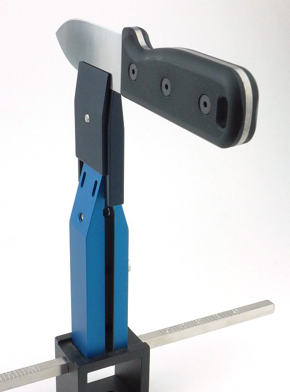

I see quite a gap at the tips of the jaws. Most of the clamping effect is way lower down next to the part of the clamp that contacts the spine (at lest for this full bevel knife shown). I don't know . . . seems like they could go a bit further with this design. For instance something along the lines of this clamp which allows for angling the jaws to conform to the surface clamped.
I would kind of get into a WE but they are just not there yet for my uses which DO include very shallow angle edge bevels and thin knives. For now it is still Edge Pro all day for me especially considering the price plus this and that and the other thing.

the more I look at the WE clamp . . . it looks like it could actually function the way the Jorgensen clamp I posted does but it isn't adjusted right.
Any chance of giving another go and posting a new photo ?

Both the main clamp (of the field and sport) and the low angle adapter , have one 'fixed' side, so although it is possible to set the other clamp jaw at a slight angle by keeping the jaw slightly loose and then tightening the clamping screw more, this creates two problems:
For the main clamp, there is no spine support, so the blade can then work its way downwards during sharpening if the jaws are set at an angle (the low angle adapter does have a support shelf).
For both clamps, the blade would then be held with one primary bevel perfectly vertical and the other taking up the full inclusive angle of the primary grind. You would then need to set different angles for the guide rods on both sides or have an uneven edge bevel.
My approach to this has been to use a quality masking tape on the blade flats next to the spine. As you tighten the clamp, the tape gets cut by the pressure at the widest point (so the spine on a FFG) and the rest helps support the blade. This has the added advantage of minimising risk of marking the blade with the clamp and any diamond particles that might have fallen onto it during use.
