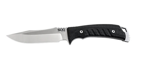

Will it snap under my weight?
May 23, 2021
72
This knife, is a very nice knife. It's made from CPM S35VN steel. From my research, this steel is a well rounded steel, that doesn't particularly fail in any one area. That said, it doesn't excel in any one area either.. But that's okay.
If I was sliding down a hill, or an embankment of some sort, and I pulled this knife out and stabbed it into the ground, would it hold me without breaking? Or would I fall to my death? I weigh 300lbs, thank you

Remember you sliding isn't like you hanging vertically (cold steel proof style). The only way to test it is to maybe set it up vertically and pull maybe half your weight through it and if it holds that I would say your good to go.... having to rely on a knife for that would be a pant sh@$er of a day out!

I belive that your SOG Pillar,a full tang knife, will hold. But the embankment soil that you stuck your knife into will fail. Dirt generally tends to be weaker than any steel. So the knife breaking should not be your main concern.
If you really want to test the knife itself, hammer it into a tree and stand on it.

4mm. thick hardened steel is no joke .Even 4mm mild steel can handle pretty much weight .But when we talk about knife it is not that simple . knives have bevels and how high they are make difference .Anyway , first and most important is where is leverage .If half inch of tip of knife is stabbed in a tree and you apply weight on butt is one thing .If whole blade is in the ground or wood and you hold handle with hand is other thing
Edit . Of course all depend how the weight is applied .One thing is on spine other thing is side load
