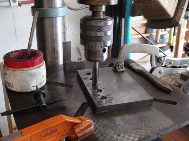

Press base starting to take shape.

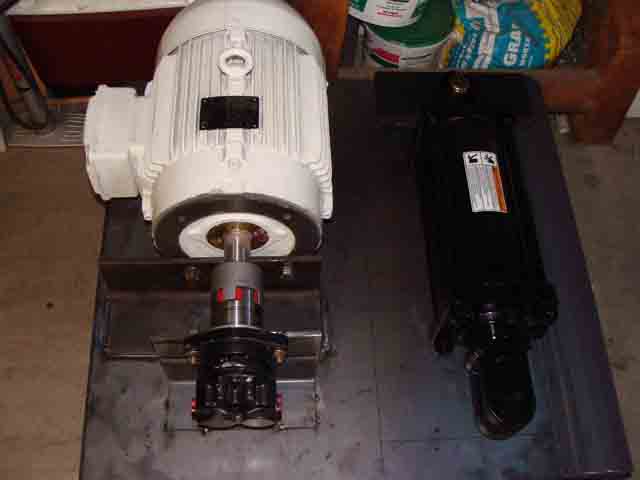

Mount for 7.5HP motor complete. Fabricating mount for pump.
Motor mount and pump mount complete.

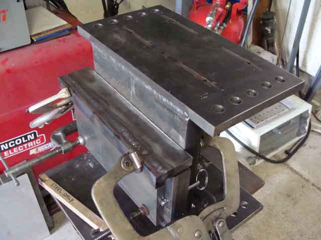

Hydraulic tank mounted and top of base complete. Now to build the H frame.

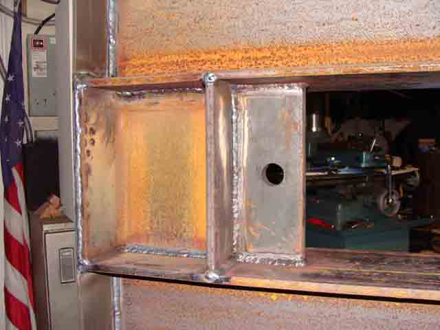

Pictures of beams prior to welding.
Starting to tack weld top frame components.
