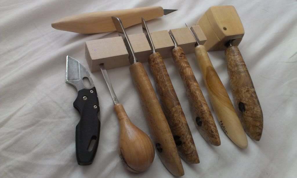

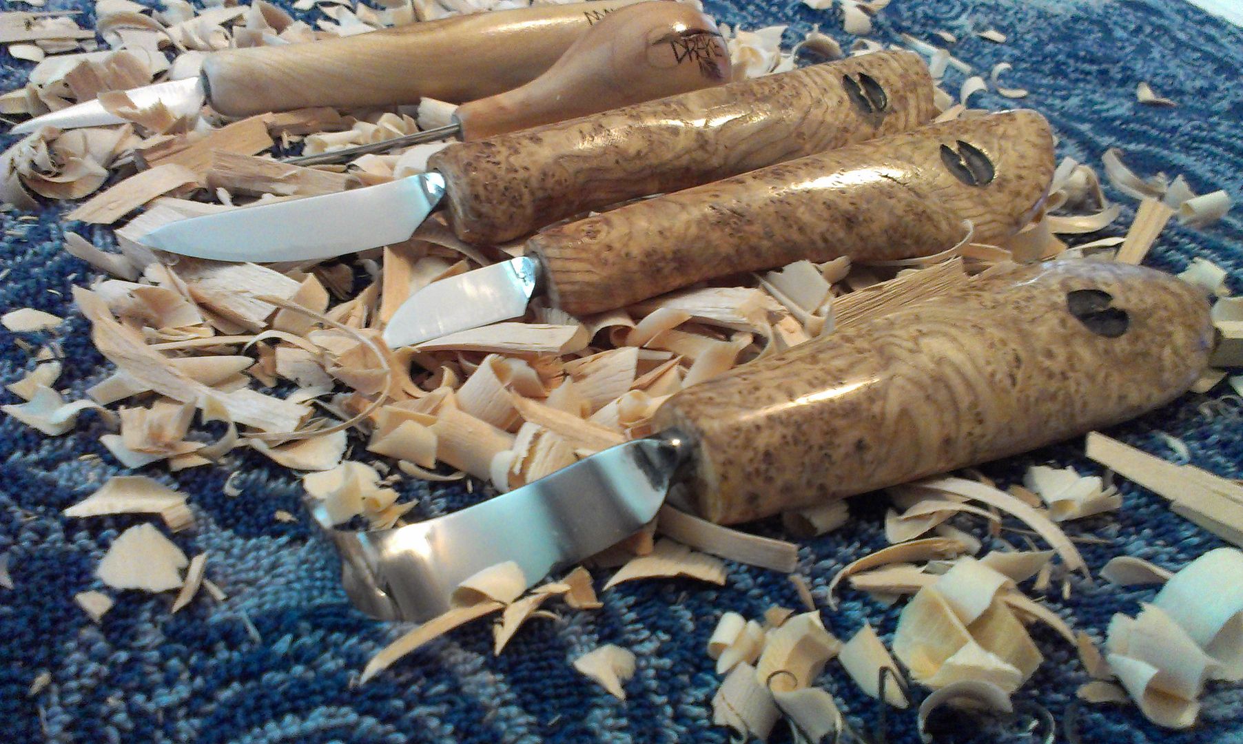

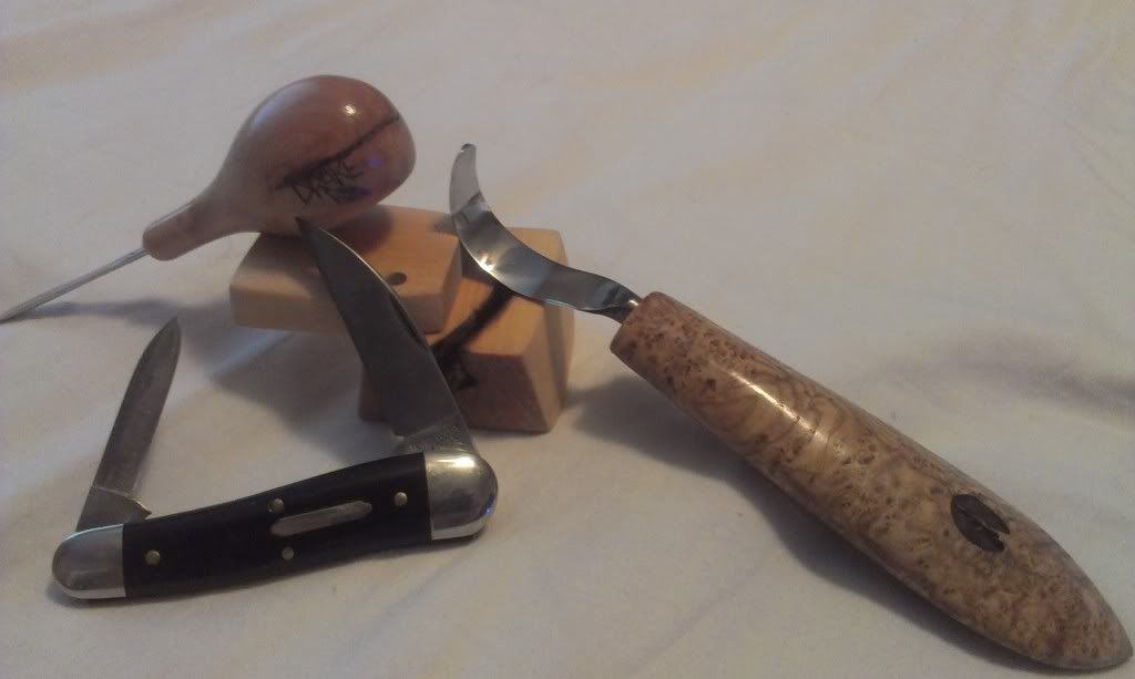

These are a few of my carvers. 1095 from Deepwoods Ventures.
How to properly (imo) set up an Opinel.

Another group

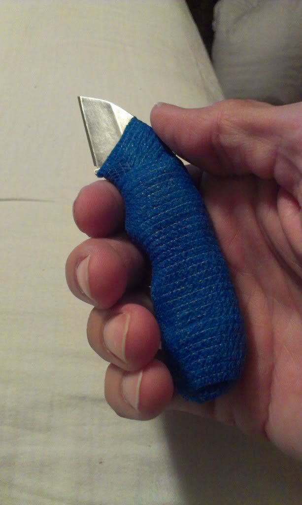

And how I set up a mini tuff reprofiled to a more acute edge than the already excellent geometry from CS.
Mods done were with helpful ideas from my friends here. ;)
Hope you don't mind all the pics. :)

Thanks shane-o-ca and Strigamort - your customized knives look great. I especially like the curved knife blade holder! Smart.
