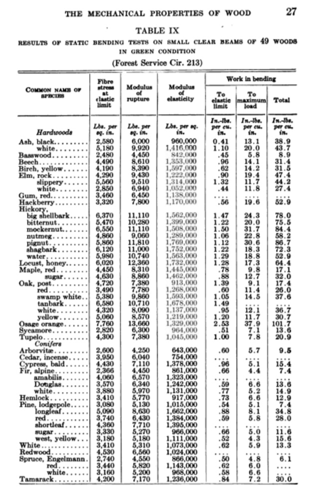

I am new to axe restorations and picked up two old heads for $2. and I am wondering what wood I should use for a handle, But I have no access to Hickory in my area.

Plus if you go out in the woods and cut a tree down you'll have to buck it, split it, make a blank and wait a year anyway before its seasoned.
Interesting! Pray tell, what kind of wood was he using?Seasoning isn't as important as people think, at least not for a simple user handle. Forum member G-Pig used to regularly make axe handles from green wood and they held up well enough for him. Perhaps leave the wedge a little long so it can be driven even deeper for a couple months.
The biggest problem with hanging on green wood is warpage. You can't predict how a piece will dry.
Ive never had Ash warp, nor have I had Birch warp, despite carving both green. Sugar Maple will warp very readily, but I keep the handles hung and out of the sun, and those ones will not warp. I wouldn't worry too much about warping, especially since these are for all intents and purposes, "dry" at least compared to a green tree.
I read the post. Sounds like g-pig has a method that works for him! But i must respectfully disagree. But only with the drying and oiling part. From my experience it's not worth my time to do something twice. And while i do agree that ash does shrink more that hard maple, maple shrinks too! Everything shrinks once dry, it only stands to reason. And I'm aware that oil from your hands does leach into the wood but, if you're like me and have 4 or 5 dozen axes(at least) you can't swing em all! So i oil em with blo. The other info in his post was spot on though and i appreciate him taking the time to make it and share. The only reason i mention this at all is because i don't want newcomers(like the op of this thread) to put their all into a green haft and be disappointed in a week or two once it comes loose. Its discouraging and has happened to me! Just my two cents.G-pig wrote in another thread, "Ive never had Ash warp, nor have I had Birch warp, despite carving both green. Sugar Maple will warp very readily, but I keep the handles hung and out of the sun..."

I probably wouldn't torch it, it could cause checking by drying it out too fast. There shouldn't be any problems as long as you dry it slowly.
I did just find this quote from G-pig in that thread that i missed when reading it last time. It appears that he was recommending drying them before hanging?
