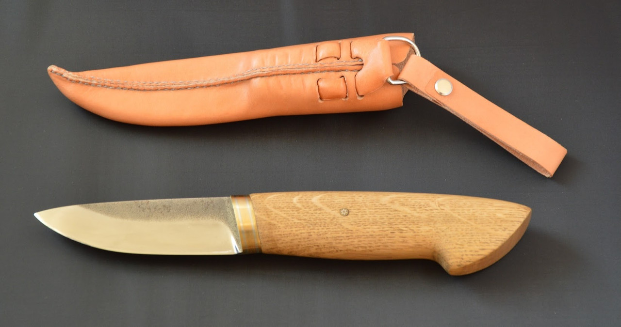

That's a nice piece. I think oak is under-rated for knife handles.

I've heared stripes like that in oak been referred to as tiger stripe oak.
Is that correct/common or just somebody with a lot of imagination?
Oak has large pores. You can take the time to fill the pores, it gives a beautiful result.
You can get sanding sealer for that, but since a knife handle is small, just the oil you use as a finish will be enough
You are correct Bart, quarter sawn oak is often refered to as tiger oak or tiger stripe oak.
Just a note, but to get the really nice quarter sawn look (with or without ammonia fuming), white oak works much better than red oak. All of the Craftsman style furniture is based off of white oak because the quarter sawn ray flecks are much more prominent and because it takes a nice brown color with ammonia fuming.

Two of the 8 chair set are broken(no one has any interest in having them repaired) and will be burned so it’s a use it or loose it situation.
Bart, nice knife, but if you want to make it really nice:
Get a plastic storage box (with a snap-tight lid) about the size of loaf of bread. Put a piece of wood in it to set the knife on. Set the knife blade on the block and put a weight (steel,brick,etc) on the blade so the handle is in the air. Put a sponge in the box under the handle ( not touching) and put 20-30 ml of ammonium hydroxide (ammonia) on the sponge. Close the box lid and set in a warm room for a day. The ammonia will "smoke"or "fume" the wood to a nice color and make the rays and flecks stand out. Check regularly, and when it is a tad darker than you want, remove, wipe off well, and finish sand. Apply whatever finish you like. Oil finished work best.
The brass will darken, but will brighten up in finish sanding.
I haven't done oak smoking in a long time. I was able to get the professional grade 20% ammonia. It is much more dangerous than household ammonia.Household ammonia will work, but takes longer.
Six chairs make a good set and leaves you lots of handle blocks.
Sooner or later every knife maker realises that most furniture is made out of knife handle blocks
I struggle with keeping pieces big enough for guitars. I have some quarter sawn white oak put aside for two guitars.
I won't smoke this knife but I'll keep that technique in mind for a future project.
