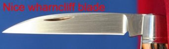

-Type of carving or whittling: different knives will do different things. A wharncliff blade is a great blade for overall work. An upswept blade can be extremely useful. It depends on what you want to carve. Most will find a wharncliff the best general use for most carving. But if you get into different things, then get different blades. Don't ask a hammer to do the work of your power-saw.

-Tips: The tips are the most vulnerable part of the knife. People tend to want to "twist" the knife to dig out an area. Remember that the tip is fragile on a wharncliff blade. To prevent tip breakage, keep the tool very very sharp and remember that a knife is a cutting tool, not a drill or a shovel. Cut the wood away and you will make your tips last longer
