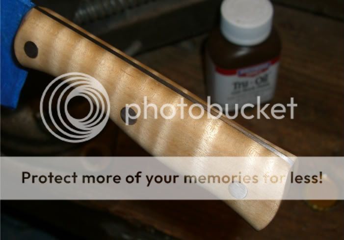

You will need:
1 spritz bottle of classic Armorall "Original protectant"
1 bottle of Birchwood Casey TruOil
2 "dixie" mouth rinse cups
A 3m Scotchbrite pad
0000 Steel Wool IF you choose to do a satin Finish.
Nitrile Gloves--these chemicals are safe to work barehanded and known others in the past to prefer using bare hands to track the finishing process, but there's a reason I'll explain later.
Prep:
Hand sand to your your handle material to the final desired grit--I've finished handles from 600 up to 2K and not seen a difference in absorption--before wiping clean with a damp cloth and letting air dry.
This will provide a very slick finish to even G10, for "tactical" texturing on G10 prior to applying Woodstock's elixir, I'll either lightly rasp or bead blast and necessitate this wipe down step even more. While this mix won't stain materials, trapped filth will muddle the color on liners or make glue lines stand out in stark contrast.
Note:
If working with wood, a quick swipe with 4-0 steel wool will help to raise hairs after clean off. Typically I'd use a bit of steam to wick fibers, but moisture will prolong the time needed for coats.
Put on your gloves and Let's begin:
The essential here in this process is to go lightly with your mixture ratios--too much Armorall or TruOil only slows the drying time.
Until you get used to eyeballing equal parts, a couple mouth rinse cups will help to keep the two separated and allow for recovering excess, which is why I have included them here.
Dab two finger tips worth of armorall onto your handle, you'll only want just enough to wet the surface.
A dab's worth of Truoil on another finger tip can now be rubbed onto the surface, it'll only take a minute or two before the reaction starts.
Neither endo or exothermic, there is no temperature shift during the reaction, but the slick mix will suddenly get a bit thicker.
This process seems to be encouraged purely by the rubbing action, trying to speed it along by using warm air from a hair dryer or similar doesn't work.
You will rub this compound in for the entire 15 minutes.
As you rub, the now slightly thicker, pasty elixir will thin to a tacky residue--And this is why the gloves become important.
Excess will begin to gum up a bit, a slight "booger" film that will form on those wrinkles and edges of your hand, as well along the areas that don't absorb the solution such as exposed metal surfaces or liners.
The boogers can be wiped off using the 3M pad by lightly brushing--the point is to just snag and lift.
If working with bone, antler, or extremely porous wood, this stuff can be worked around the surface and pressed in to pores. When working stag handles, I generally fill the marrow pores with this resin.
Each coat, as mentioned in the introduction, should take about 15 minutes--you can check progress on the finish by tapping it against your skin, it will still have a slightly tacky surface at about 95%. When it begins to have the same feel as worn out tape, you can apply the next coat.
An excess of humidity or poor mix ratio will require longer working periods--so if you're in a damp, rainy environment, you may expect to have to rub a little longer. However, if you find yourself still rubbing after 30 minutes, you should just lightly wipe down with a paper towel before trying to apply a fresh coat.
For a satin finish, brush the surface between coats with your 0000 Steel wool.
When working natural woods, I would use up to 30 coats--I've yet to have a situation call for even that many when using synthetics. However, there is no set figure on coats yet. As a novice, I do not feel like a fair judge in making a call there--when I and others who try this can collaborate on findings, maybe I'll eventually suggest fixed numbers.
