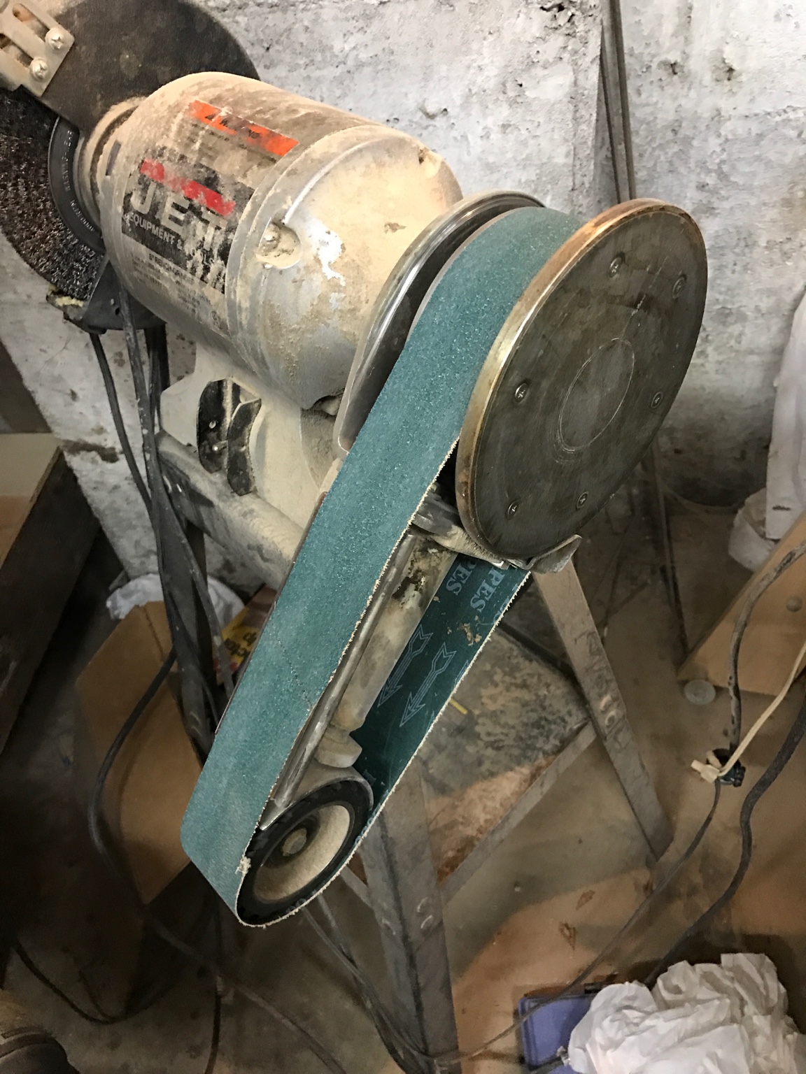

I have not ground steel in years but I will take a picture or two. I used a jet 6x48 belt sander for 8 hours at a stretch but I was grinding a single bevel on plane blades.

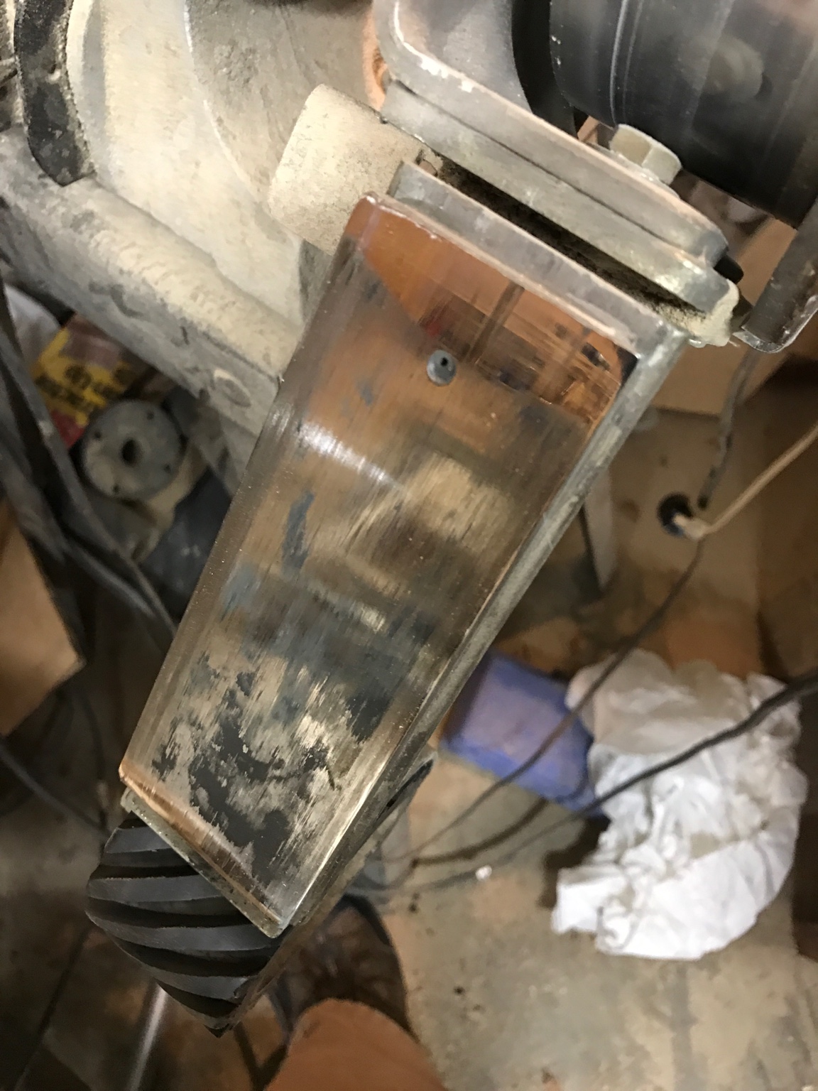

I ended up putting a o-1 hardened steel plate under the belt and I still wore it a fair amount. This is a high speed grinder so you have to watch the heat but it is fast.

Yes I was surprised at the cost when I looked it up. Now they have longer ones I see. But it makes a grinder useful now. For the price it can really rip off the steel but it takes practice to not heat it up since it is 3400 rpms on a short belt. The hardest part of any sander is getting a flat patten under the belt so you can get a flat grind.
I was using g10 under it but it wore too fast so I used a plate of 0-1 about rc 58. You can still see the wear on it though it took a few years

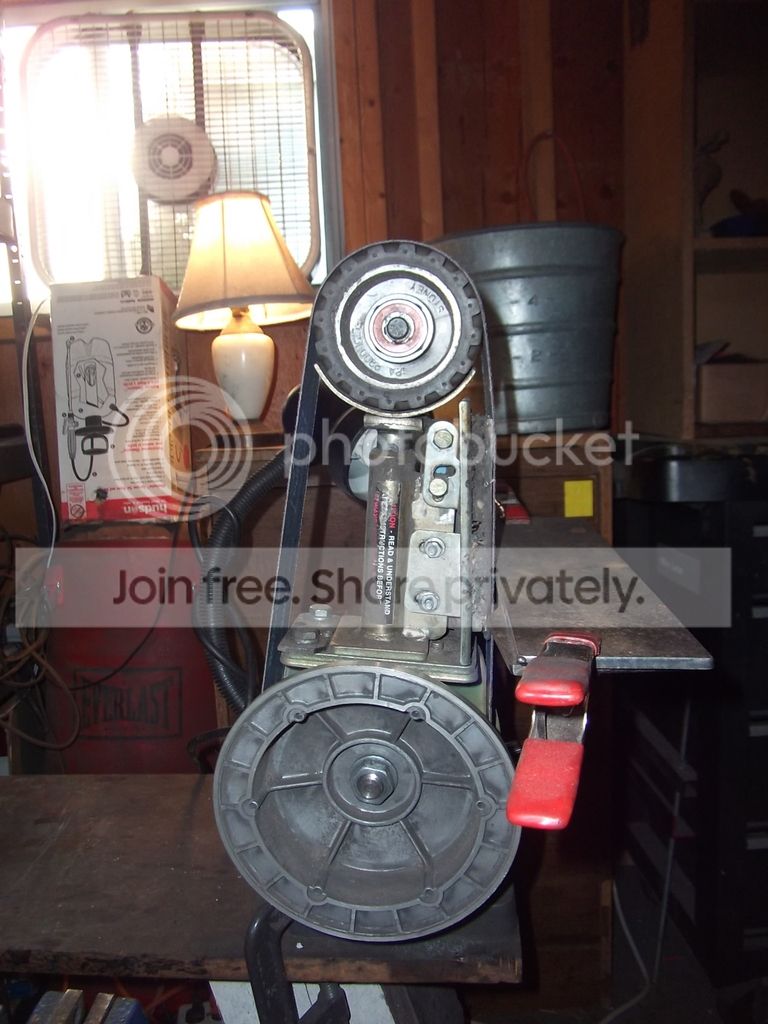

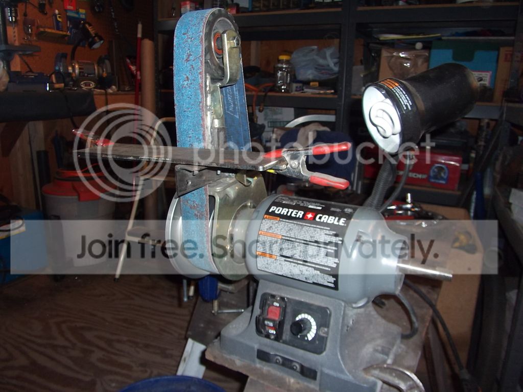

Steve, I used to use the same thing, the 2x36" "Multitool belt grinder attachment". You can find them on ebay for about $200 for just the belt attachment itself without the bench grinder included. I actually purchased a brand new "variable speed" (from like 2000-3000-ish RPM) Porter Cable bench grinder. I figured I could have my own variable speed belt grinder for around $400 plus. :rolleyes: I would never have gone this route knowing what I know now.
I actually attached my belt attachment to the left side of my bench grinder (which is opposite of the way it's supposed to be, which is on the right side), that way I could have the belt attachment vertical with the belt running downward on the platen side, as opposed downward in the slack belt side when you rotate it, just like a typical belt grinder using a platen attachment. I jerry rigged a little work rest on mine so I could use it for more controlled blade profiling and use my sled type bevel jig to grind the bevels as well. I also welded on a piece of hardened O1 tool steel on top of the platen it came with, before I knew about the JB weld "trick" LOL
Anyway, I would not recommend going this route, unless you already have a good bench grinder that is at minimum 3/4 HP. although it is recommended to use a 1 HP. The Porter Cable I used is 3/4 HP though, because IIRC they didn't have any adjustable speed ones that were 1 HP, . I'm sure other guys have had good experiences with this belt attachment, but if the tracking is not in line when you get it, it can bemore a headache, at least for me it was. The way that the tracking actually works is by the entire shaft (which holds the platen and contact wheel) pivoting, causing the hole shaft and wheel to twist either the left of right, which causes everything to be at a bit of an angle. I personally happened to have pretty bad luck with mine, but like I said I'm sure other guys have been just fine with theirs.
I also don't like the way they designed it to release the tension in order to change belts, which you to by by pulling (stretching) the belt out (or in) using quite a bit of pressure until the spring locks down. You can see videos of how it all works by finding the listing of it at www.Trick-Tools.com .. They do make it look pretty slick! ;)
Anyway, here are a couple of pics I have from a number of years ago...
~Paul
