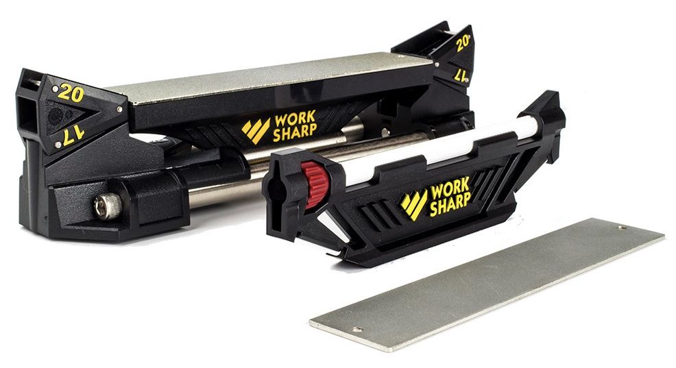

Just so everyone's on the same page... pretty sure the OP is talking about this...
Sharpens any steel, from Elmax to S90v with ease.
Can repair edges, reprofile, hone or strop.
Under $100.
Portable.
Can be used without base for field and tool sharpening.
It's an awesome system.
