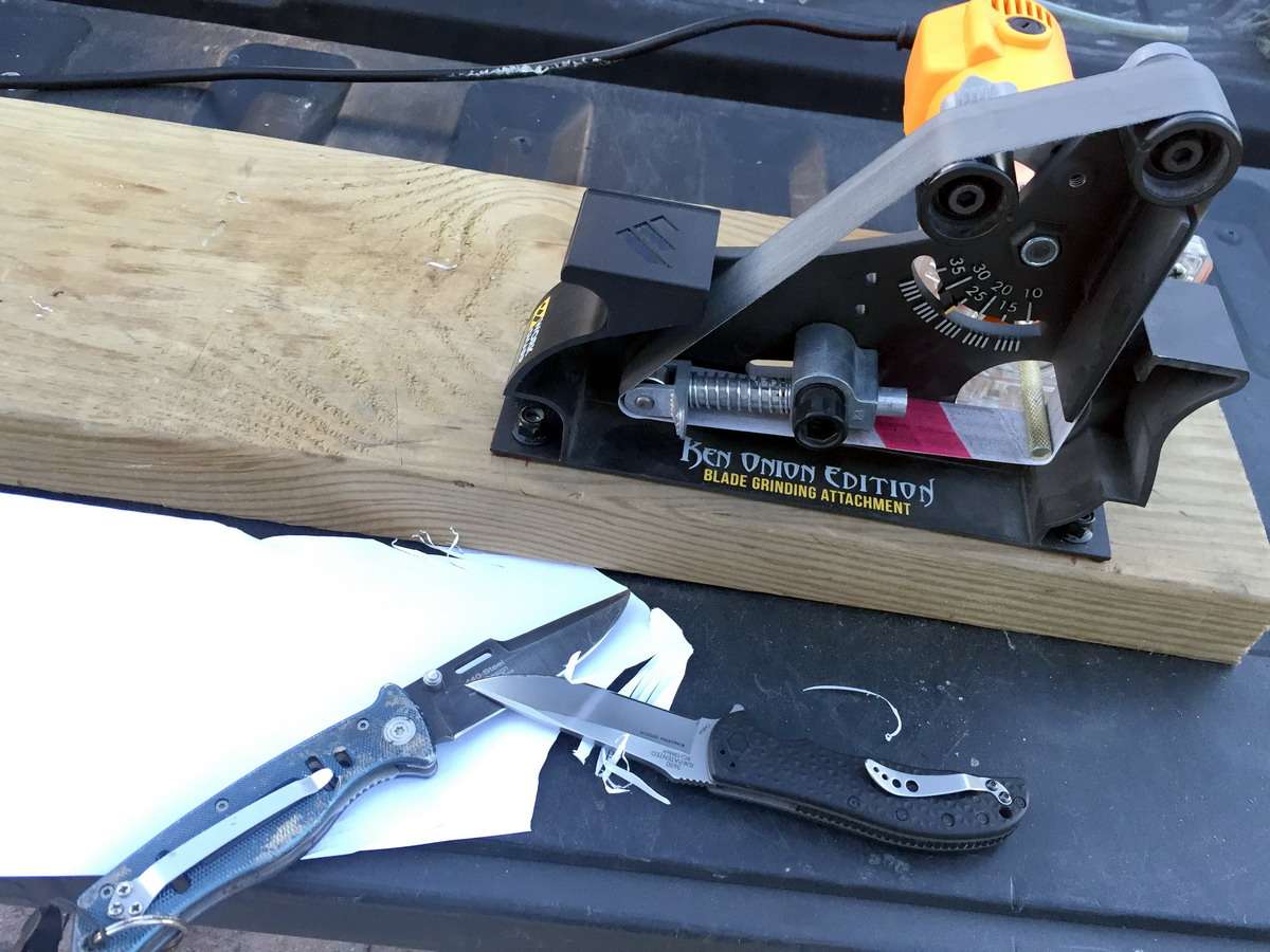

I would also suggest KO edition, with this particular attachment, pictured here, used by the Benchmade guys in the this year's SHOT Show :
You can Google the attachment, they surfaced in the last few months and are all over Amazon and eBay.
It's called "Blade Grinding Attachment" for the KO tool. I got one for close to $80 or so, initially used it with a router but I'm purchasing the real thing this week because the RPMs on the router are too high and also the shaft isn't the one that it should be...
The attachment comes with 5 belts, there are kits with additional belts, cost you about $14-$16. I was primarily using the last two finest grits, the stropping-one is 12 000 grit if I remember right.
Here are some old, phone pictures from my attachment. Those are some inexpensive knifes for testing, a Chinese knock off of Tops knife and some RJ Martin Kershaw for testing the belts,
the edges look funky but in fact they are mirror like polished and very uniform, just the light falls in such way that they look like they have few angles on the bevel.
Hope this would help, keep us posted please, I'm curious to see how you find it.
IMHO: I would still use a fixed angle sharpener for my "good" knifes, but for fast fixing of a worn blade and for stropping this is great.
It works just fine with my working blades that are inexpensive and I'm using almost every day on cardboard, plastic and wood.
Little bit more on the expensive site but if you like to play with blades and reshape or do some projects, this will do it.
