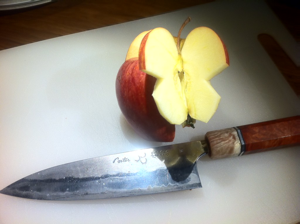

A lot uses the musk ox as ferrules as seen on this Carter :
Remember to "stabilze" the horn along the way as you work on it. Bill Burke is one of the best regarding musk ox handles imo :)
