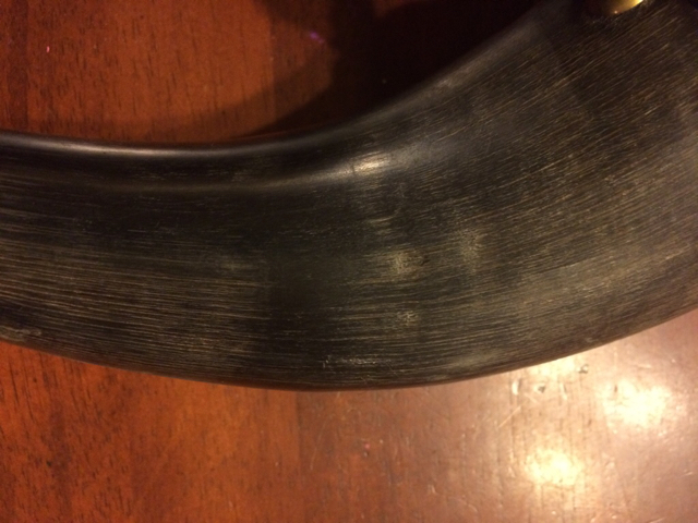

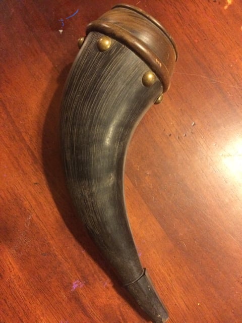

So I have made a lot of powder horns from cow and bison for fur trade trade reenactors and ongoing issue with this material is it ages and almost splinters on the surface. If you look at the raw texture that runs length wise that is what I am referring to. You have to work deep past that surface and then seal well or with time and moisture it will be back. It does not behave the same as cow or water buffalo horn that is much thicker and doesn't seem to end with the same surface texture issues. I'll post a pic tonight of a horn that was glossy black and waxed heavily and the texture came back. Chris

Here is that horn I was talking about. If you notice the end where I carved is still shiny and smooth where the main body has the lines and texture like the raw horn hope this helps Chris .
