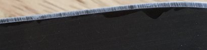

Below is an example where I do not think the apex or bevel near edge was overheated. The black sharpie can be seen as striations on a Buck Marksman Inferno with s35vn. The black that is still present from honing, shoulder to edge, disappearing at edge deferentially, gives an indication of the steels topography, the blades symmetrical grind and the careful force I used.
Already mentioned in the review above: lowest speed and 40° inclusive, using 4 and 2µ belts, I carefully gently and slowly drew the blade along the guide fence. The blade was made impressively sharp quickly.
I was going to quote both Larrin from knifesteelnerds and some of the makers here at BF, but that’s overkill. I will mention that Larrin, in his careful examination of the question “Does Sharpening with a Grinder Ruin Your Edge?”, chose to use a tap to graphically represent overheating, others reference steel color as a temperature guide does not generally apply with the apex overheating. Of course water cools, so misting or bathing are often mentioned.
