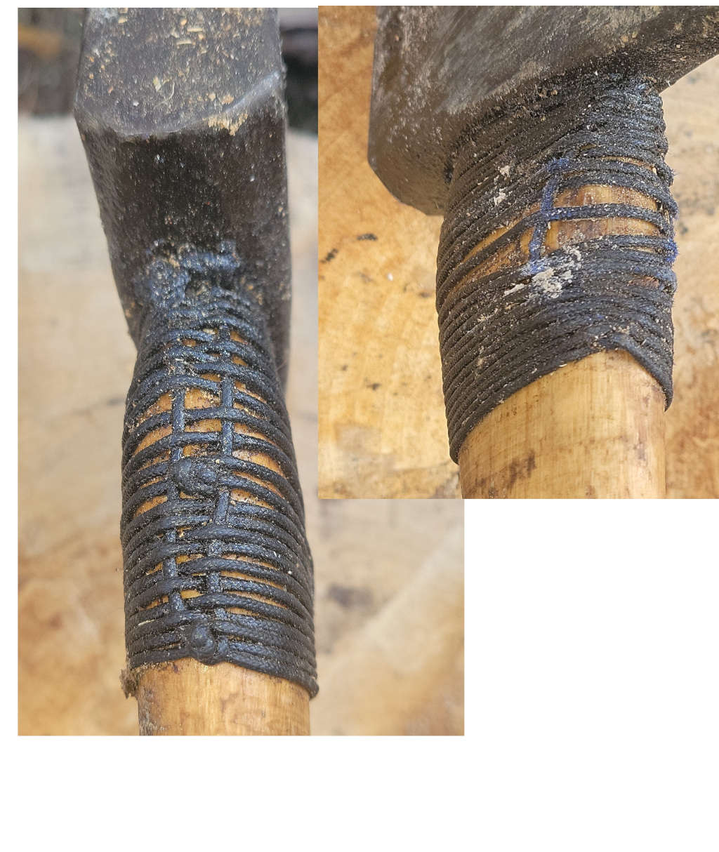

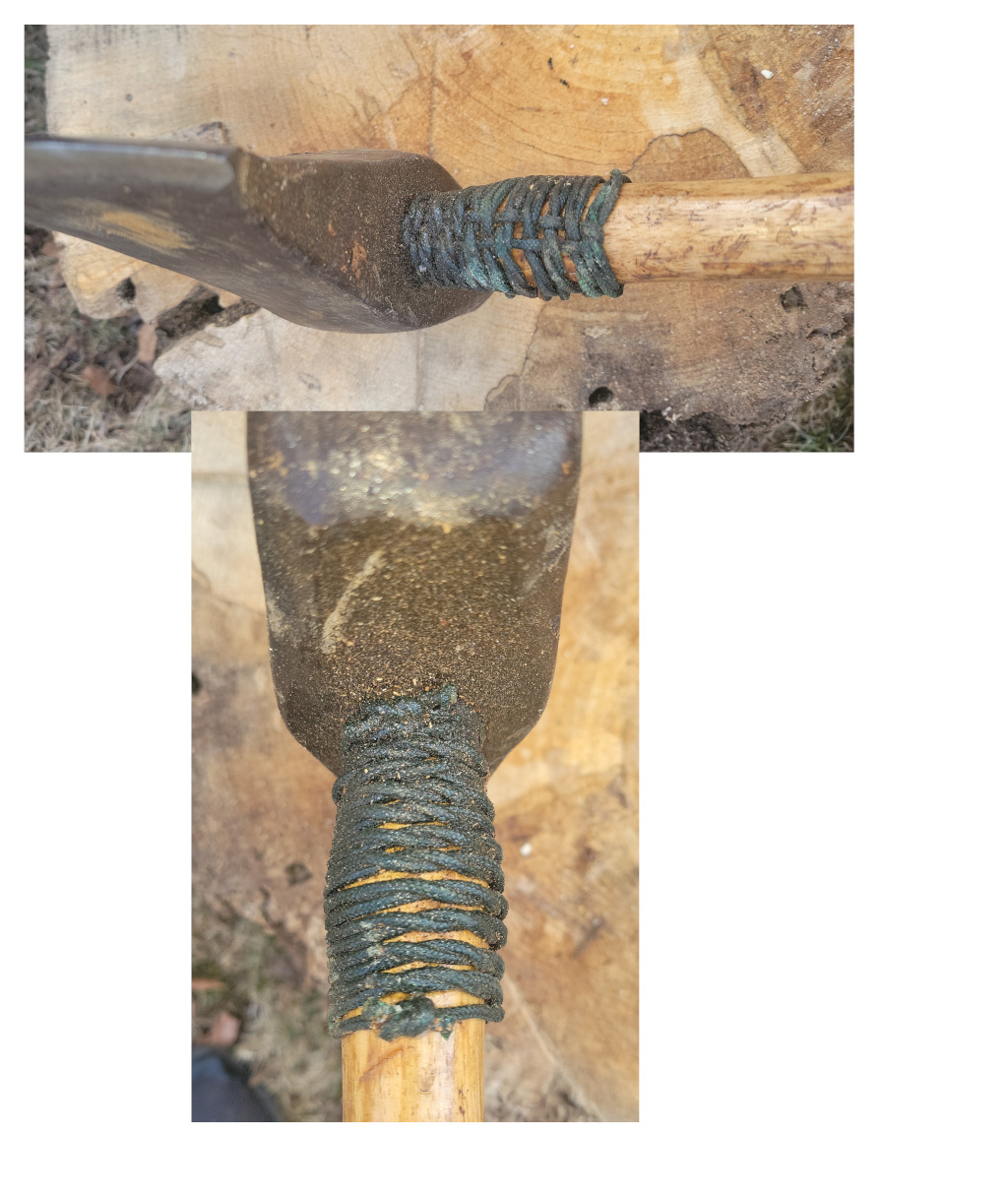

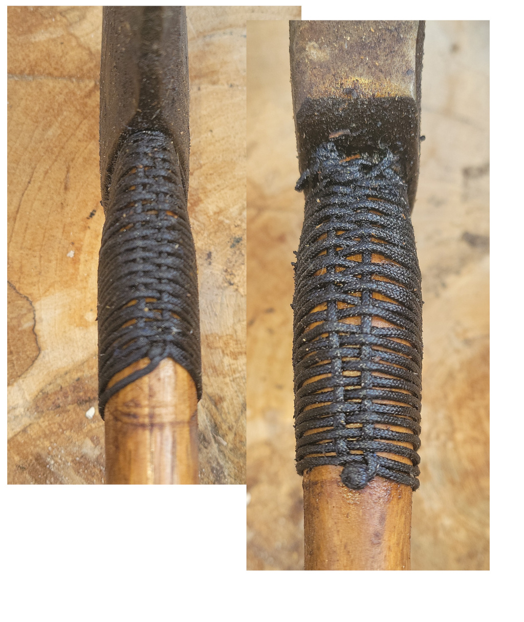

I refer to those as "karate chops" -- where the split makes a little crossways ledge sticking out right in the way of the haft. I suspect that the extremely wide bit on Eastern European "all purpose" axes, with their VERY thick splitting geometry, was intended to help prevent this, though care would have to be taken to land the blows on the part supported by the eye because they're not very deep.The win with wrapping is to protect the haft when the split goes weird and leaves wood underneath or alongside which the haft strikes and/or scrapes against. Unless you're good enough that you never let the head of the axe go further further than the length of its bit past the edge of the wood. I've overstruck a few times where the bit wasn't significantly further into the round past the bark, but when it split the bark didn't, leaving a ring under for the haft to strike.
But shit happens, and I doubt you're as perfect as you think you are or claim to be.I don't have to wrap my axe handles because I am good enough at using the axe that I do the chopping and splitting with the steel part of the axe, not the wood part.
Or not splitting much wood. Power of numbers and all that. Any person doing much splitting and not putting wear on their handles is either going very slowly to meticulously get every swing perfect or just isn't splitting very often. Either way, not much work is getting done.But shit happens, and I doubt you're as perfect as you think you are or claim to be.
This is possible if you make it your practice to always strike the near side of the round. Your splitting block should be set out in the open where it's easy to move around the work as you go. And you should only work with axes and mauls that are adequately thick at the eye.I don't have to wrap my axe handles because I am good enough at using the axe that I do the chopping and splitting with the steel part of the axe, not the wood part.
Ironically, I find the much smaller axes that are put to less full power strikes more apt to warrant a protective wrap/guard at the handle junction.I don't have to wrap my axe handles because I am good enough at using the axe that I do the chopping and splitting with the steel part of the axe, not the wood part.
Even when striking the near side of the log, if you don't have a bit of edge extending off the side of the log at the striking point you can still get "karate chops". I've found it often happens on pine and spruce, of all things.This is possible if you make it your practice to always strike the near side of the round. Your splitting block should be set out in the open where it's easy to move around the work as you go. And you should only work with axes and mauls that are adequately thick at the eye.
