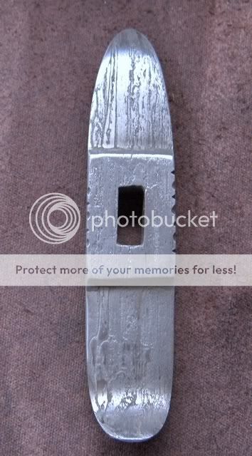

wrought iron is very resistant to rusting. i put a small chunk in feric cloride 2-1 and it took 24 hrs to start to see a pattern. i have a bunch of 1/2" wrought iron bar stock but my tresure is a very large chain hand forged by a blacksmith. ill post a picture

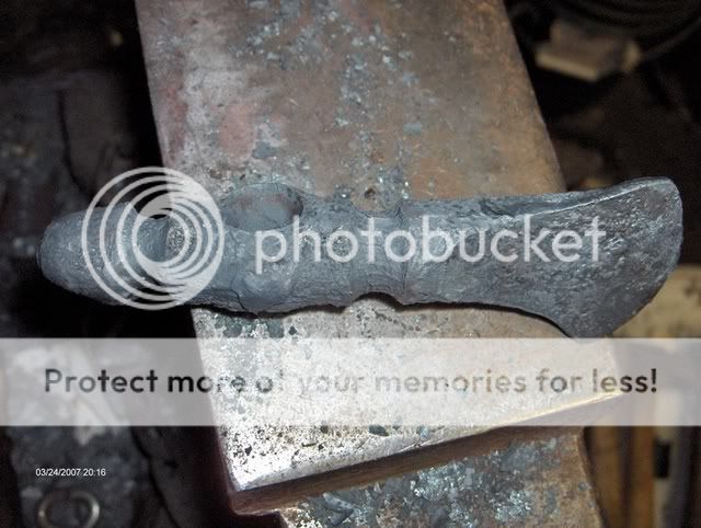

This pic shows the silica slag after it has cooled. At first glance it just looks like heat scale but it's not flaky. It looks more molten and when you chip off the larger pieces they will hold shape like a casting almost.
Even after all that slag was wrought out it still has a very defined pattern.
