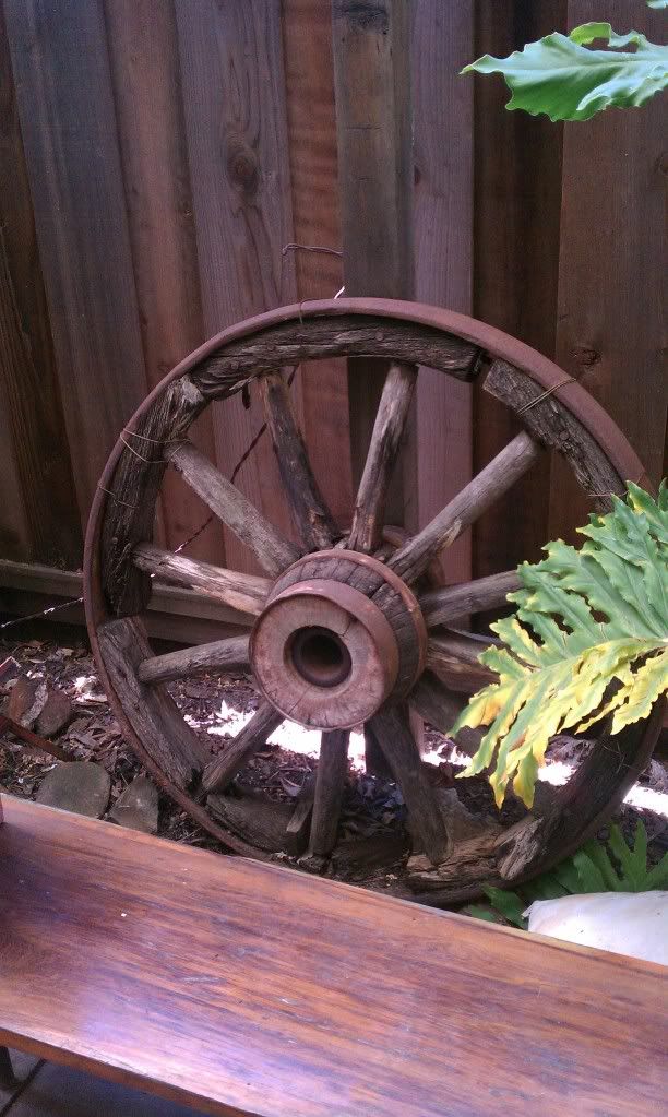

This was found by my Grandfather up in California Gold country. My Great Aunt has the matching one.
From a best guess would this be Wrought Iron?
You need higher forging temps than steel . The 'Grain ' caused by the inclusions which are strung out from forging . NYC still has lots of 100 + year old wrought iron water mains in service !!
