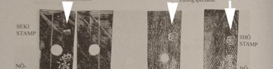

You are welcome. Generally speaking most people say not to oil the tang. However, in this case there was so much red rust that I would say yes oil it. That should prevent the rust from returning.
Look above the signature (towards tip) for any small stamp. Depending on how and where they were made non-traditional swords are struck with an arsenal stamp.
See attached photo of examples of Seki and Showa stamps.
I do apologize for the orientation. I wasn't sure how it was supposed to be. Thank you kindly for the information and advice. I will oil the tang and see if any additional marks become visible.
I oiled the tang and no additional marks showed up. I examined the tang completely with a jewelers loop. I also used chalk to get the markings to show up better and look for additional markings. Then I removed the chalk with a bit of gun oil and a cotton cloth. I attached the photos of the tang with the chalk and in the proper orientation.
