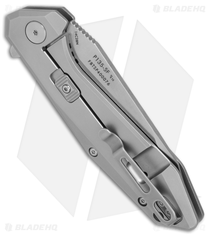

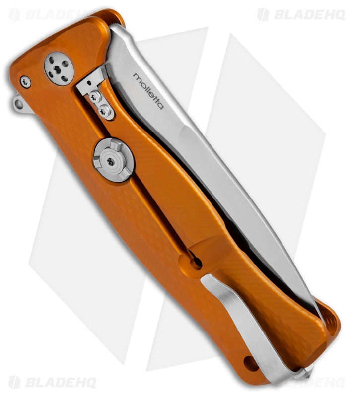

I wonder if something like the Ruike "Beta Lock" or the other rotatory locks for frame lock knives is a solution to the problem (again, for a problem that isn't a problem for me, but still shouldn't be a problem):
Of course, the counter-remark would be don't make something more complicated if you can't get it right the first time. I have both the Ruike and Lionsteel. The Ruike's "Beta Lock" is actually very well done...

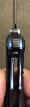

B6BDFBEA-D3CB-434F-979B-4C2BD6346917.jpeg This is a photo of the lockup or my 0393. You can see that the frame lock (which is already really thin) doesn’t fully contact the blade. So lockup is super early. The angle of the tang is very steep so it’s not going to change much. I took photos of the knife before I sent it off so I can compare it to when it gets back to see what they did. I’m just a noob but it seems pretty obvious why it fails. Poor lock geometry.

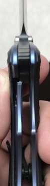

Update: I got the knife back from ZT 13 days after I dropped it off at the post office. Fantastic turn around imo. However, that’s the only good thing that I can say about the warranty work.
Paperwork says they replaced the lock bar insert. The lockbar now contacts less of the blade tang than it did before. It came back with lock rock AND it now fails a spine whack to my palm with one hit. Not a spine whack to wood or concrete. To the fleshy palm of my hand!
Before I sent it in it usually took a couple taps to my hand to fail. IMO they sent it back more unsafe than they got it.
For those who say their knives have lock rock because people are whacking them I present mine. Fresh back from ZT with a new lockbar insert and it has lock rock.
I honestly don’t know what to do. I’ll call em again tomorrow and talk to CS.
I’ve now sent this knife in twice. I effectively have a $240 Slipjoint at this point.
I’m done with ZTs forever. I’ve sold off my others. At this point all I want is a functional knife so I can cut my losses and sell it in good conscience. I couldn’t sell it now in good faith as is.
I’m kinda tempted to pay $30 for a blade replacement and hope that fixes it.
Maybe 10-15% lockup.
