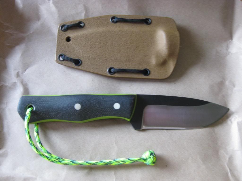

I have the honor of being a Beckerhead and get to help organize/coordinate/clean up and such for the BeckerWest Gathering. So I thought these are some blades that these Beckerheads would love to try. I PM'd Damon to see if he would send us a knife to play with at the Gathering. Here is what came in the mail...

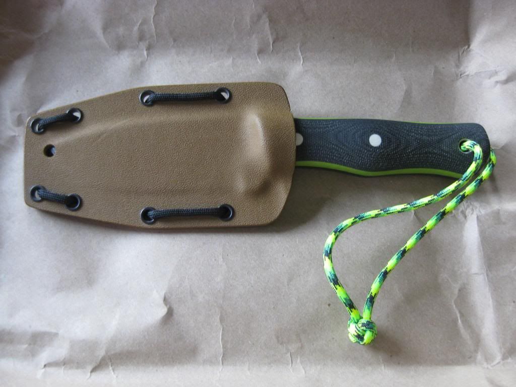

It came nicely wrapped in butcher paper with some toxic green tape, I thought toxic green tape?
Ok now I get it...
I have to admit that I have never been a fan of toxic green but this design and color combination changed my mind. It gives just the right amount of accent without being overdone.

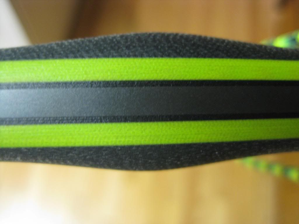

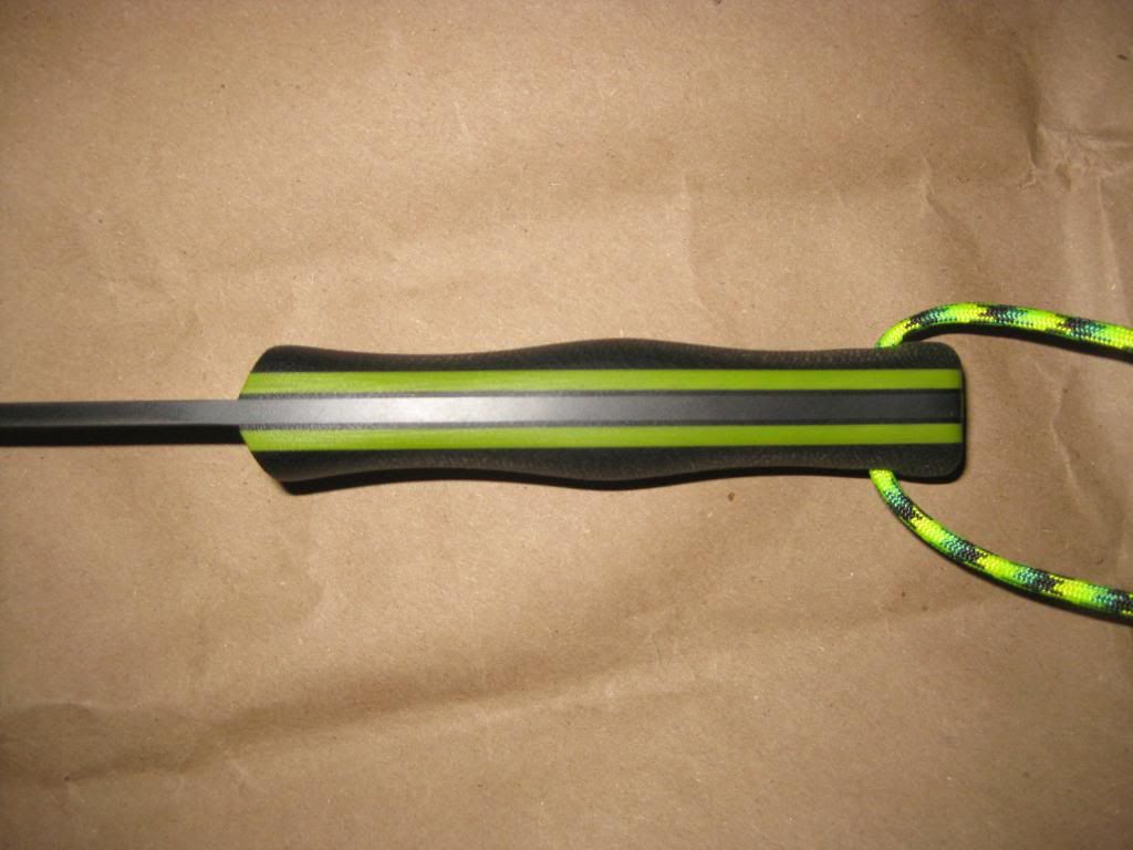

Handles: Contoured black micarta, over toxic green G10 liners with a black G10 pinstripe.

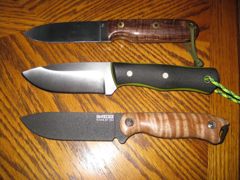

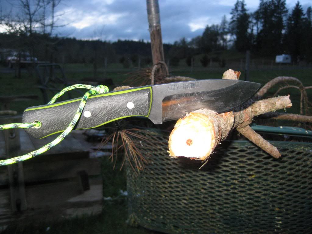

Here it is in between a couple of common bushcraft blades for size comparison, Blindhorse Bushcrafter and Becker Knife and Tool BK16.

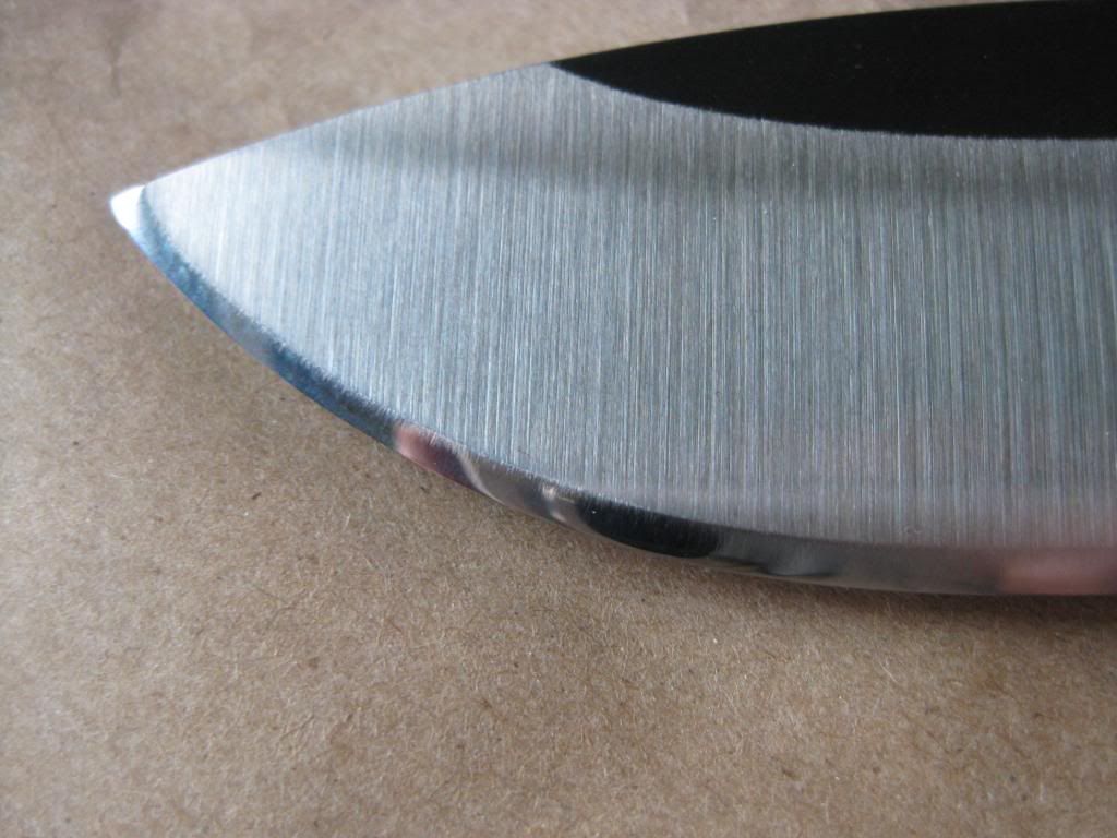

Right away the superior craftsmanship of this blade was more than evident. The contours of the handles, the grinds, the high convex polished edge all scream quality and customization. Not the kind of fit and finish you will find in any production knives on the market.

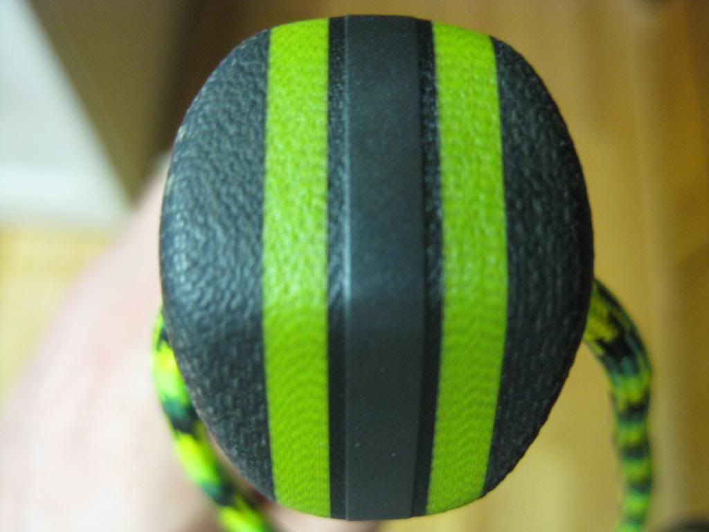

To me two things really stood out one is hard to tell from the pics but Damon has really perfected the sweet spot in his micarta handle texture. You always here that micarta is grippy even when wet etc. I have to tell you that it is hardly ever the case, I always have to either sand them down because they are too rough or rough them up because they are polished too much. These handles are in my opinion perfect in terms of finish.

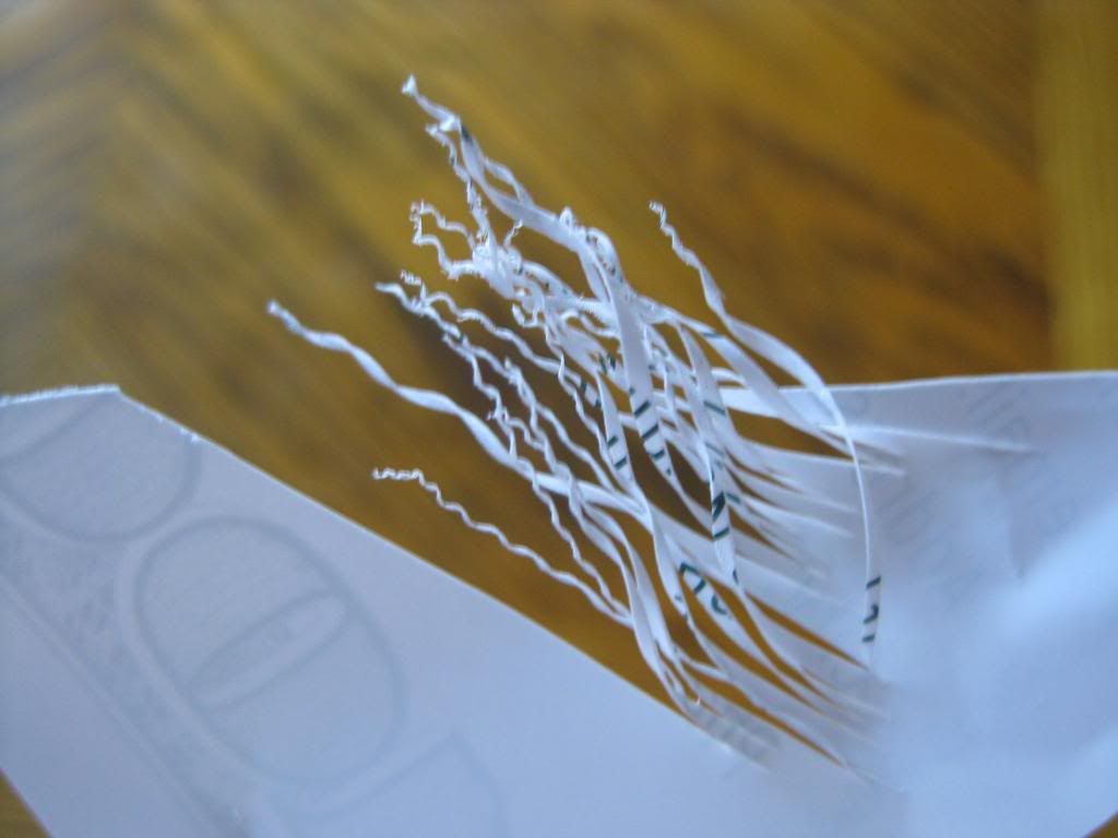

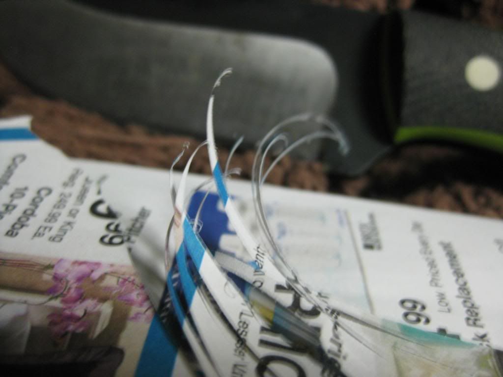

The other thing as many knife nuts know is every knife I have ever bought has immediately had to either be sharpened or touched up on the strop. Damon in my opinion puts the finest edge on a blade as I have ever experienced. His razor sharp, mirror polished, high convex edge is the best in the business and this blade was not specially done for this passaround. I have since had the pleasure of owning two more Alfa's and handled another and they all have this consistent flawless edge. Sharpest knife out of the box I've ever held...

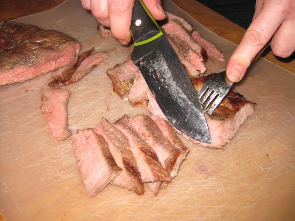

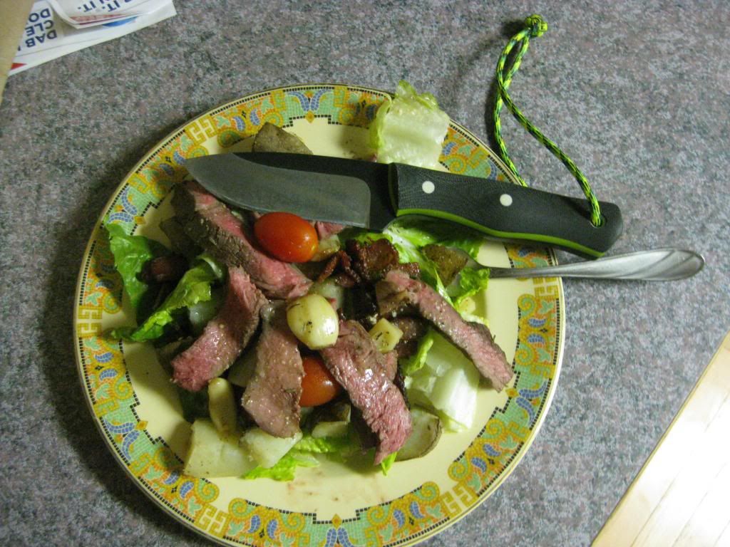

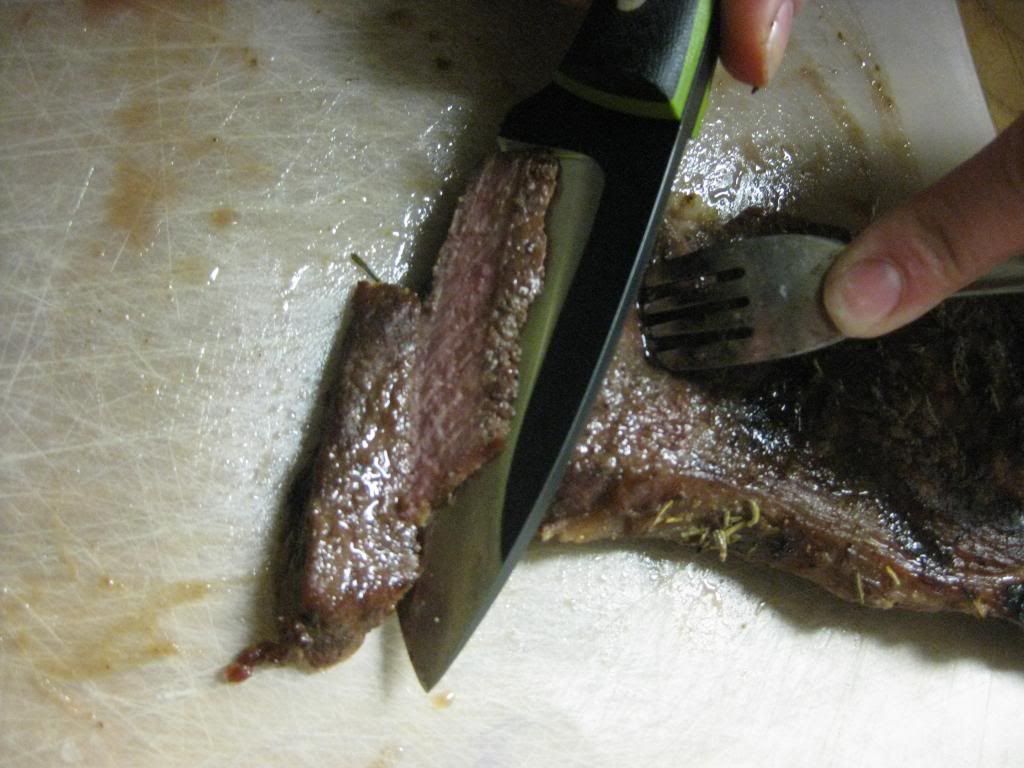

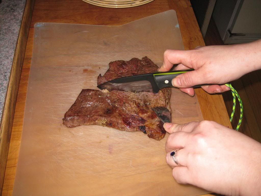

On to how the blade actually works. The first task after cutting paper...Dinner!!!
I was curious on how it would handle in the kitchen seeing 5/32" isn't the ideal kitchen knife thickness. I have to say it was right at home. The wife loved it and it performed well past her expectations.

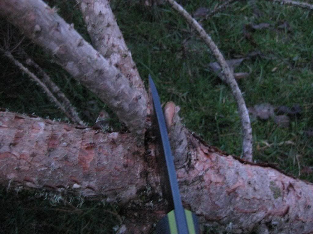

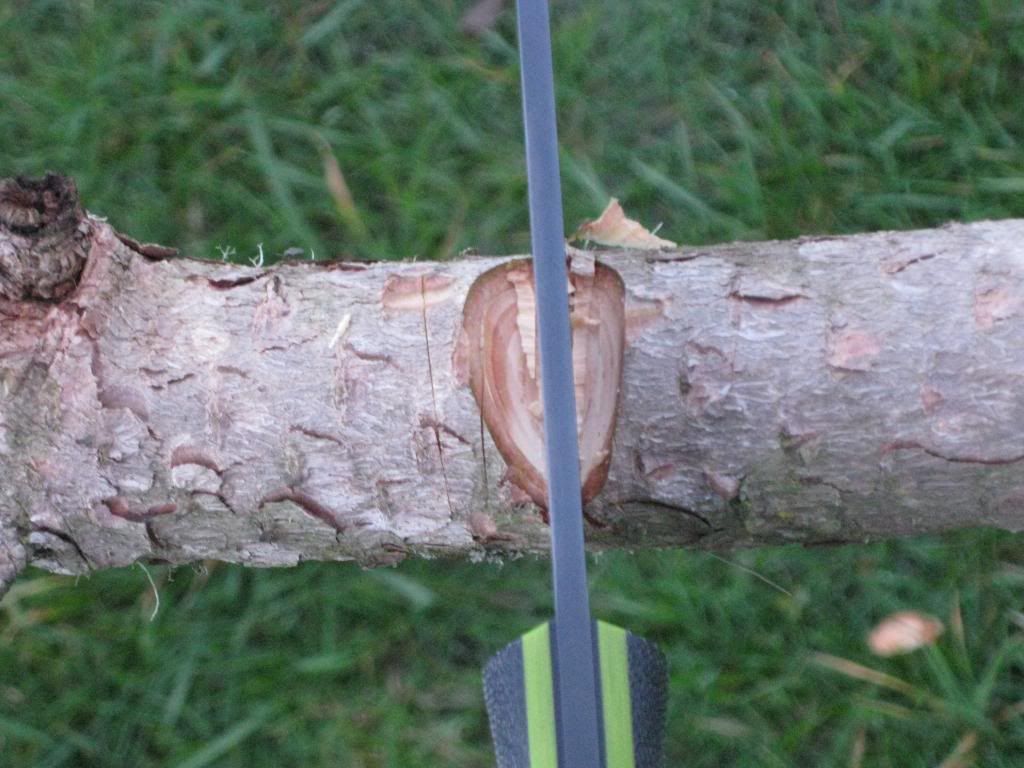

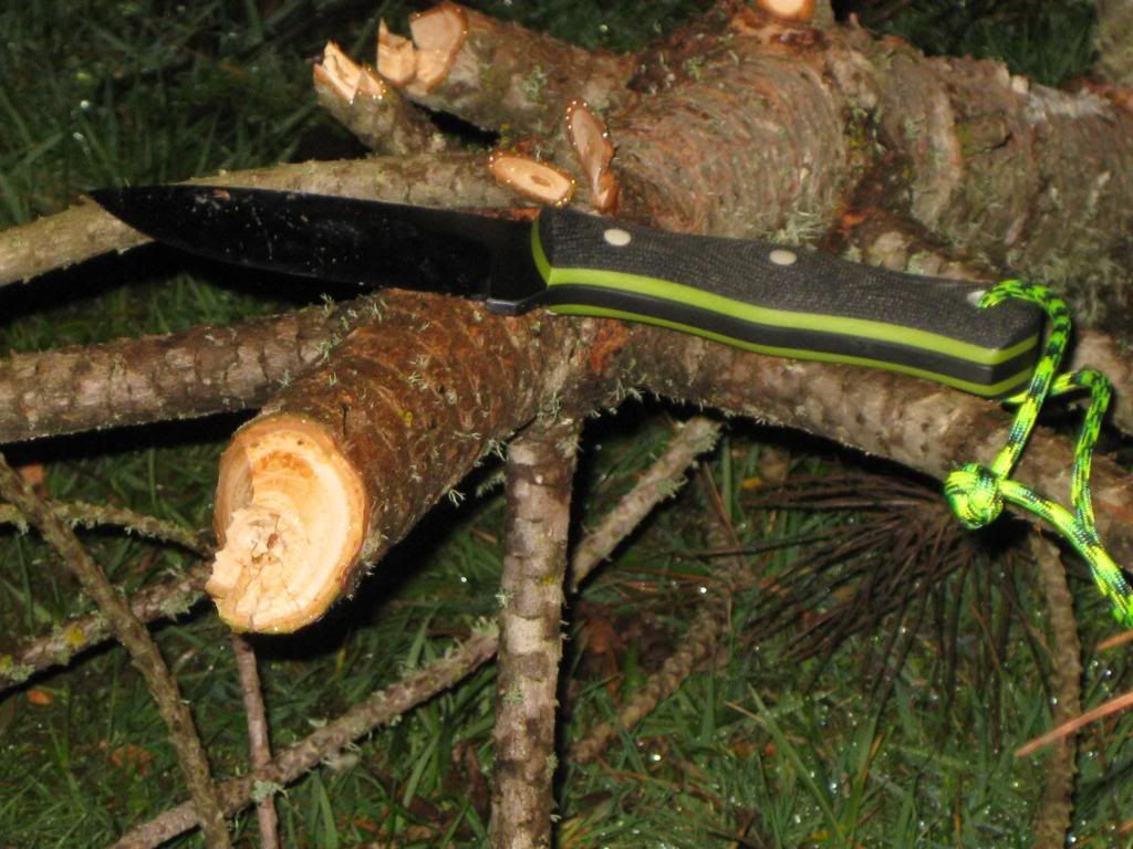

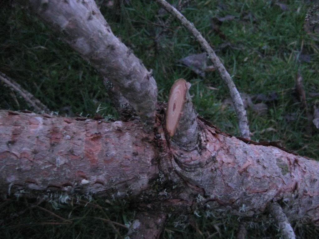

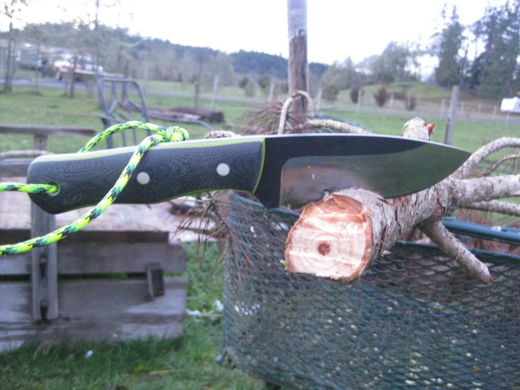

Ok now to some outdoor tasks...First up let's see how a small blade like this chops, having several knives in this size range I wasn't expecting much. Boy was I wrong...this little guy chopped like a much bigger knife.
Batoning through some limbs...one nice wack.

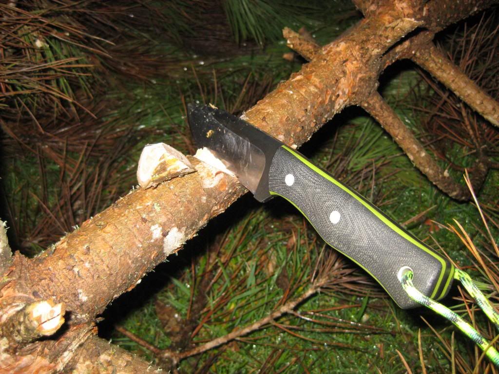

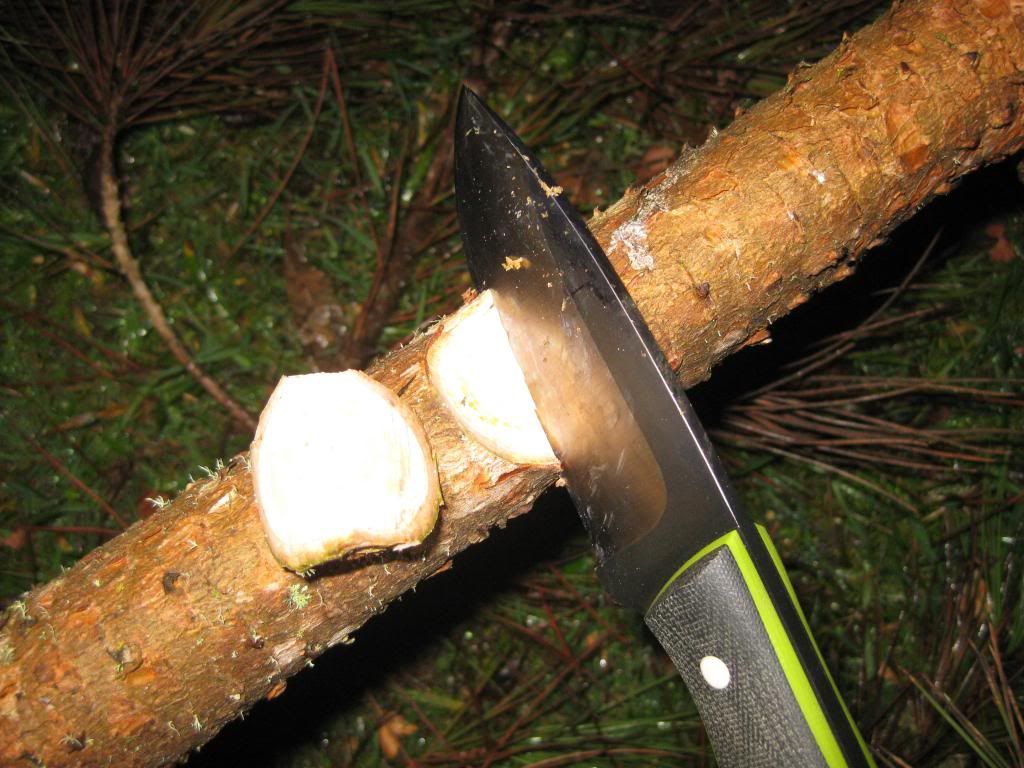

Batoning notches...no problem.
Let's just go all the way through...
I beat, chopped, batoned, cut and you name it to this knife for a good hour. It's been a long time since I had that much fun with a small knife. Edge retention after this beating...like it never happened.
