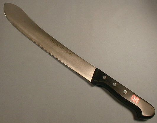

Next would come the steel and the other knives most often seen in knife block sets that are named after thier function -- boner, parer, cleaver, bread knife, butcher knife:
This is what I think of when I hear "butcher knife", anyway. I don't own one, but I speculate that it is a combination of a slicer(from the length) and a skinner(from the belly), with enough stiffnes to serve as a boner to be used for processing meat into it's particular cuts -- something that is becoming a lost art known only to those in the meat cutters union, cooking school, or the self-reliant hunter. Seriously, ask your old lady if she can bone a chicken. After she's done beating your ass, ask your grandma the same thing and I'm sure she'll say yes.

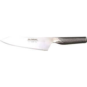

For purposes I have 4 knives I do everything with.
Global 7" Oriental Cooks Knife - a fantastic do it all utility knife.

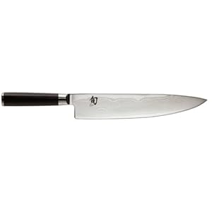

My CRKT Big Eddy - this thing was on clearance here in town for $10 and it is a champ that blasts through fish and is great for trimming pork loins...both things I do a lot of.
Lastly, my Shun 10" Chef Knife. I love this thing but I only use it for serious slicing jobs. It is a razor and as such has a more delicate scary sharp edge.
