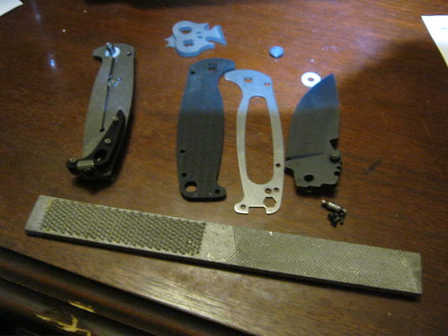

OK RYP I took you at your word and would like a new stop pin please:D! To answer everyones questions and even my own I took my knife apart, took my stop pin and using a file and a mouse sander, sanded it down to a smaller stop pin. I had to see for myself if it would effect lock up, hit the back spacer or mess up the ball detent. It did not mess up any of these and the tip of my knife is now perfectly behind the handle. I will post pics in the next 15 minutes or so.
On a side note. When I took the knife apart and started messing with it to check the detent, you can tell that they did put in a bigger stop pin than originally planned. With my stop pin sanded the ball detent goes in a little bit better and keeps it closed just slightly tighter. I like it and the blade does not hit the back spacer.
Lastly! RYP can I be the first to get a new stop pin because I wrecked mine up pretty good doing this. It looks like shit now and sticks a little bit through the handle. Thanks again for the knife it is bad ass and well built. Obviously I plan to use mine.

Took the knife apart! Easy to do!
IMG_1796 by whittyapp, on Flickr

If this changed the lock up it is such a small amount of change that I can not tell.
IMG_1802 by whittyapp, on Flickr
Hope this helps everyone feel better about the idea of a new smaller stop pin. It should fix the problem and have no ill effects on the knife what so ever.
Whitty
^ This is great news. I hope DPx offers to mail the pin out so we don't have to mail it in...
That would make this situation a LOT better.
Don't take the time to change the production versions. Just ship them with the smaller pin and let us change it if we want.
