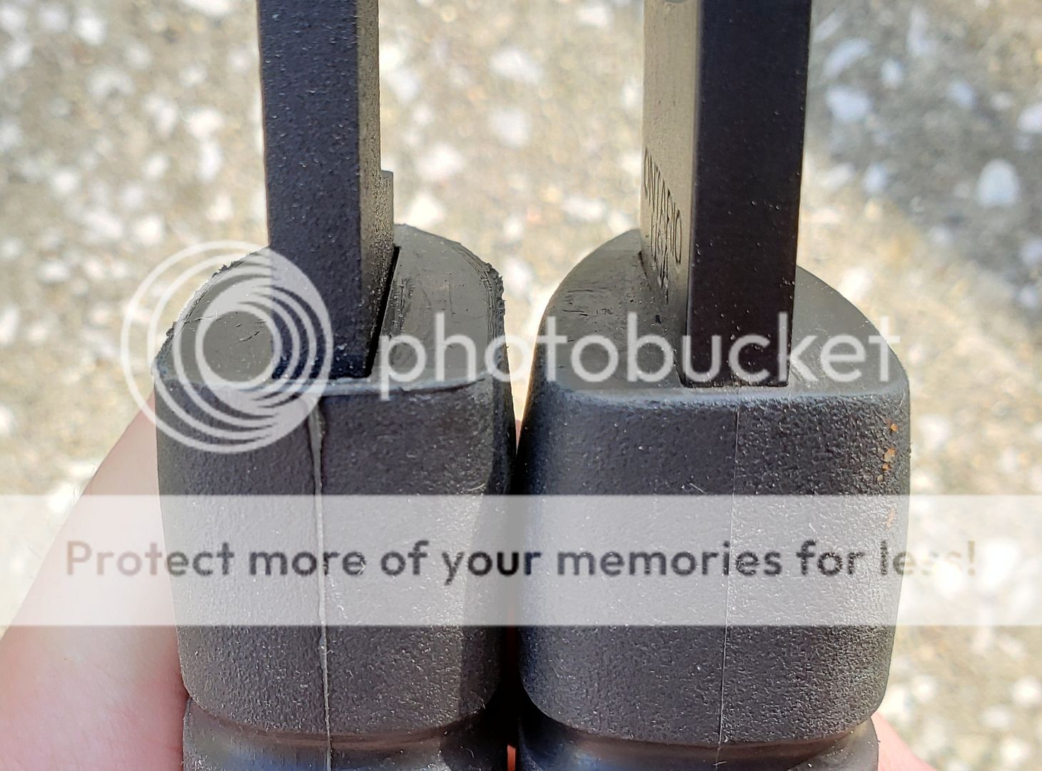

Dear Tooj-
In this picture on the right is an OLD stamped Sp5 that shows a Spec Plus handle as i known every generation of Spec Plus handle to be- that is molded directly to the tang with a finished top.
On the left is 1 of 2 sp53 handles that i have recieved with what looks like an unfinished, smooth top with squared corners, and a considerable gap between the handle and the tang, and both sp53s like this wobble in the handle.
Whats up? Are handles made entirely differently now, or did yall have a monsterous bad batch go out accidentally?
