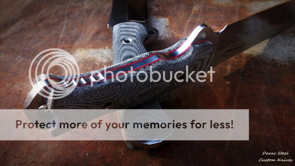

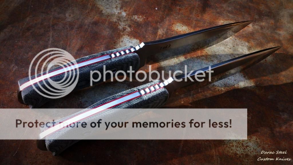

Jimping is made with a round file...
After baking knives they have returned a little dirty ...
Rockwell tester says 58 HRC

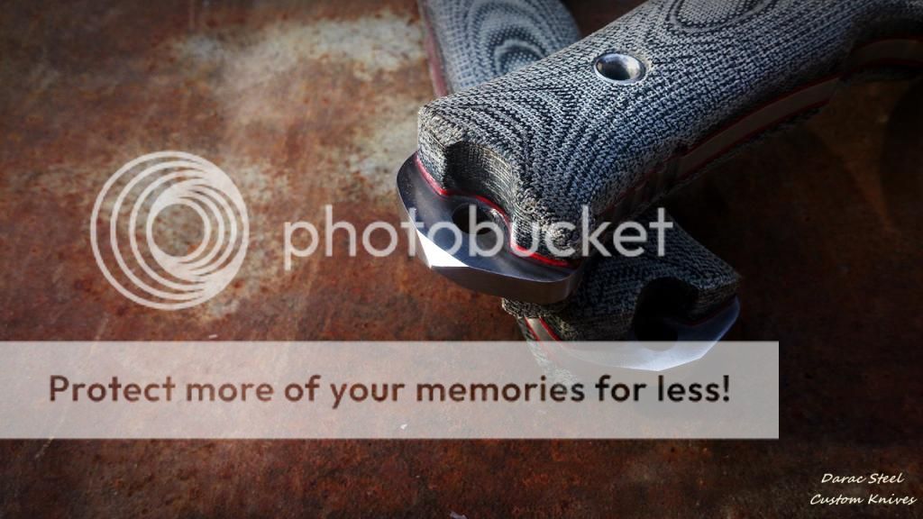

Handle
Epoxy, green canvas micarta and red vulcan fibre...
3/8 thick
Handle contouring
Ta daaaa....
Temporarily pined for handle shaping....
And hand sanding...
Preparing for final assembling ...
SS tubes
And that's it !
Still need laser engraving and some sharpening job.

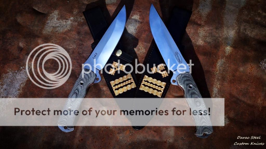

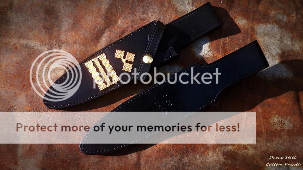

Time for a sheath!
First I sketched sheath and made template...
Cutting out parts
Edge slicking...
And glued !
MAkers mark and some numbers stamped...
Gold plated rank of Lieutenant general
(Croatian army)
Hand sewn with saddlery stitch...
Some polish and protection
And finished sheaths
Sorry for the bad pics ...
Still needs the presentation box, and then come right pics :D

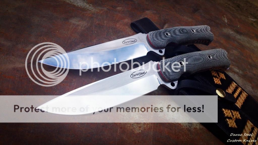

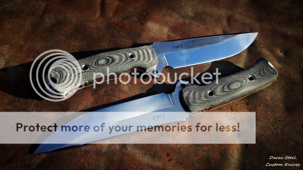

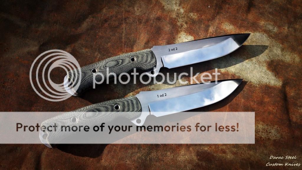

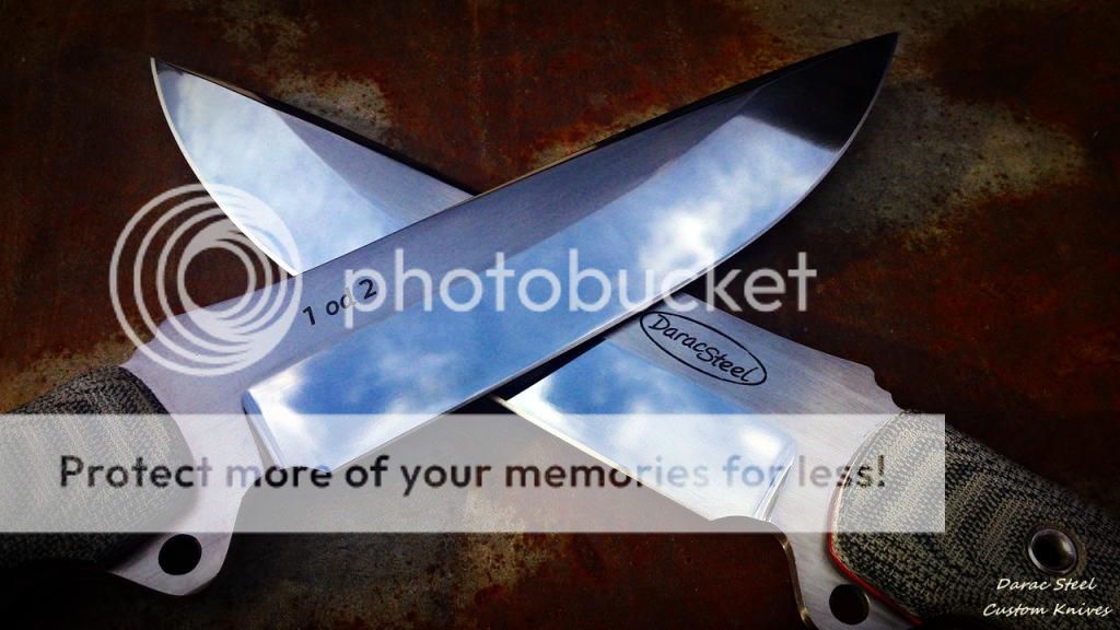

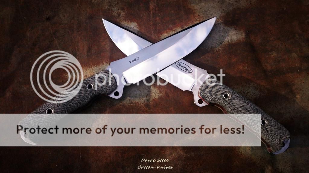

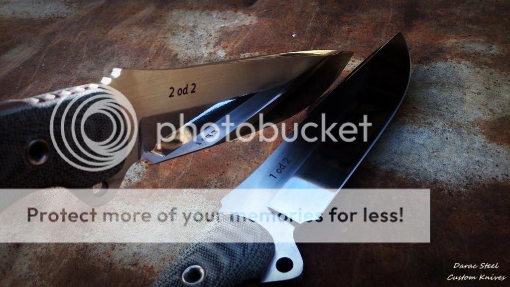

Finally finished!
Ladies and gentlemen, meet Croatian generals :D
Blade Length - 170 mm (6,7") x 5 mm (0,196")
Overall length - 305mm (12")
Blade Steel - N690Co - stainless steel
Blade Finish - Mat & Mirror
Handle Material - Sand blasted green canvas micarta & red spacer
SS flared tubes
Sheath
Vege tan cow leather 3,5 mm thick
Gold plated Lieutenant General Rank
Thank you for your attention!
I hope you liked !
Thanks guys !
