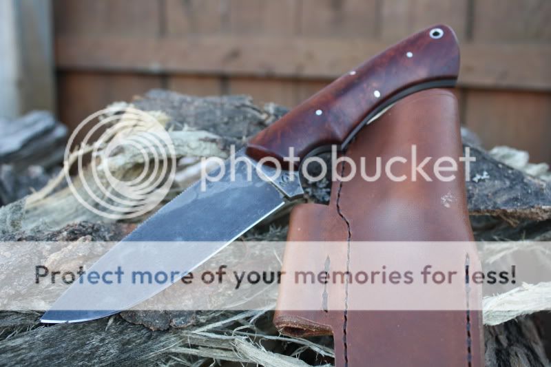

This one sports an antique finish and some of the nicest handle material I have ever seen. I am unsure of the name of it but I am sure the owner will chime in and tell us:thumbup:
This one is made from 3/16" thick O-1 differently Ht'd to 60RC at the edge.
Stainless pins and tube
9 ozleather sheath treated in bees wax.
I hope he likes it as much as I do
Thanks for the oportunity to make you a knife Stumpy
Nick:)
nick super nice the blade finish looks cool nice and used super :thumbup::thumbup:
That Looks AWESOME Nick!!! The Manzanita Burl and the antiquing turned out GREAT!!! The wait will be even worse now that I know it's finished!!!:D
I can't wait to hold and use it!!!!
You do KILLER work my Friend!!!!:thumbup:

I actually want to keep this one man:eek: But I wouldn't do that to ya:)
It looks and feels great in the hand:thumbup:

That looks FANTASTIC!!!
Every time I look at one of your Sierra Scouts I want one.
Especialy like those scallops you have put on some of your handles lately.
That is an awesome combo with the aged finish and a beautiful piece wood.
I agree, the wood is very nice. The Antique finish does help set the tone also, a great looking working knife.

There was a lot of voids in this piece of wood and to be honest I was a bit concerned if I was gonna be able to make it happen. But, it all worked out and freakin sweet if I do say so myself:thumbup:
I am more than confident you will love this one man.
Nick:)

Incredible work as usual! The combo of wood handles and etched blade is really amazing...enjoy!
Damn Nick! What a knife. Looks PERFECT!
What did you antique with? I use cold blueing and bleach and about 2 hrs.
I get this effect.....
Dont mean to hijack the thread but I had to ask cause thats more subtle than mine and its perfect for that wood!
Hi B, I use the exact same method. I use the splashless bleach though. It seems to work better for me.
Nick:)
