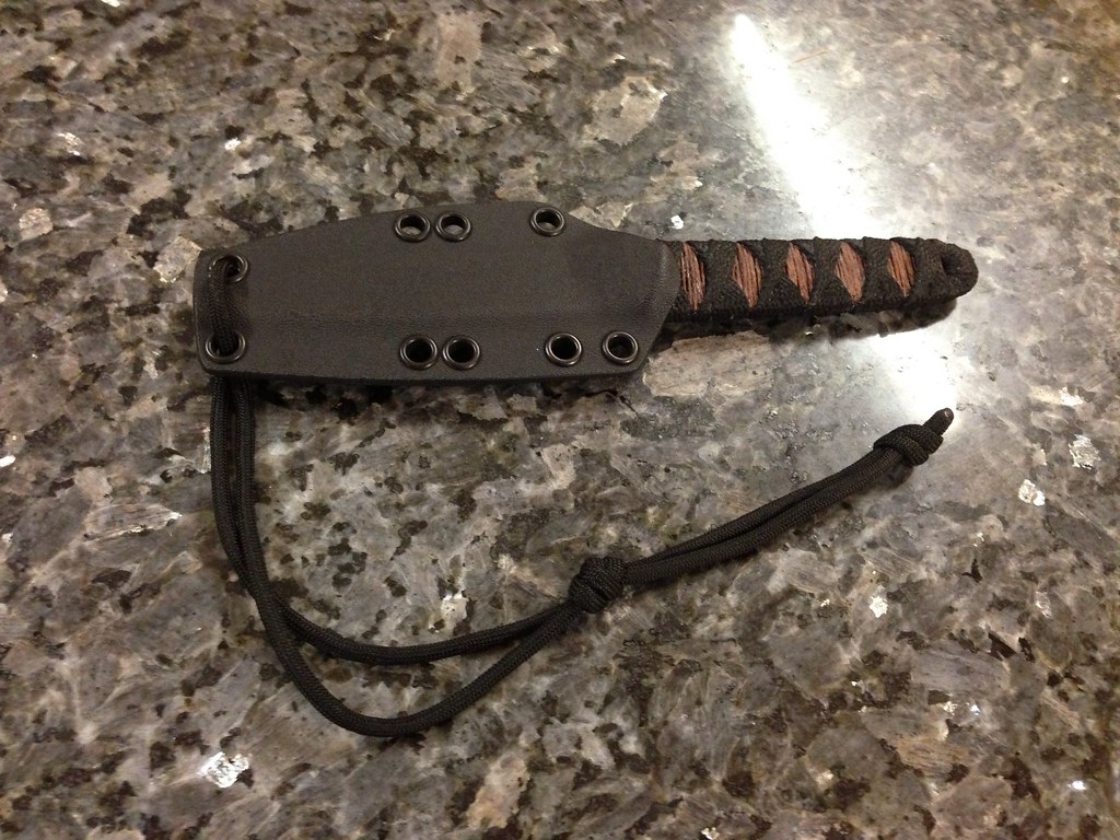

Personally, I like using paracord and attaching it to the front of the sheath. I just loop one end to the belt loop and shove the knife and sheath in my back pocket or tucked inside my waistband. I sometimes tuck the knife into my front pants pocket. People have all sorts of names for this... I think some call it shock cord? or static cord? I don't know the proper name but have been using it for well over a decade for medium to small knives when I don't feel like attaching them to my belt.
A picture is worth a thousand words I have the knots set at two separate lengths. Short length for Inside the Waist band and longer length for back pocket carry.
