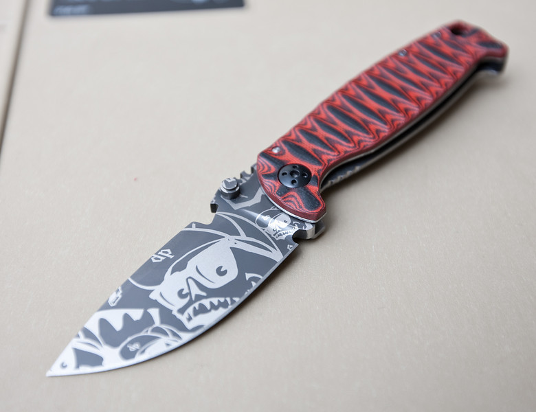

Got my HEST today , thank you very much for fast shipping !!!,

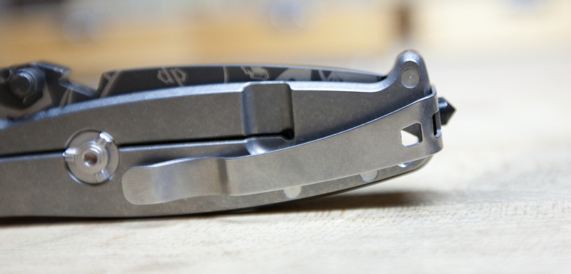

but my HEST had problem with blade sticking out, I really dont wanna send it back or install thinner pin .
This is not official fix , I am just showing what I did .

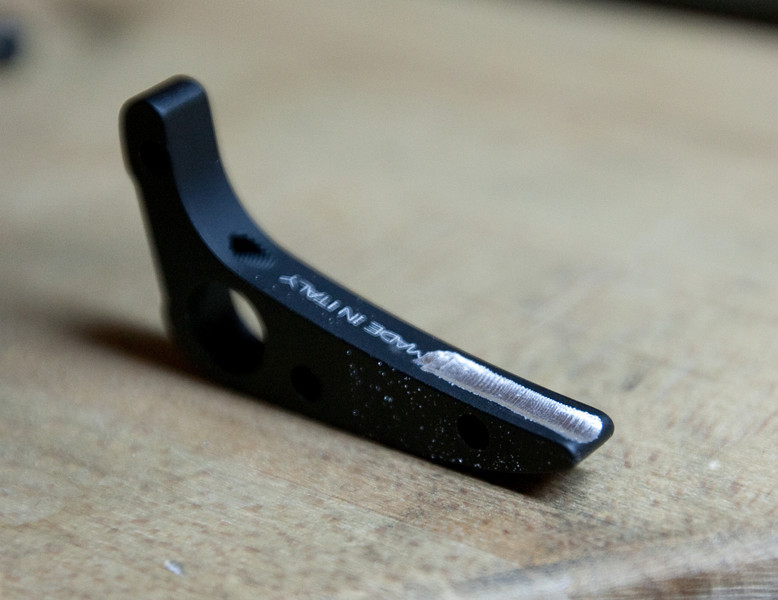

how it looked then I got it .

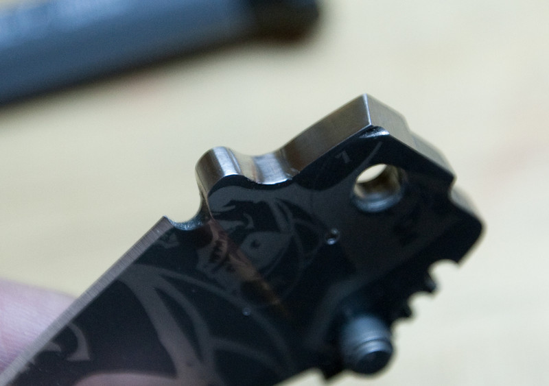

how it looks open , contact point of the stop pin .

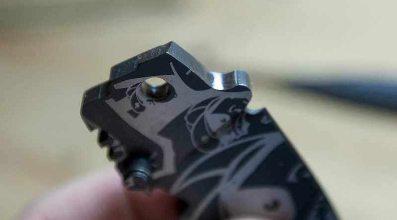

took some metal off here .
finished

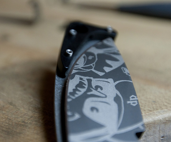

took some metal off back spacer , blade can go deeper now without touching back spacer .

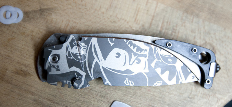

.assembled .

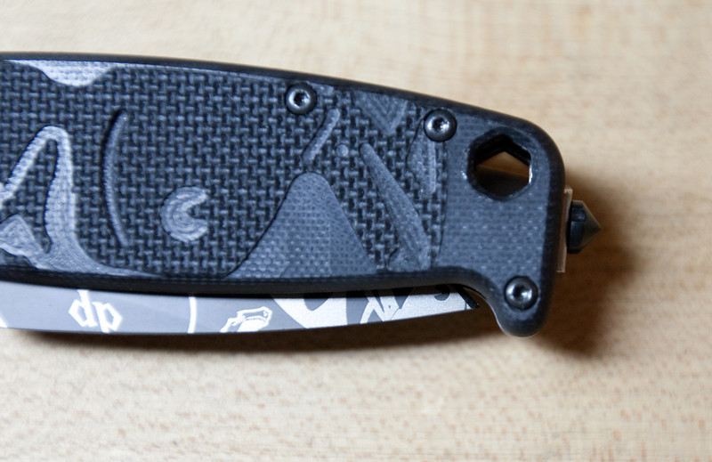

and final touch new g10 scale , love this color .
I think this is very good knife, just need few bugs fixed . :thumbup:
