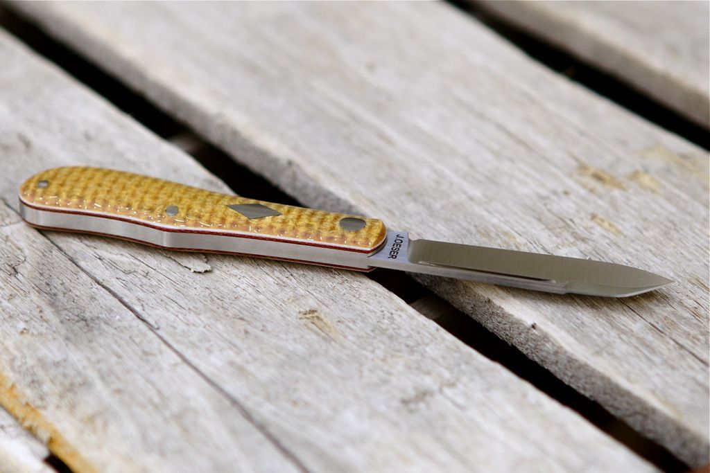

Here it is when finished

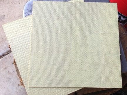

As it ships

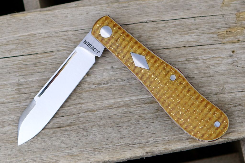

If I had the funds right now I would grab some of this. I was lucky enough to get some early on from Ben and it is on my personal EDC: (Photo does not do it justice)

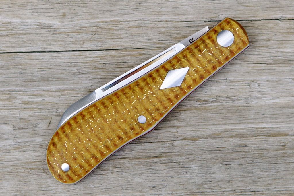

I got it and it looks like great stuff, very cool. I'll post a pic here after the knife is done.

I milled it and it seems to mill very similar to canvas micarta. No chipping or issues to speak of. It milled better than LSCF which is what I tend to compare it to most.

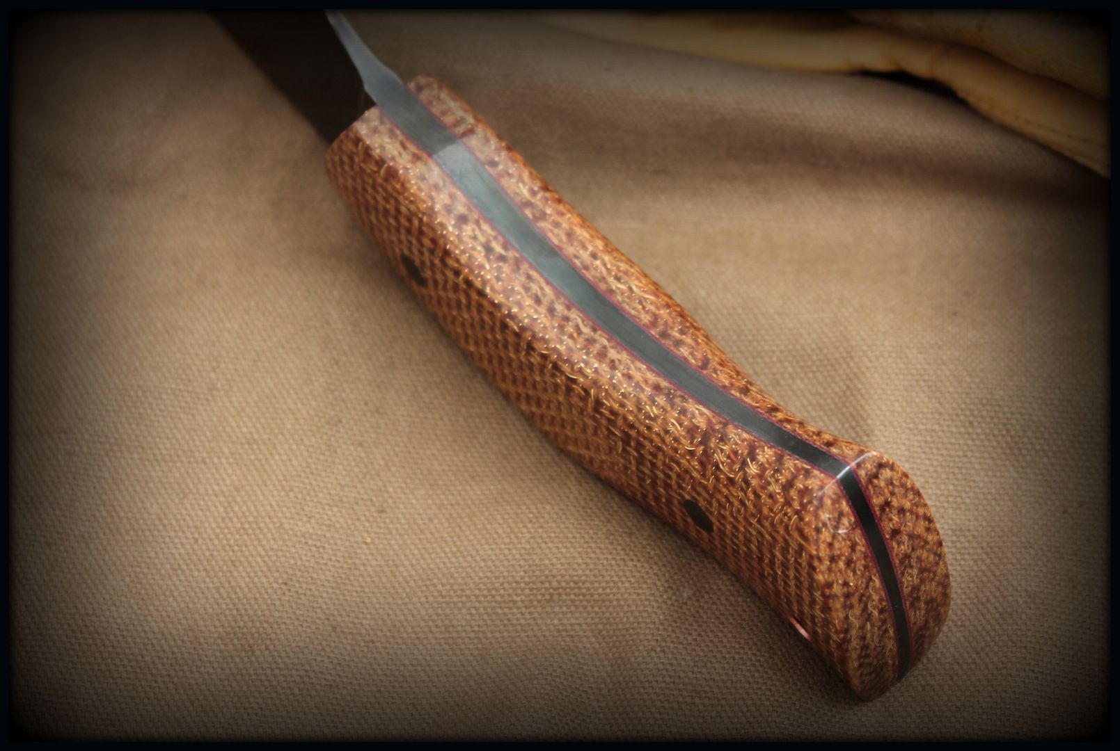

Here are some pics of one I just finished. It is not a high gloss polish material. I took it to 2000 grit soaked it with some mineral oil and buffed it lightly to get this finish. It is very grippy and looks super cool in person. I really like it. Very similar to burlap I have used.
