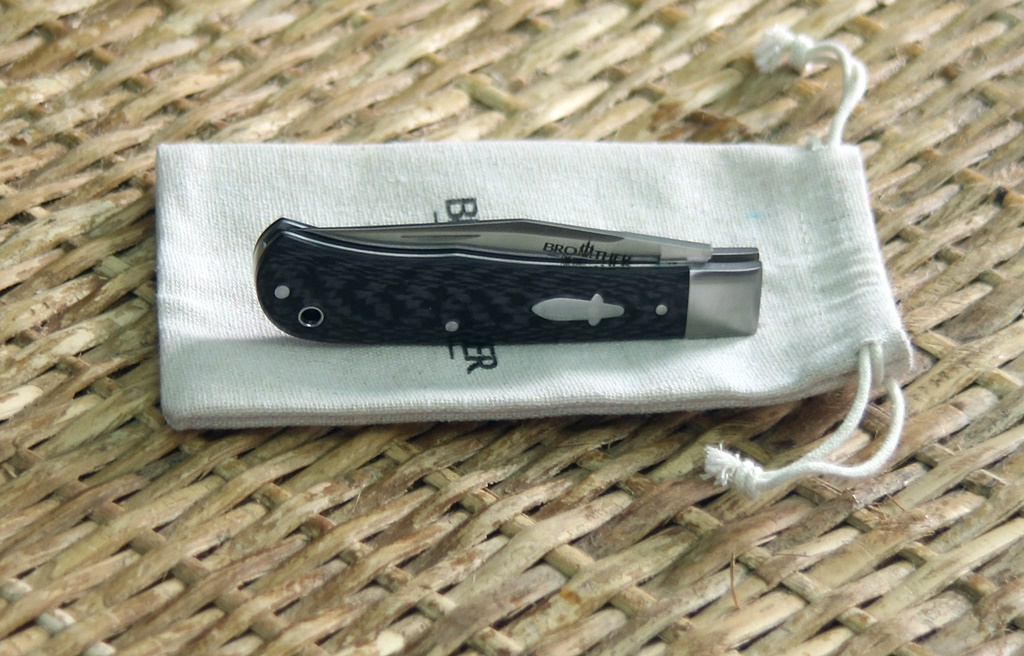

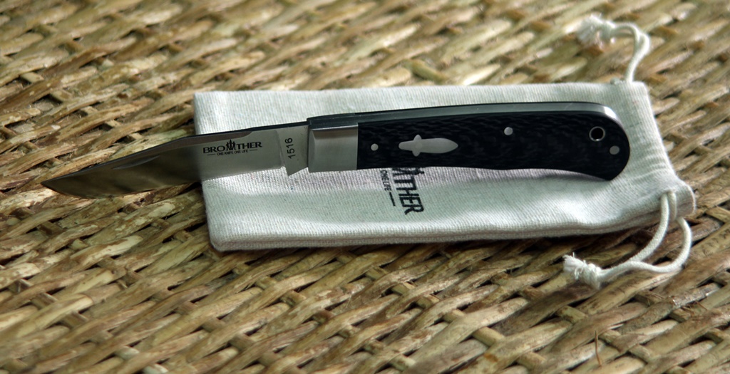

Wanted one of these for a long time , but there were so many other knives to want and test !
But here we are :
Looks great , feels really good .
Excellent walk N talk , no blade play to speak of !
And moist importantly ( not a typo ) , it cuts ........ printer paper ! ( Hmmmmm )
Yeah , there will be a rope slice later on .. But this post is for the Looks N Feels crowd !
Honestly , I can't find anything to fault . The finish on the knife is almost 100% .
