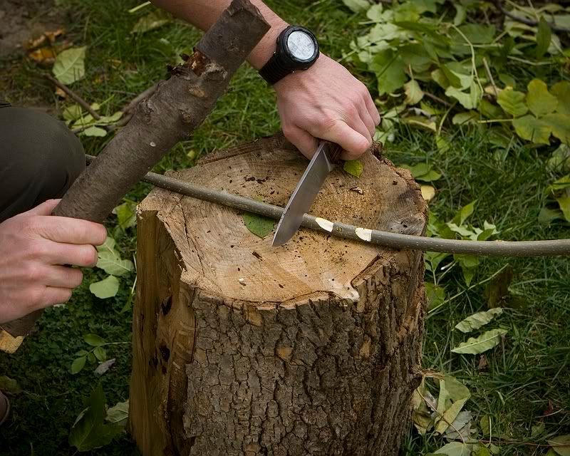

Test Method
I am sure there are a few folks that are wondering if a test like this is even valid. I mean, we have a bunch of knives being asked to cover a very wide range of tasks. Then, they are being evaluated by ONE person! I admit, there can be a lot of subjectivity into every test, and I am going to try my best to minimize that. In order to do that, I plan to do the following:
I will have one section on my opinion. A lot of ergos, balance and “feel” is going to be highly opinionated. I plan to give that : ) but everyone has to realize that my opinion is not necessarily theirs. The best you can use it for is to know how aligned your tastes are with mine (or not) and draw your own conclusions. I will get the opinion out of my system, and hopefully be objective from there : )
If at all possible, I want to provide data on the knife that will back up its performance, or data during the test itself. That will only be possible in a few cases, so in general I just plan to comment on performance without drawing any conclusions. Again, I just want to try and state facts.
Finally, I know that a camp knife is a highly personal choice. The one I select might lean toward better performance in kitchen duties while one you want may lean towards better chopping performance. It is unlikely that one design will do all so stellar that I don’t want multiple knives : )
So, I intend to rate each knife individually against the given task. The rating will be a 1 to 10 type of deal. At the end of each section, I will summarize the individual knife performance for you. And the end of ALL the testing, I will add up the totals from each section, and see what the grand total is for each knife. It is quite possible that I could end up with an eleven way tie!
The reason I like this testing method is that it can allow each individual reader to tailor the results to their liking. For example, I will have a 1 to 10 rating on “Fit and Finish.” If that is not at all important to you, you can drop that entire section from the score, and re-total it yourself! It is also possible to take the final scores and introduce a “weighting factor” to give a different result. I will explain that at the end. But, if you rate “chopping” as a higher priority than “food prep” you can easily manipulate the numbers based on your own individual priority. Hopefully, that will make sense later.
In the end, I am relying on an educated reader. To take the information I am providing, understand their own needs and “wants” and make a selection based on that. Not necessarily based on my opinion or conclusion.
Order of Tests
Before beginning, I already come to the conclusion that I will not sharpen any knives. There are too many different grind styles, angles, opinions on finishes, etc. Instead, I intend to do the tests in order such that the finer tasks are done first (when the knife is sharpest) and continue on down the line with the more abusive tests toward the end. It is the best solution I could come up with.

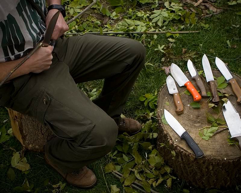

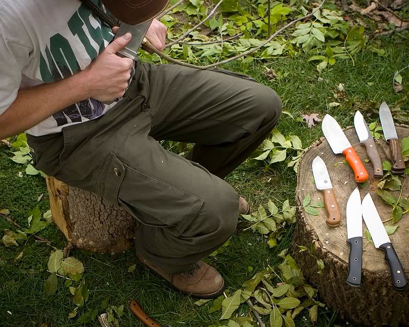

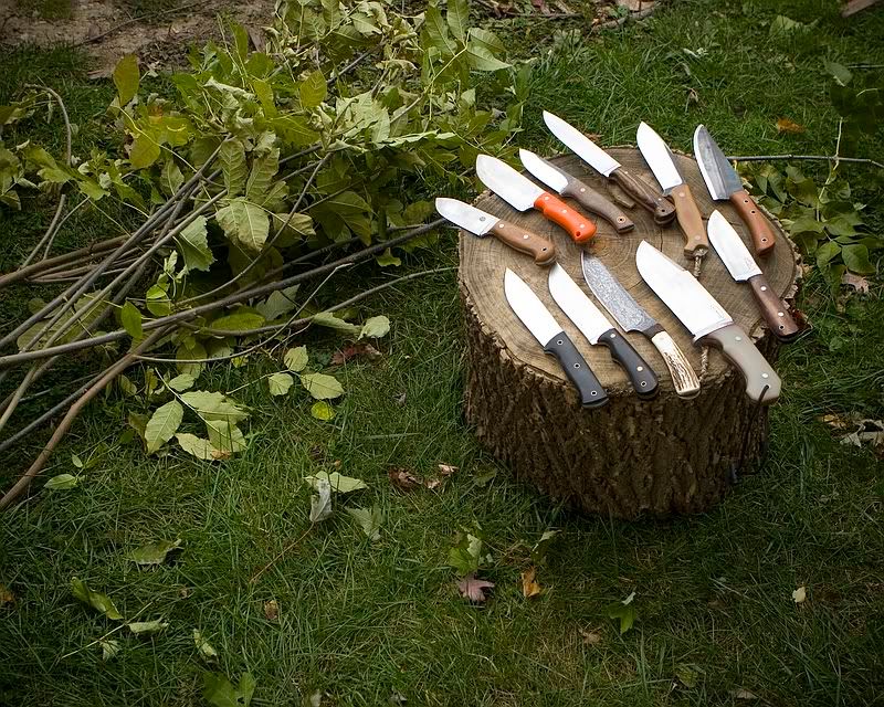

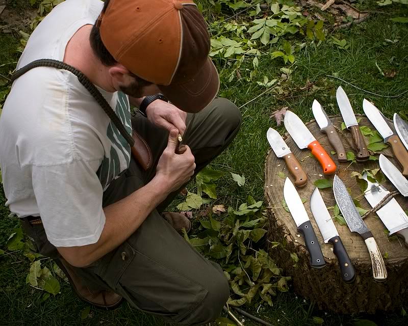

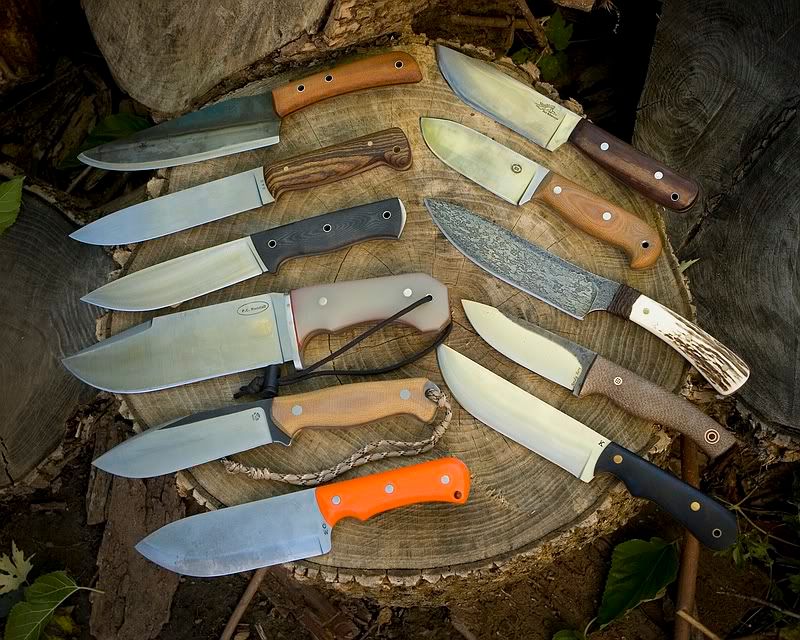

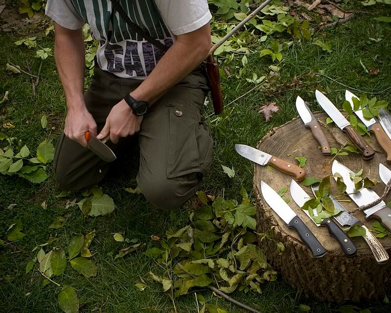

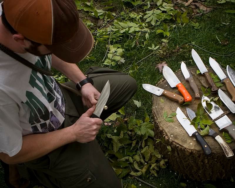

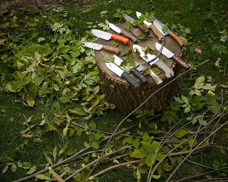

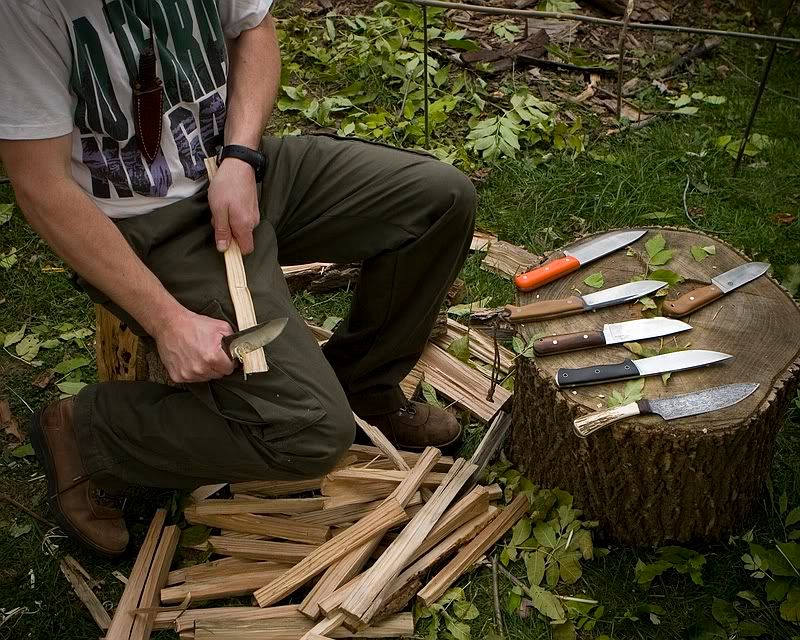

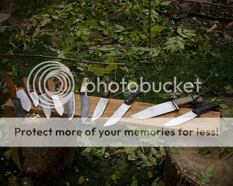

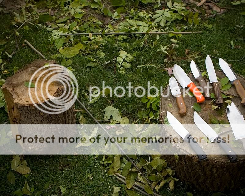

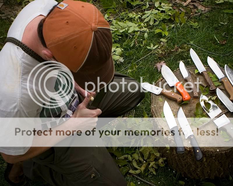

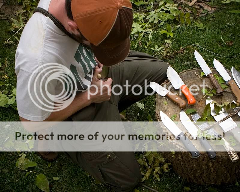

Entry Showcase
To keep things simple, I keep referring to the knives in the same order over and over again.
In this section, I took a picture of each knife and detail the information that the maker gave to me. These are not my words. I have just posted their info here.
The following are the entries I received:

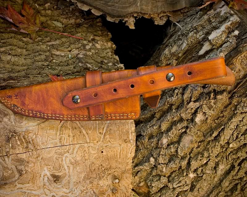

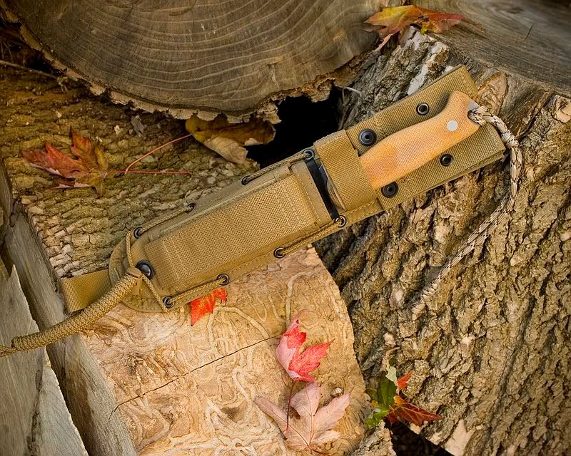

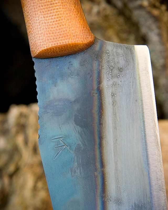

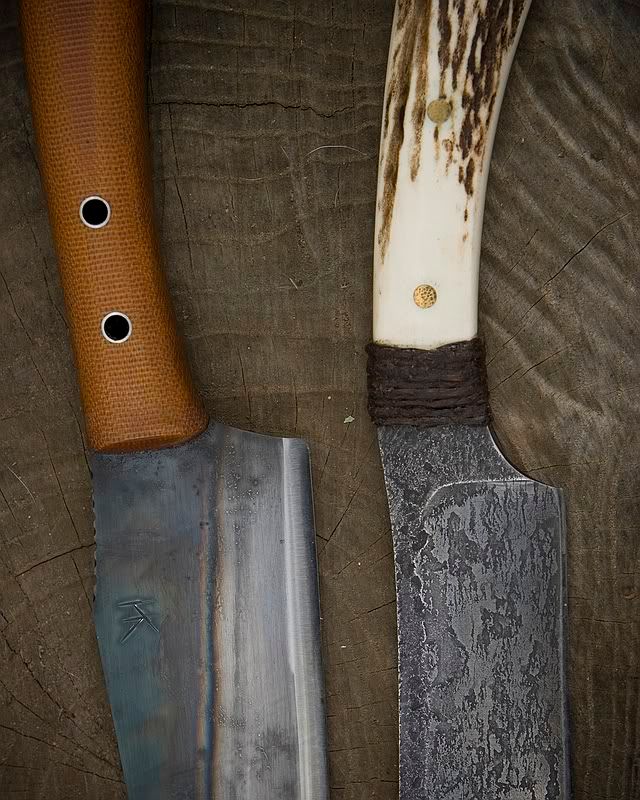

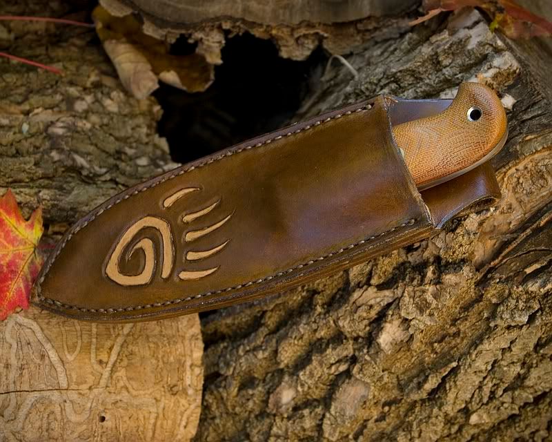

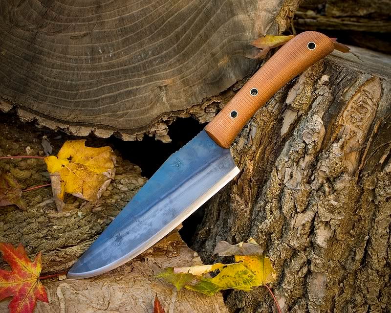

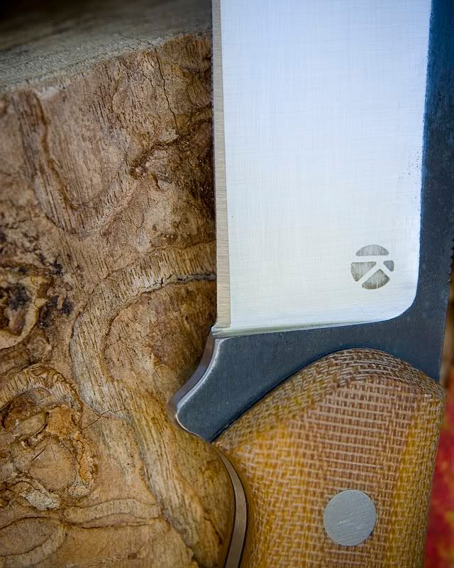

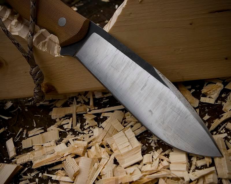

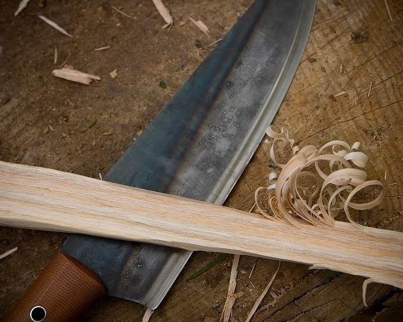

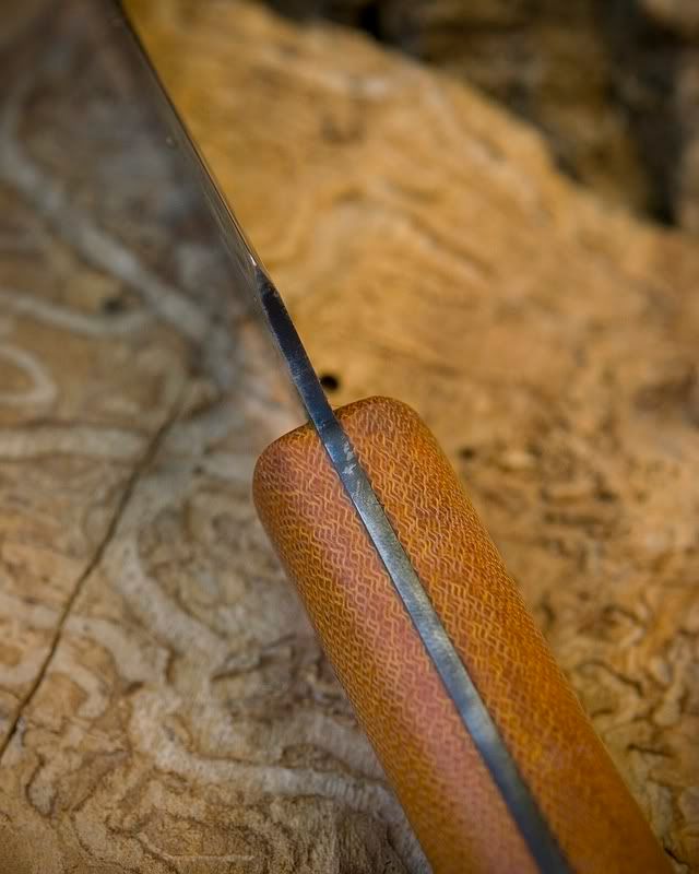

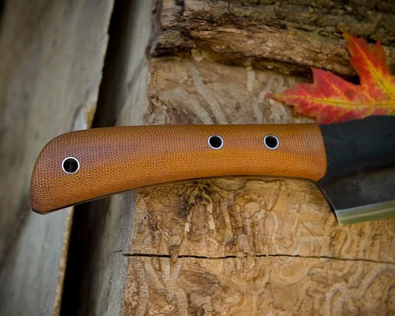

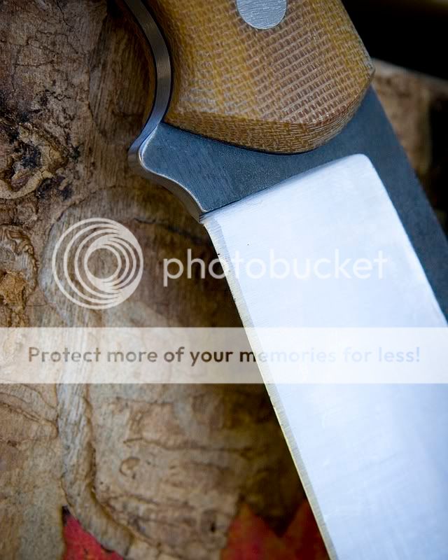

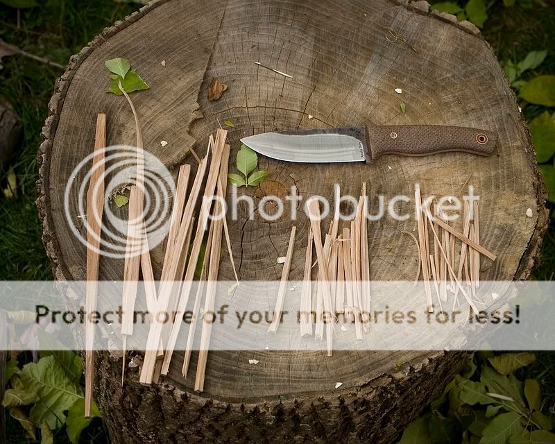

Koyote
Alaskan. (model name)
Camp knife challenge entry
Christof Harper
www.koyoteknives.com
christof@koyoteknives.com
sietchtabr@gmail.com
Sierra Student (sheaths)
OAL 12.25
Blade 7
thickness, nominally .095 (3/32)
2 inches broad at top of thumbramp
15N20 steel, differentially tempered.
handle is tan canvas micarta, flared (peened) lanyard tubing pins with
slow set epoxy on the scales.
"convex scandi" grind.
notes: pinch grip and forward choked grip capabilities designed in for
fine work, good drop edge for chopping and camp kitchen. "micro
spearpoint" tip is good for drilling fireboards and plenty strong.
I'm especially curious how it does with finer bushcraft tasks. I often
use a much smaller drop edge for heavy carving technique situations,
but it should work out with the right grips.
Strop away however you want. Sharpening shouldn't be a problem.
Don't forget to use thread locker (nail polish in a pinch) on the
chicago screws when you find a setup you like for carry.
I have sometimes used recycled bandsaw- I like doing so, but most of
my blades from 15N20 come from new stock I get through Kelly Cupples.
I'm really focussed on simplicity in design- this is almost a "busy"
knife for me for a field blade. The simpler and more comfortable the
knife is in multiple grips, the better off the user is :)

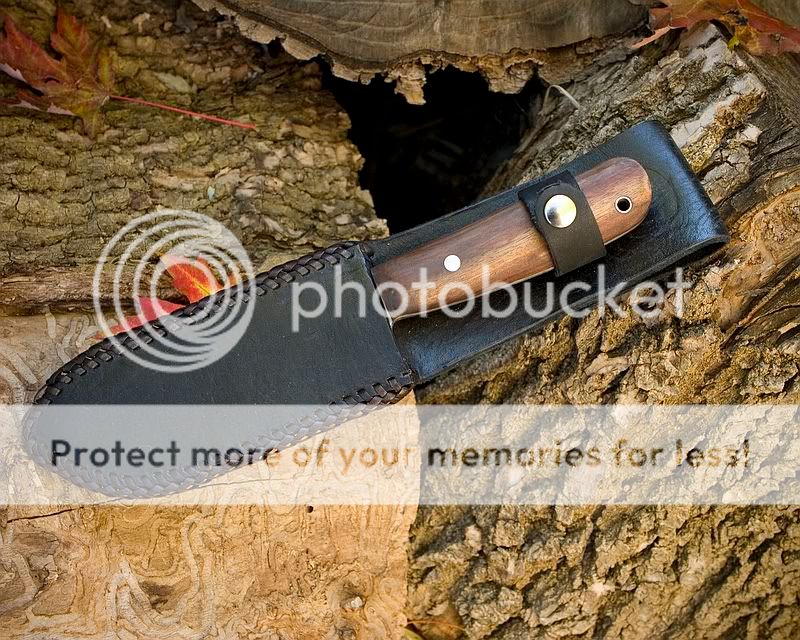

Noshtero
Here's what I can say about it.
5 1/2" blade
10 1/2" overall
3/16" 01 heat treated and tempered by yours truly
Mirror polished edge
Poisonwood handle with aluminum pins and lanyard tube
Black leather sheath with braided stitching
This camp knife is the 6th knife I've made. I sold my very first knife two weeks ago out of my pass-around. That was the 5th knife I'd made. So I guess I'm sort of "in business" now.
My process is very simple. I make these out of my garage. I basically had Stomper pick out all my equipment. He even let me have his old charcoal forge. I haven't really developed any trade secrets yet.
If it's going to look really weird because others have written pages out their knife, then let me know and I can embellish it. I guess by nature I have a hard time talking up myself. I would like to highlight that this is my sixth knife. This is probably Koster's 6000th! As far as price? I'm wishy washy on that. I don't personally feel my knives are up to the standards that the other makers set yet, so I'd have a hard time charging what they charge. For a 5 1/2" blade like that.. I don't know. $120ish? Maybe a little less. I'd actually be really curious what you think I should charge for one like that.

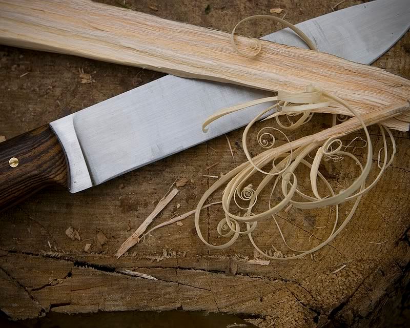

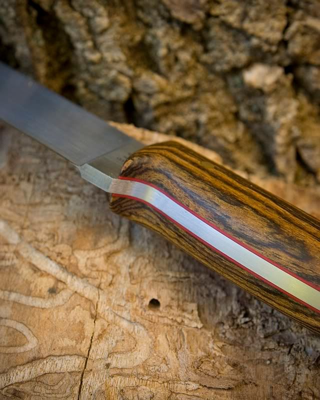

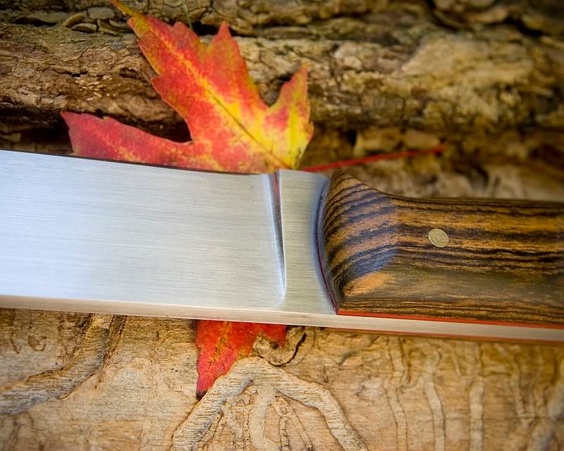

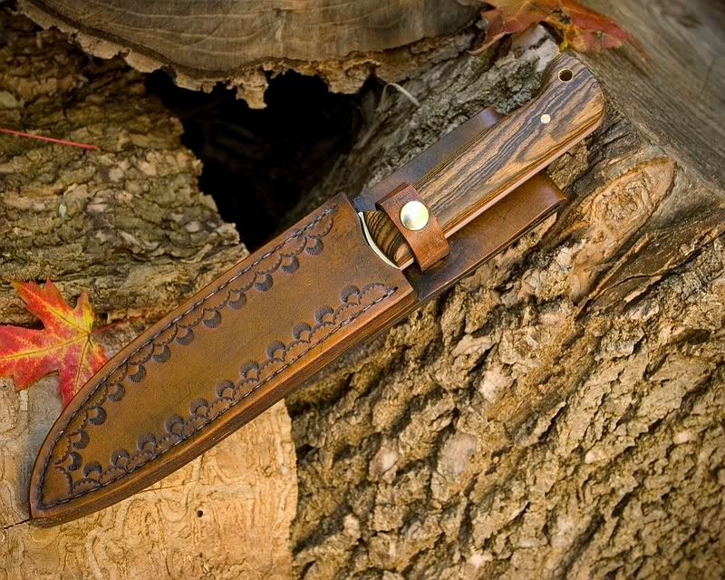

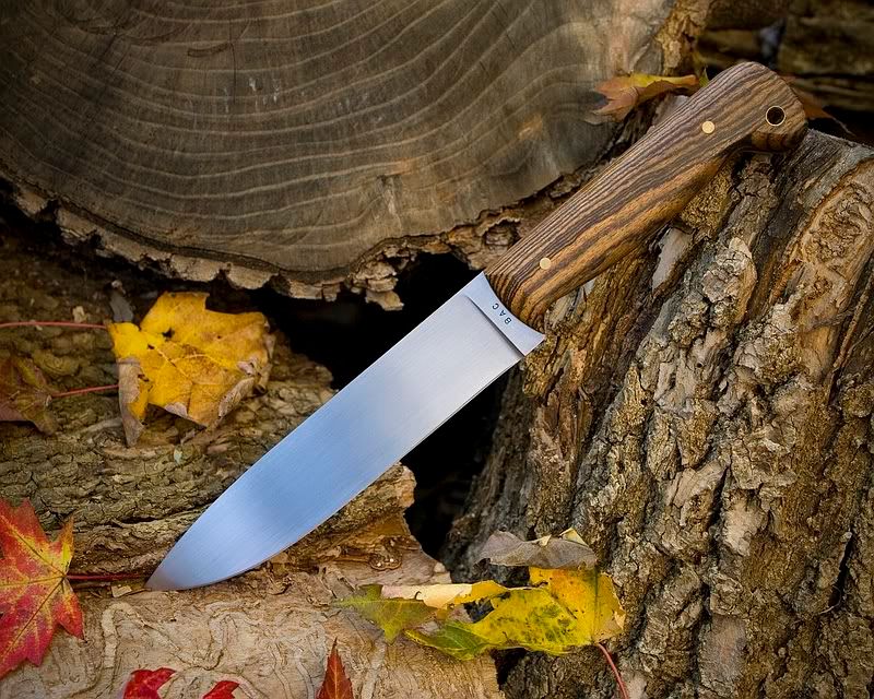

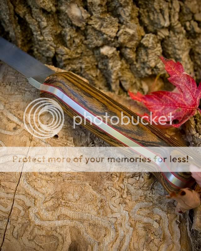

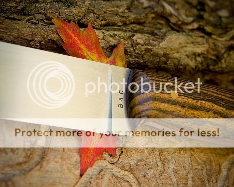

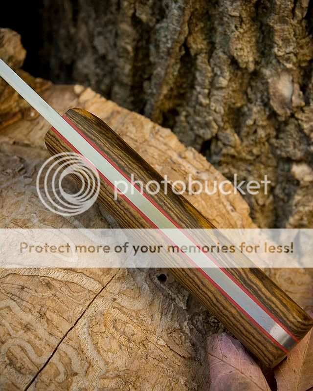

Bruce Culberson
Like most other knife makers and knife enthusiast I loved knives ever since I was young. My first knife was a single blade slip joint that my dad bought for me at the local corner store. It had a picture of an RCMP officer riding a horse on one of the scales. I have also always had a love for the outdoors – camping, fishing, hunting, and hiking. I like doing things myself such as reloading rifle ammunition, fletching arrows & cutting them to length, tying my own fishing flies, glass bedding rifles, etc. So it was only a matter of time until I wanted to make my own knife. I started with putting handles on kit knives and I was hooked and wanted to make my own blades. My father is a carpenter and I think that is why I like wood handles so much.
I have made mostly hunting knives and smaller neck/EDC knives. This knife for this competition is actually my first camp knife and only the third knife I’ve made with a blade over 5”! I have been making knives for just under two years, and just started selling in April of 2009. My interpretation of a camp knife is that it is the SUV of knives – meant to handle some big jobs like chopping & batoning wood, but also nimble enough for finer work like field dressing game and fish. The knife I built has a thick handle so that it doesn’t create hot spots when doing heavy work. The balance point is right on the index finger – about 1/8” ahead of the forward pin. This makes the knife more lively in your hand for the finer cutting tasks.
I was thinking of making an 8-9" blade at first, then decide to go with 7". The whole blade was hardened, then after double tempering the edge was placed in a pan of water and I used a propane tourch to draw the spine back to blue for a spring temper. This leaves the edge hard but softens the spine making it stronger for tasks such as chopping and batoning. I went with a drop point blade since that design seems to do a lot of things well for me. The spine was left square for striking firesteels (I should have put a loop on the sheath and included a firesteel). The combination of a flat grind with a convex edge seem to slice well and stand up to heavier chores. The blade main bevel has a 95% flat grind finished off with a very slight convex. The edge is convex.
Here are the specs:
Blade length tip to scales: 7”
Blade width: 1 ¼”
Handle length: 5”
Grind: full flat with a secondary convex edge
Steel: O1 ground from 3/16” stock
Handle material: Bocote with red liners
Pins & thong tube: brass
The wood handle has several coats of tung oil topped off with bee’s wax. The blade was hand sanded to 320 grit for a working finish. Retail $185.

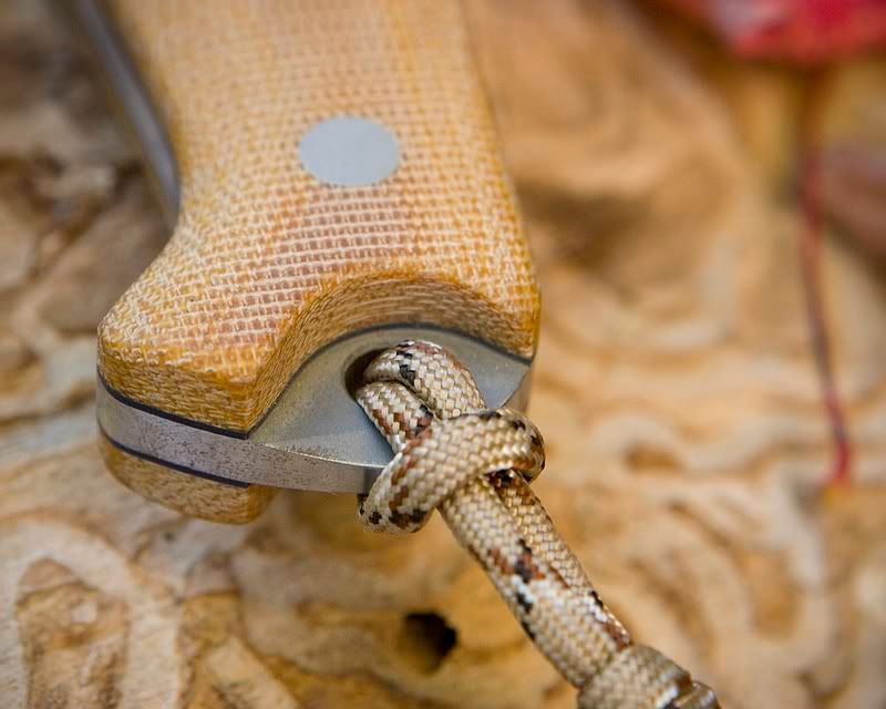

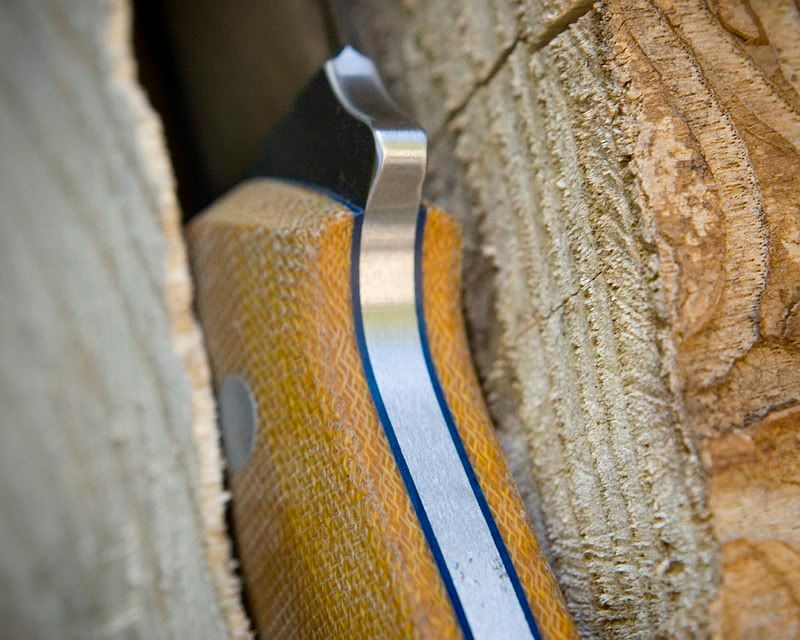

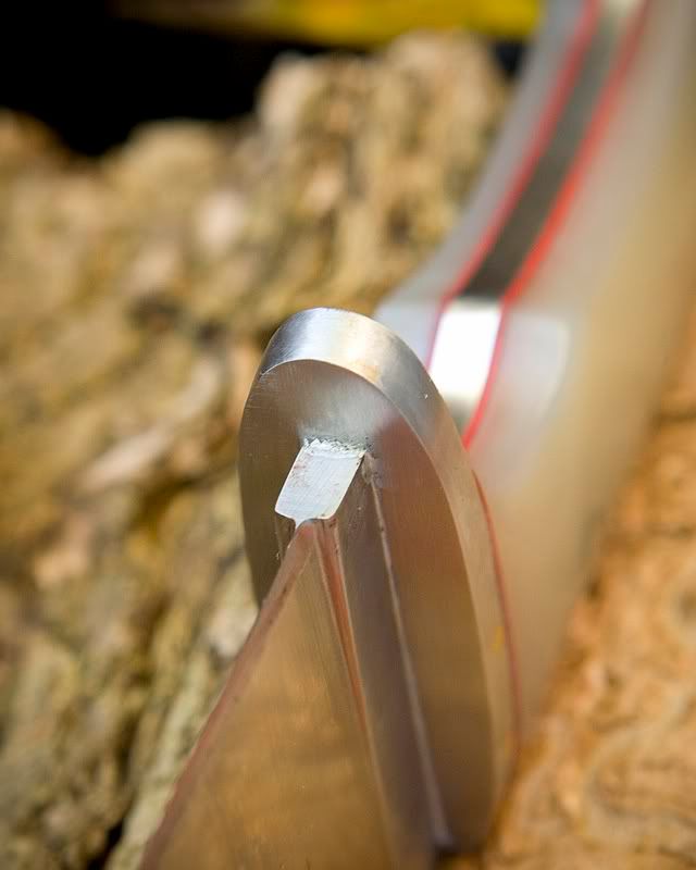

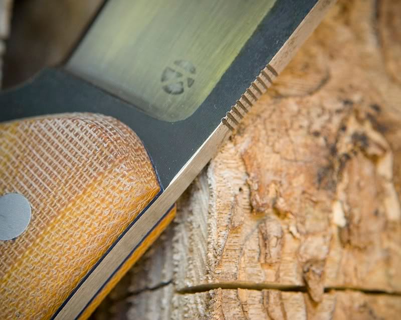

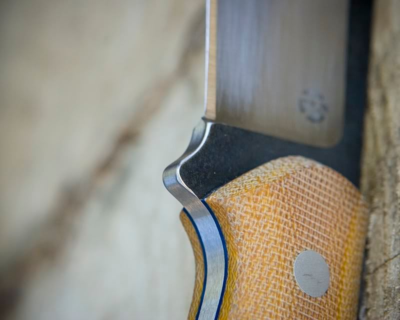

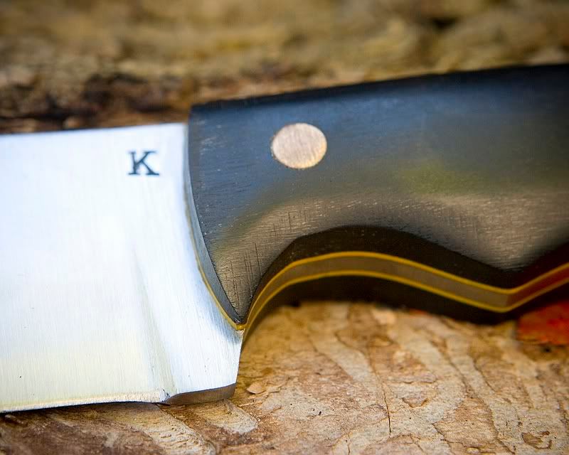

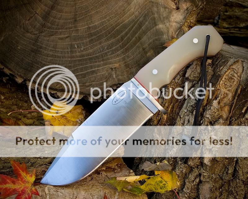

Koster
M.U.C.K.
(My Ultimate Camp Knife)
Overall length = 11"
Blade length = 6"
Blade thickness = 3/16"
Blade steel = O1, hardened to 59-60 HRc
Blade grind = flat grind with swedge
Sharpening angle = approx 30 degrees inclusive
Handle length = 5.5"
Handle material = Natural Canvas Micarta, with Blue liners
Handle finish = heavy bead-blasting for extra grip even when wet
All corners have been chamfered to make the handle more comfortable.
Special feature = pommel crusher with removable lanyard
Selling price is not fixed yet...but will probably be around $185 (sheath extra)
I posted a bunch of pics and write-up on the Camp knife challenge thread starting on Page 14, post 264 & 267
http://www.bladeforums.com/forums/showpost.php?p=7269342&postcount=264
http://www.bladeforums.com/forums/showpost.php?p=7270441&postcount=267
and then continued on Page 16, post 316 & 317
http://www.bladeforums.com/forums/showpost.php?p=7286561&postcount=316
http://www.bladeforums.com/forums/showpost.php?p=7286567&postcount=317
with some of my design ideas posted in post 318.
http://www.bladeforums.com/forums/showpost.php?p=7286581&postcount=318

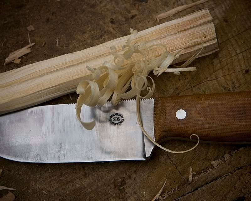

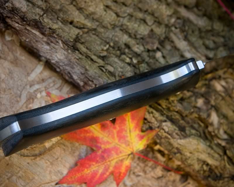

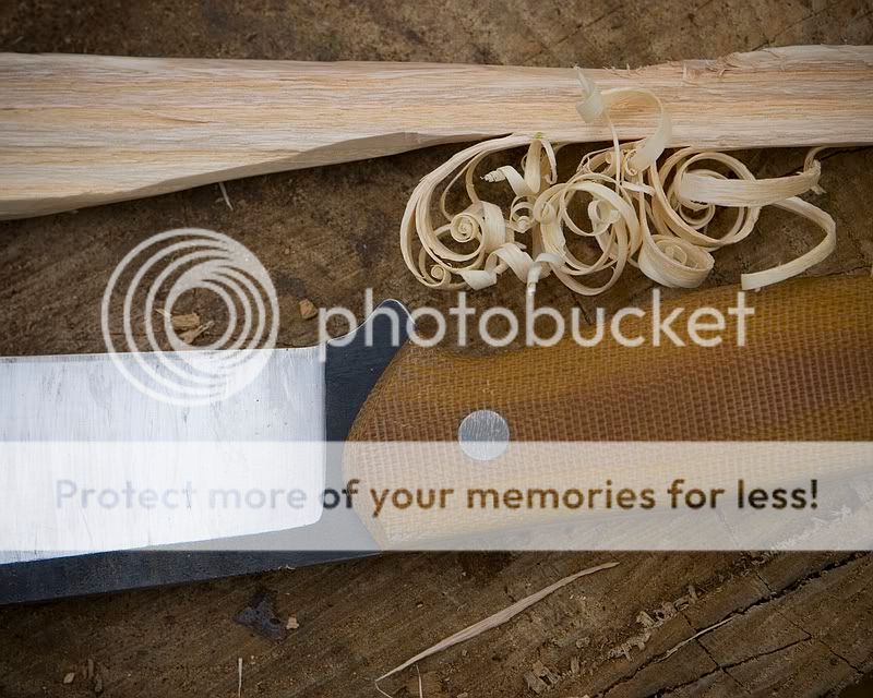

SDS
The knife I made is a general use camp knife. I love big knives but over
the years I've learned that I just don't like to carry them and they end
up laying around instead of with me when I need them. This knife was
designed to be large enough to handle most camp chores without being too
large to comfortably carry.
I made it out of D2 because that is a steel that I have used a lot and I
trust the heat treat I have for that steel. I've been able to abuse this
steel without failures or chipping. Once sharpened it holds an edge for a
long time and I really like it for a using steel.
The thicker steel was used to increase the overall strength of the knife.
The full flat grind was used to decrease the overall weight.
The handle design was made to be comfortable for long term use while still
offering good grip when trying to do light chopping. Although I
personally prefer natural materials I used micarta on this one to increase
the durability. It's hard to argue the practicality of micarta and the
canvas micarta's offer really good grip without feeling "cold".
I'm curious to see how this shorter blade stacks up against the larger
knives in this evealuation. Of course the knife can be made with longer
blades but I like knives in this size range for the reasons listed above.
The greatest knives in the world aren't going to do you any good if you
don't have them with you when you need them.
I hope this answers some of the questions about why I chose this design
and used the materials I did. If there is anything else I can tell you
that would help out please don't hesitate to let me know.

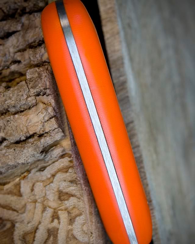

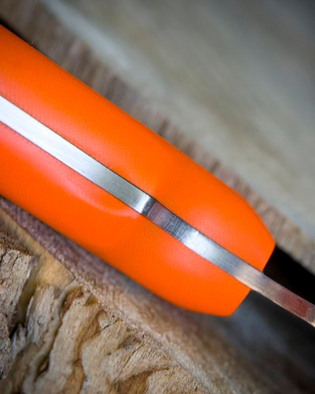

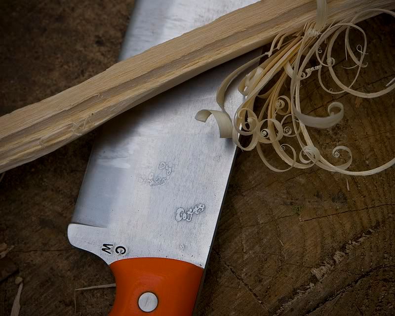

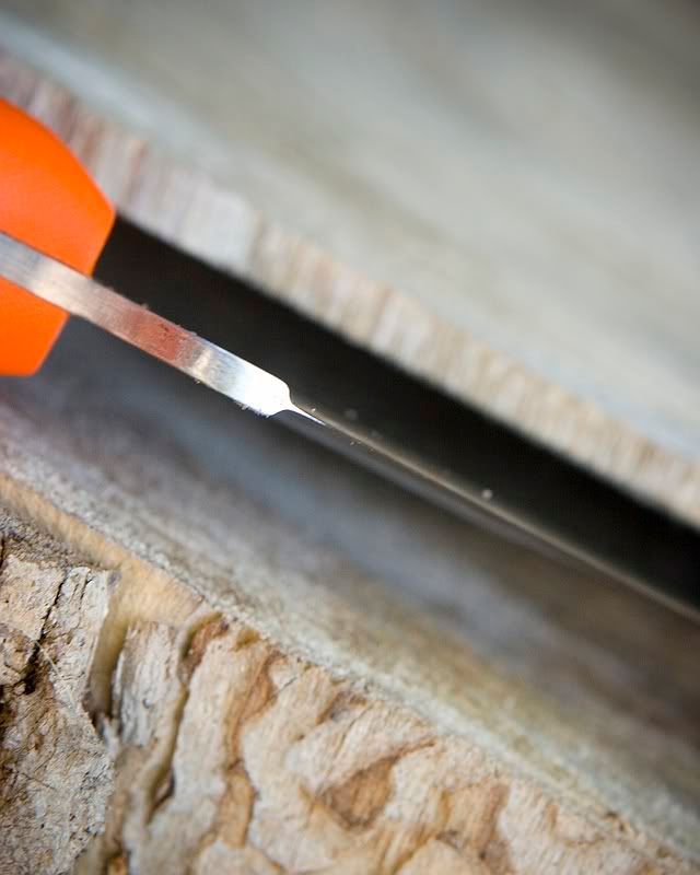

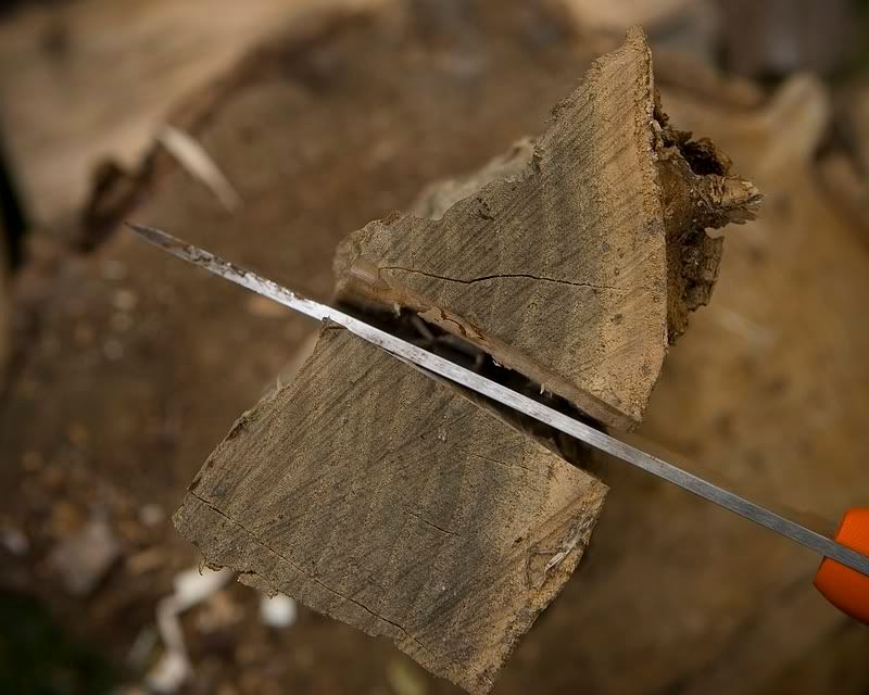

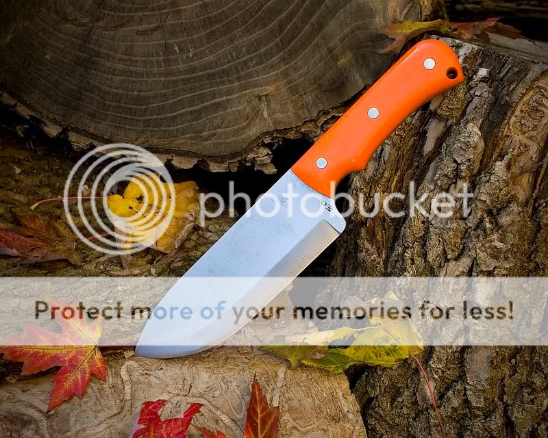

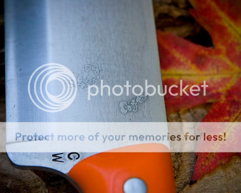

Craig Wheatley
Blade length 6 inches
Overall length 10 ¾ inches
Thickness 1/8th
Steel O1 Toolsteel
Grind type Convex
Hardness 59 Rc
Handle Material Orange G-10 Sanded to 320 Grit, SS pins, Lanyard hole
Selling price of the knife reviewed approximately $200
My only limit for making this knife was my heat treat oven. I can only go to around 10 inches overall. I decided on a 6 inch blade with a 4.5 inch handle. I used this handle style on another bushcraft type knife in the past and I have had very good feedback on its comfort and use. When I think camp knife I think camp kitchen first, everything else second. I went with a full 2 inch high blade like a chef’s knife but for strength I went with a convex grind hoping for good slicing ability but strong enough to baton or chop up kindling if needed. You would not be using this knife in a 5 star kitchen but it will slice tomatoes and potatoes not split them. I chose 1/8th stock as I think this is more than enough for what I expect from a camp knife. The point is centered so drilling is possible. Handle is bright orange G-10 as it is one of my favourite handle materials. I had wanted a Kydex sheath but ran out so I had to make up a simple leather sheath for it. My choice would be kydex with lots of lashing points. The kydex is rigid enough for the knife to be tossed into a backpack and not have to worry about it. All my knives come with a lanyard hole as I think it is important for chopping or using the knife over/around water. Finally, I chose O1 as I really like its properties and performance.

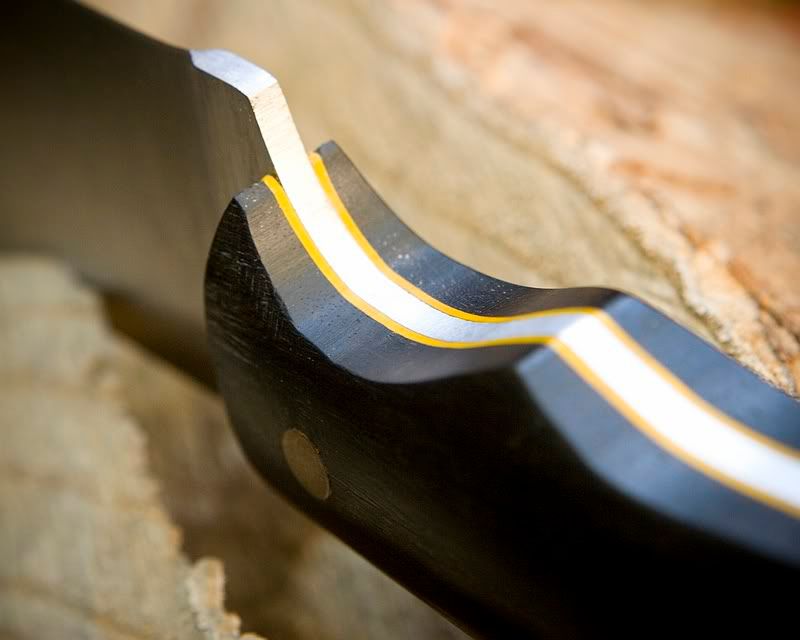

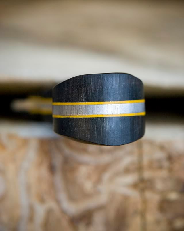

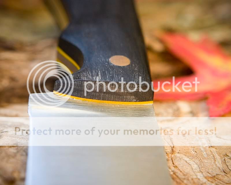

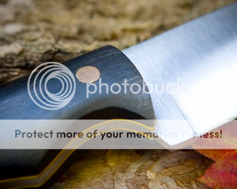

Stomper
The specs of my entry are as follows:
Overall Length: 10 7/8" overall length
Blade: 6 1/8" long (straightback style) x 1 7/16" tall x
Thickness: 1/8"
Steel: O1
Hardness: Not given
Handles: contoured ebony handles with yellow liners, 2 - 1/4" brass pins and 1/4" brass lanyard tube
John’s thoughts on what a camp knife should be or be able to do.
- Prep food for meals
- Split and shave wood for fires (1/8" thick batons fine)

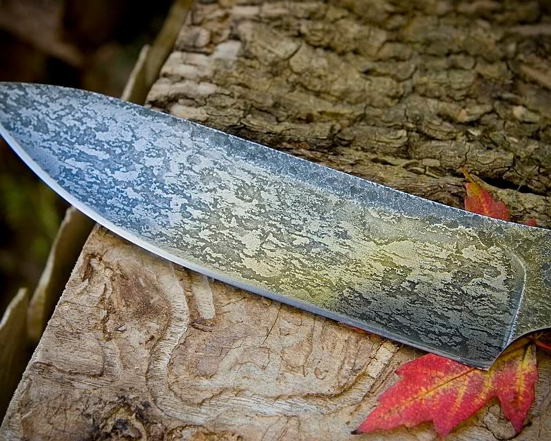

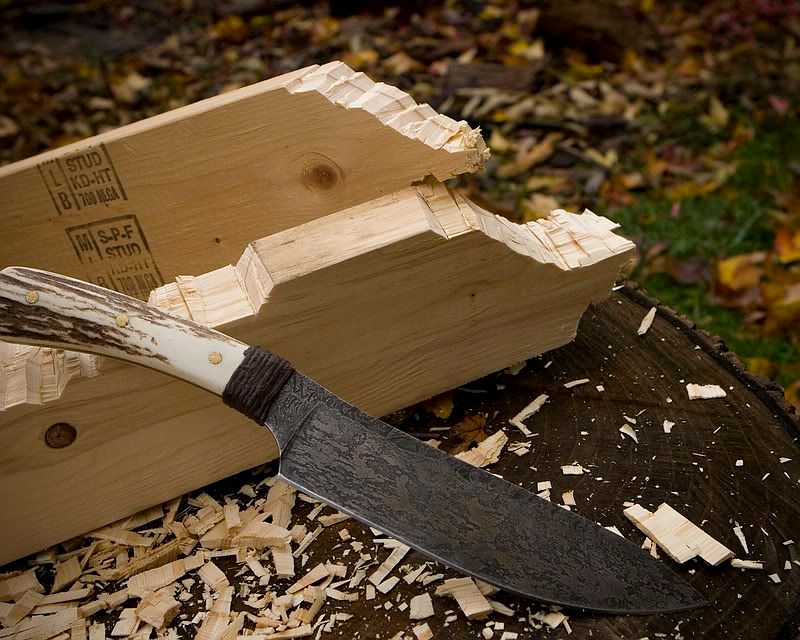

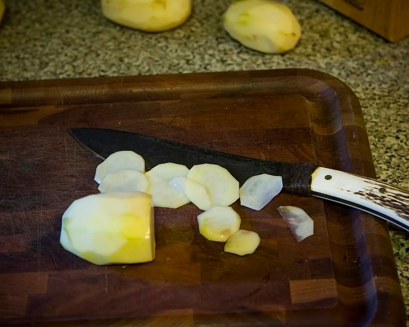

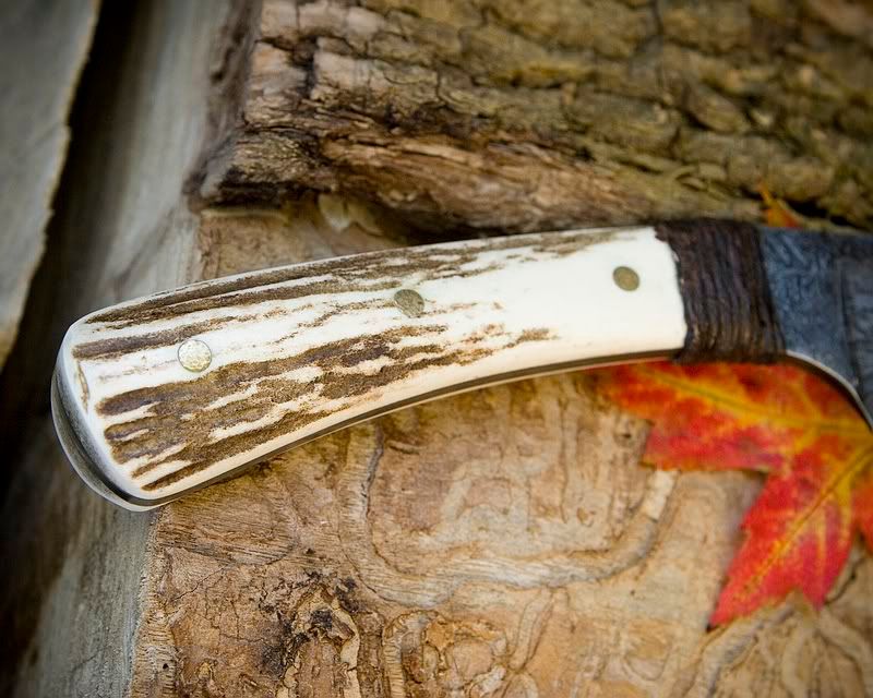

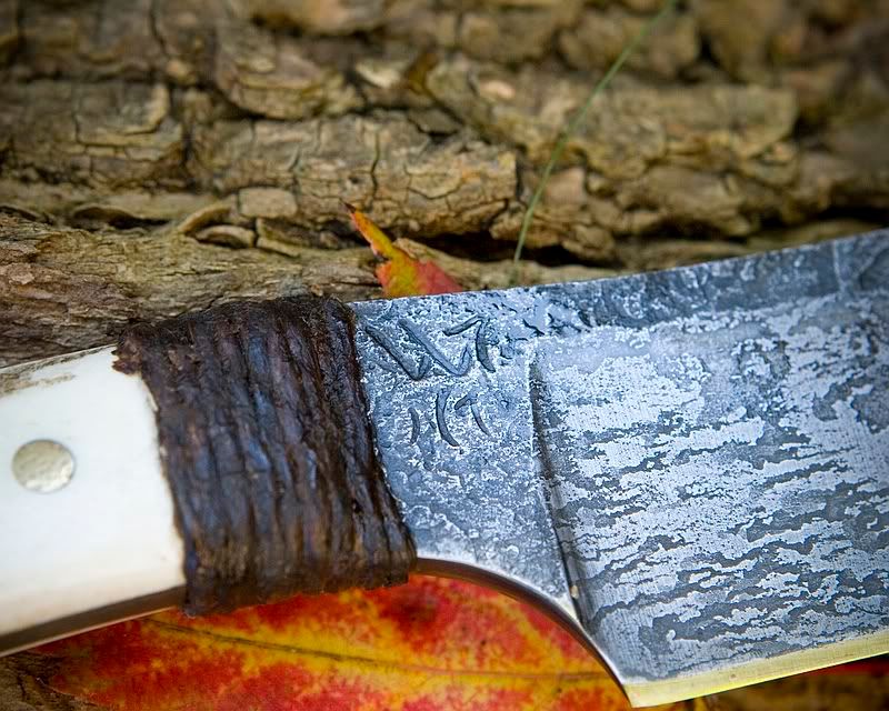

Rick (Magnussen)
SCurve

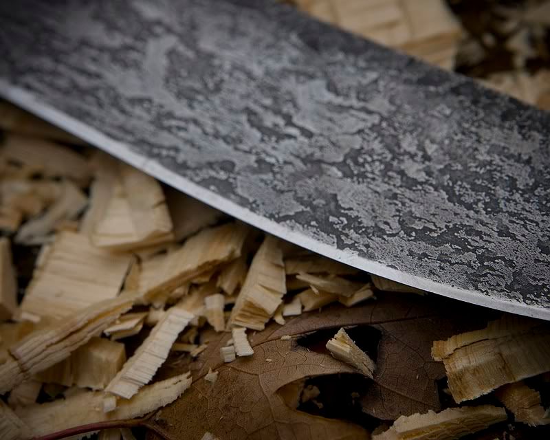

Material – 1080, handforged.
Thickness – 3/16" thickest at spine, distal tapered.
Blade length – 6 1/2” cutting edge.
Blade width - 1 1/2" at widest.
Geometry - Flat w/ convex secondary bevel.
OA length - 11 3/4", balance point at center of ricasso.
Handle slabs - Elk, 4 3/4" long, brass pins, hemp wrap, epoxy sealed, sealled with tung oil and buffed with beeswax.
Finish - Rough forge finish with vinegar/bleach etch.
Sheath - 10oz vegetable tan, hand stitched, tooled and riveted.
Current price for a similar piece $500
I chose to get back to my roots on this one. As a custom maker, I tend to always wanna try something new. As we all know, new doesn't always mean it'll work. So I reached back and pulled heavily from the first designs I made when I was a user trying to make the perfect camp knife. The handle is offset from the blade so that the centre of it is inline with the spine of the knife. This allowed me to get behind the blade without over-extending my thumb. It also gave my fingers some clearance when cutting on a flat surface like a board or a log.
The original sketch of the contest knife took on the same handle config as my first knife but with a larger blade for chopping. The blade is actually upswept with a small drop point. I has some belly to it and the drop makes for easier skinning. I decided against the "bearing block" divot in the handle scale as they tend to burn out after time. I also removed the lanyard tube. In all my years of bushcrafting, I have never used a lanyard on a beltknife...
The final knife turned out very similar to the sketch other than the blade is a bit wider... The balance point is just in front of the hemp wrap.

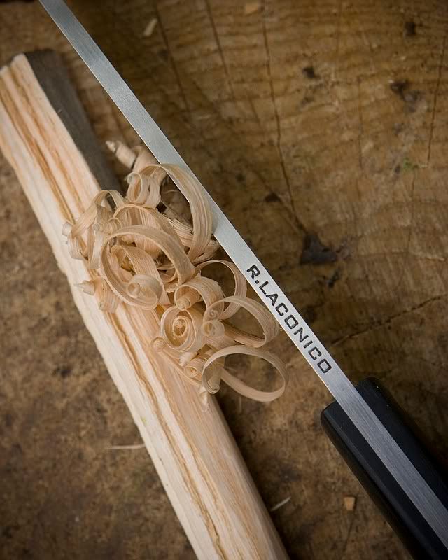

Laconico
Before I started, I was looking at the list of tasks that you had for the knife challenge. I made this knife to be something that I'd want given those challenges. I made the knife with me as the user in mind. I designed a very simple knife. It's what I think will work. It's not the best design for everything but I think it is versatile enough to at least be able to do all the tasks. I guess versatility is what I was after.. There I found the word I was looking for!
I did it by stock removal with 3/16", O1 steel. The handle is linen micarta. The leather sheath is also by me.

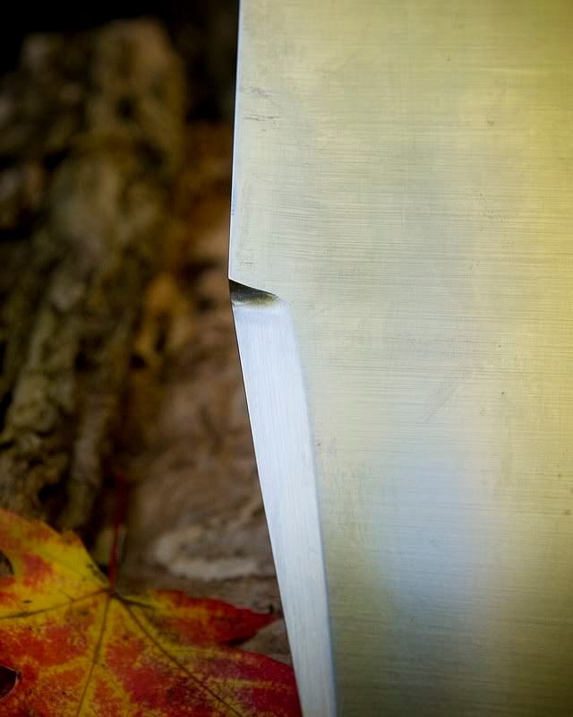

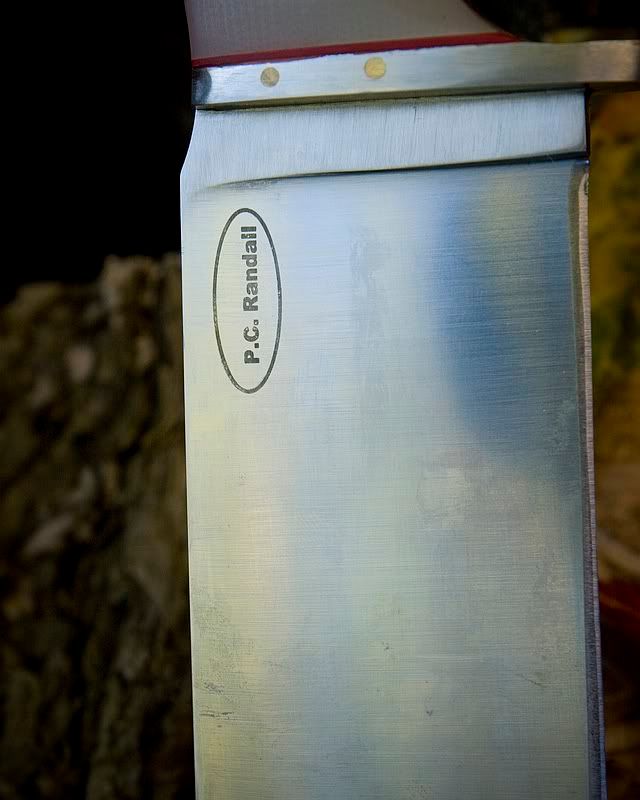

Fit and Finish
Before I begin this section, I want it known that I am not drawing any conclusions from my observations. Everyone has a different opinion on toothy versus polished edge, slippery versus rough handle, etc. When I point out stuff here it is not to say one is good, and one is bad. I am simply pointing out what I see.
Also, with a lot of this stuff, I am probably being WAY more picky than the average user. And, I know what to look for in certain areas because I make knives myself. If I point flaws in the manufacturing, it is not intended to be negative. Just simply pointing out what I see.
Again, I am leaving it up to the reader to gather the facts I am presenting and make their own decision. For example, would you rather purchase a flawless knife for $1000, or one with some imperfections for $50? I am exaggerating, but hopefully you get my point. In the end, what you want and prioritize for yourself is not my call.
Finally, I decide to not give knives a rating in this section that will count in the final total. I fully intended to. However, when I started actually trying to put numbers down, it was just too hard. Somewhat every score in this contest is subjective. But, some things are more cut and dry. A knife cuts, or it doesn’t. It drifts, or it doesn’t. But, my rating fit and finish is much more grey. Take for instance one of the rustic knives (like Rick’s or Koyote’s). That look is part of the overall package. I think they are both amazing. But, Laconico’s work is flawless. How do rate Rick’s knife (which is super aesthetically pleasing) to Ray’s knife where I can see absolutely everything going on? In the end, I just decided to leave you with pictures.

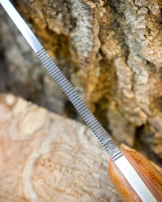

Koyote
Nice tip!
Filework.

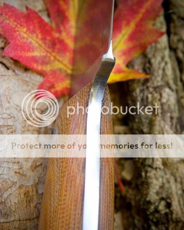

Handle fit is nice.
Side view.
Nice fit here too.

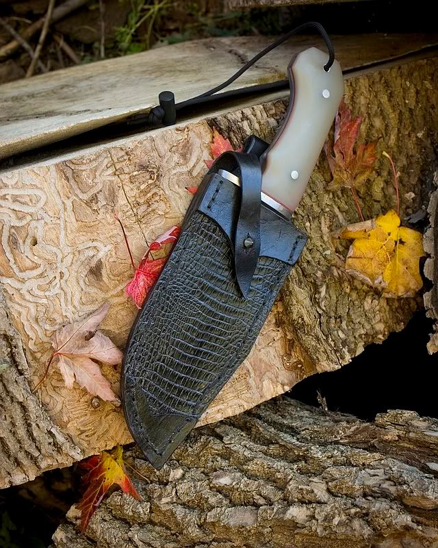

Okay….this sheath is just amazing! Beautiful to look at, and the strap looks super functional as well.

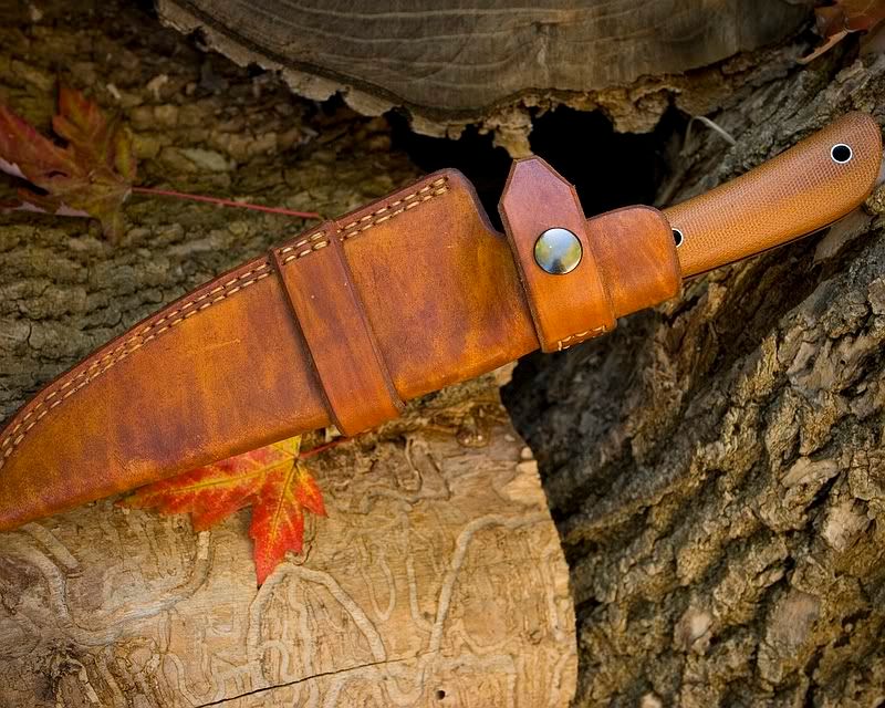

Sheath.

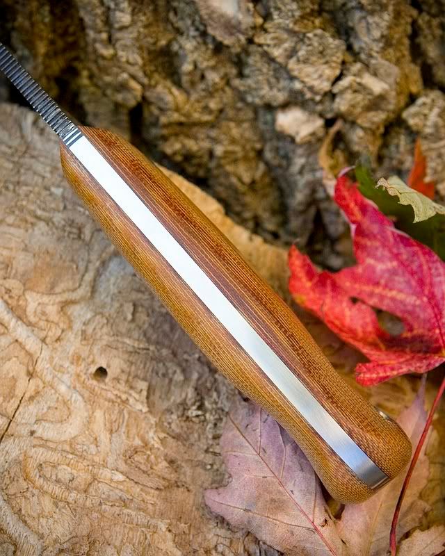

Bruce Culberson
Nice finish!
Perfectly even grinds!
Comfy looking handle.
Nit pick is all I can do with this one. The only thing I can spot is there is a slight transition out of the corners. It is not even visible in the pictures, but I can see it by eye. I am being very picky though!
More handle.

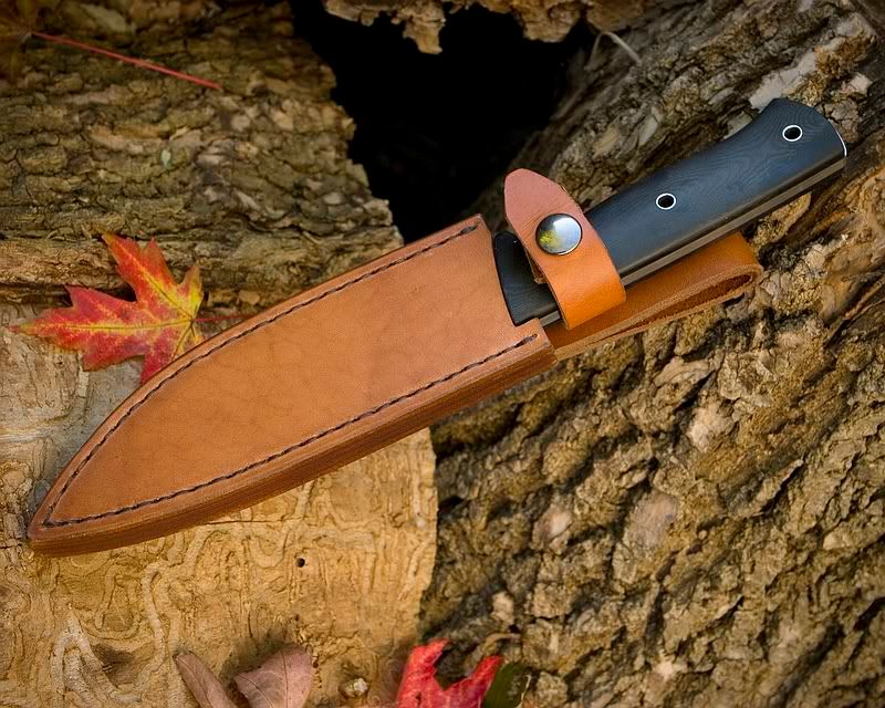

Nice sheath.

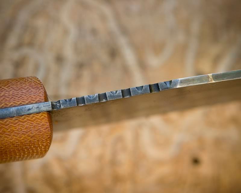

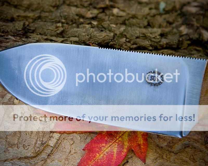

Koster

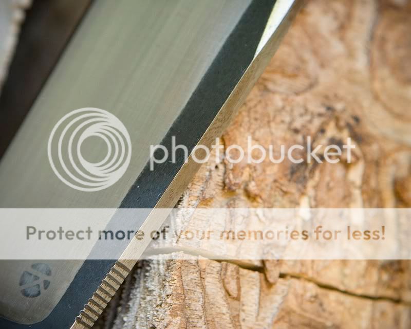

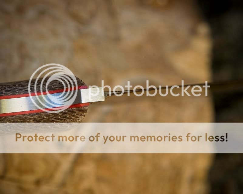

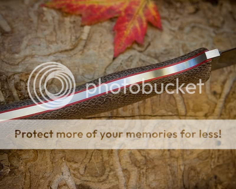

I really like that Dan left the spine (forward of serrations) square.
But rounded every where else for comfort.
To Be Continued.....
Nice job!
Finish is nice.

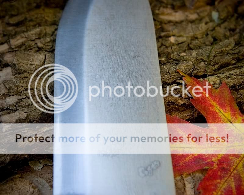

This throws me a bit. It looks like a mill finish, but with the chamfer, it must have been bead or sand blasted.

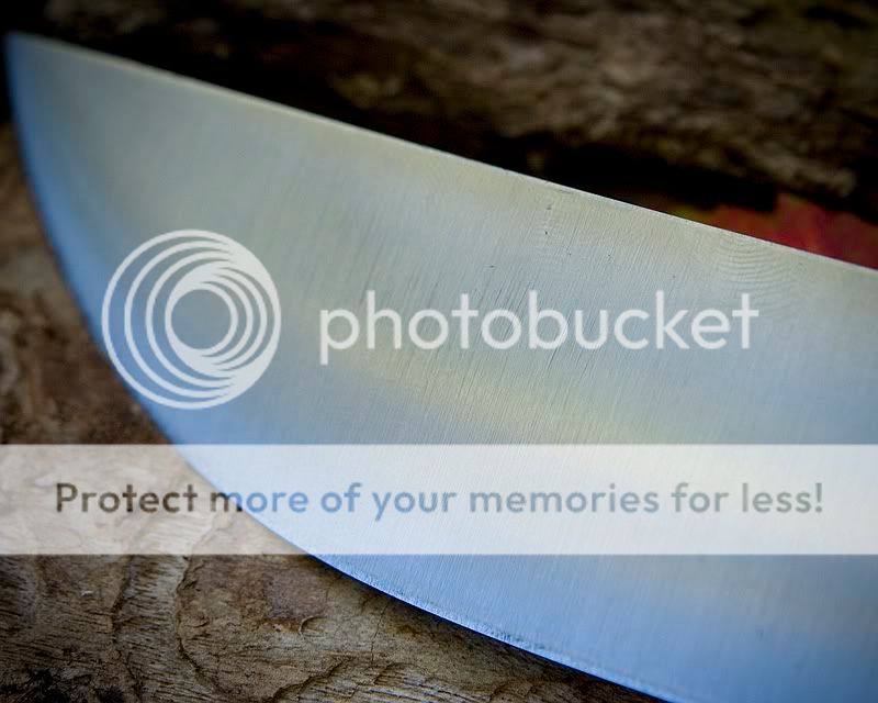

The blade finish really throws me. It is obviously a belt finished blade. I am guessing that the sheath could have put the long ways scratches in the blade, but there are a lot of them! It almost looks like you started to put a hand finish on it, and quit.
The secondary grind is pretty uneven. As you can see, wide:
The evens out.
Then super thin.

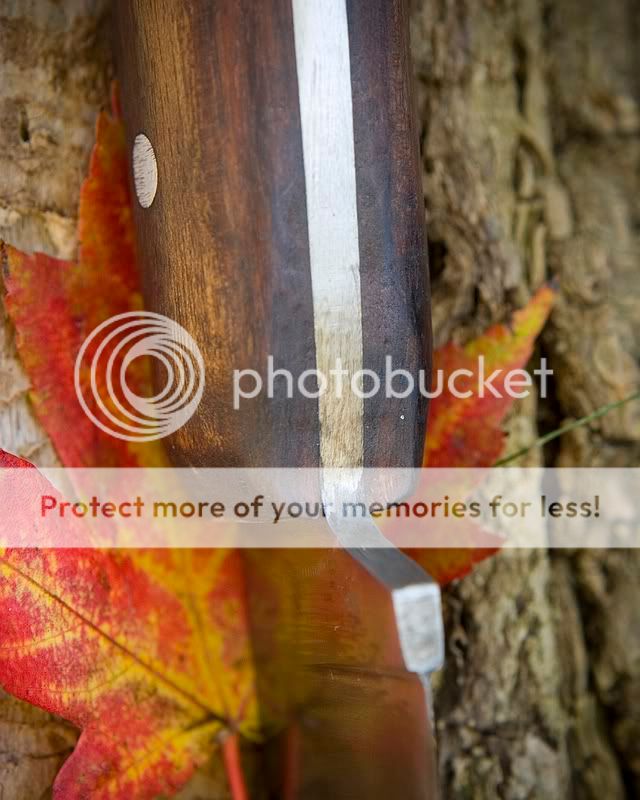

The sharp transition areas of the handle are not as well sanded as the rest. Hard to tell in pictures.

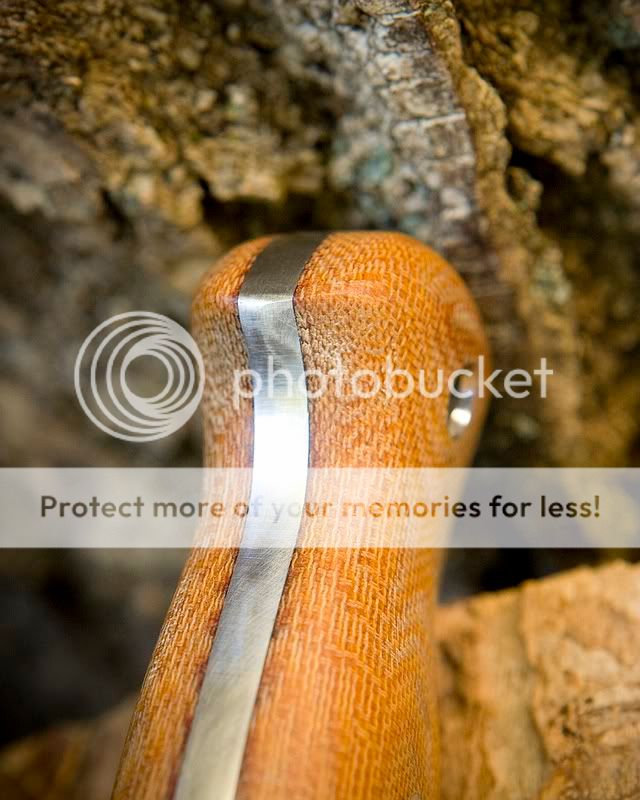

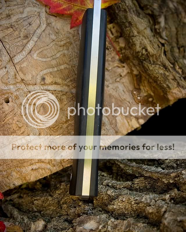

Spine shot.
Handle fit.

Cool sheath and neat little carving.
Craig Wheatley
Some funky stuff going on with the finish.
You can still see machine markings in the steel.

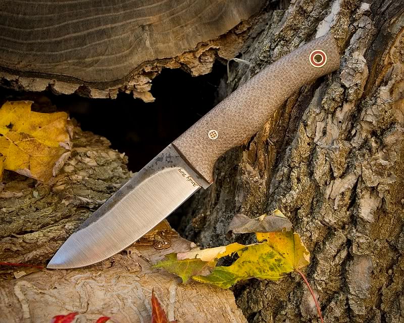

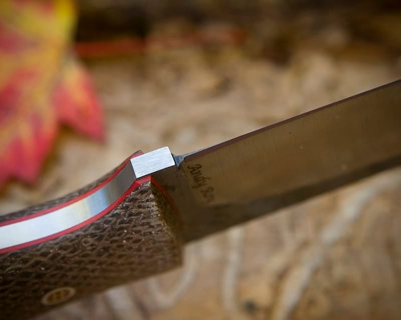

Fiddleback

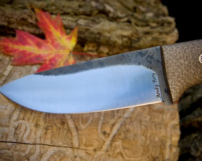

Nice saber convex, with belt finish.

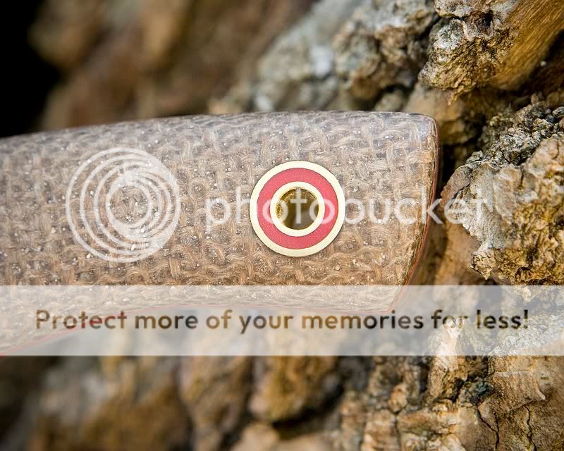

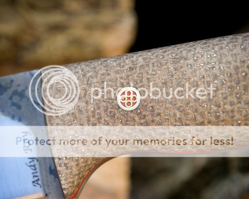

Mosaic pin and burlap micarta.
Andy’s ball bearing look : )
Nice fit and finish all around.
These next two pictures I hate to post. Mostly because it is not typical of Andy’s work. Andy is famous for sharpening all the way back. But, not on this knife.
From the side, you can also tell that the secondary grind is uneven, and fixing by the end user would require more than a stone.

Rick

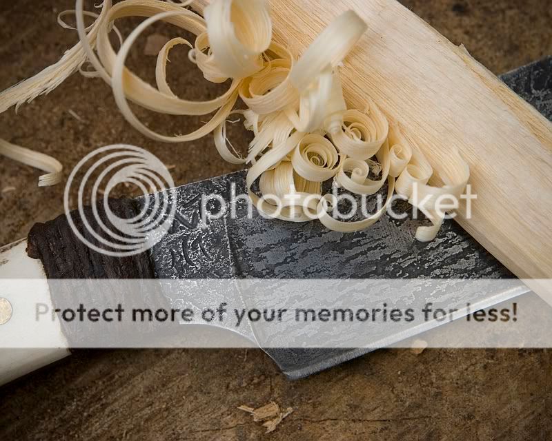

Cool looking patina.
To Be Continued....
Nice antler handles.
Handle.
Wrapping.

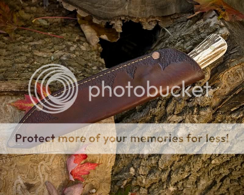

A sheath that compliments this knife beautifully.
I could not really find anything to nit pick with Rick’s knife.
Laconico
I think someone should check Ray’s pulse, because I suspect he is a robot! This thing is perfection!!!
Nice belt finish.
Perfectly even and matched grinds.
Now this is classy!
Fit and finish is top notch!
Sheath is very simple, but elegant. I like it!
Patrick
Just observing.
You can see there are a couple grind angles in the final “grinds.”
Guard fit.
Looks like a bit of liner smeared over the guard.
A bit of a rough spot here.
Observing again.

Bruce Culberson
This one has caught me by surprise. It is a well rounded design, nicely executed, and feels great.

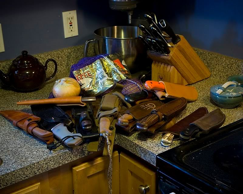

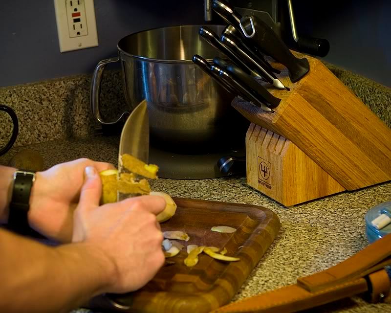

Cooking
This one is one of the important ones for me. Mainly because I like to cook, and for some reason, even enjoy it more in the outdoors.
To me, cutting meat (or any more deformable substance) is not that big of a deal. All you need is a sharp edge, and you really don’t get a good feel of whether or not the overall knife geometry is helping you or hurting you. For this test, I have chosen a non-deformable camp food : )
Many times I have been fishing in northern Canada, and whether it is to accompany fresh caught fish, or to go with eggs in the morning, fried potatoes with chopped onion, garlic and salt and pepper is a camp favorite!
Of course, being manly men, you would be laughed off the island if you pulled out a potato peeler! : ) So out come all the sheath knives to get the food ready. Yes, I am going to peel them too with these suckers!
A bag of potatoes, some onion, and a free kitchen while the wife is gone! : )
I split this up into 2 sections. The first was how the knife did and the peeling portion. The second was how they did at the slicing portion. I scored each individually, and then averaged the two for the final overall score for “cooking.” It turns out that preparing the onion really did not provide any additional useful information than peeling and slicing the potatoes did. Just more of the same. Because of that, I neglected it in the comments below.

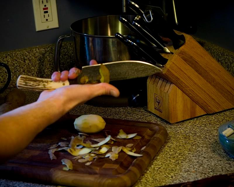

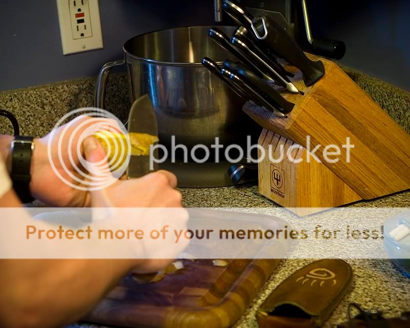

Here are some of the peeling action shots.

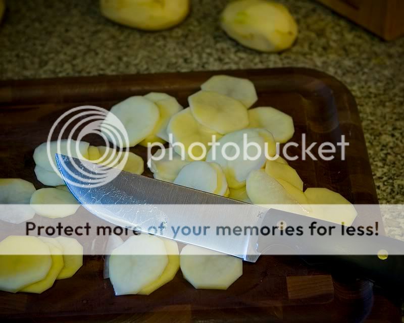

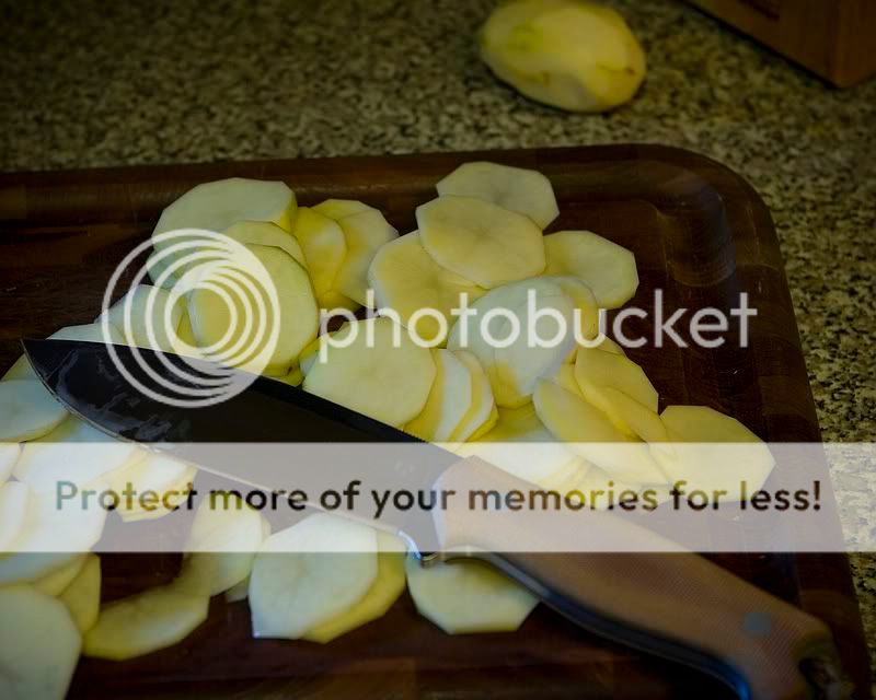

Here are some of the slicing
I will summarize my thoughts on each knife for both tasks.

Rick
I think I have found the world’s most expensive potato peeler! Again, this knife popped out on top with sharpness, and it is showing here. I don’t know what else to say.
Good lord, this thing can slice too! Sharp and proper edge thickness. It’s a beautiful thing. The knife almost guided itself through, and I could make paper thin slices without even really trying.
Obviously, I rated this one a 10 on each, for an average score of 10.

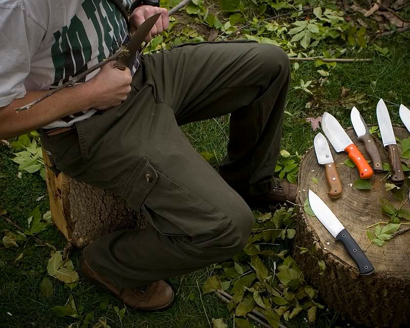

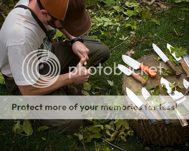

Bushcraft

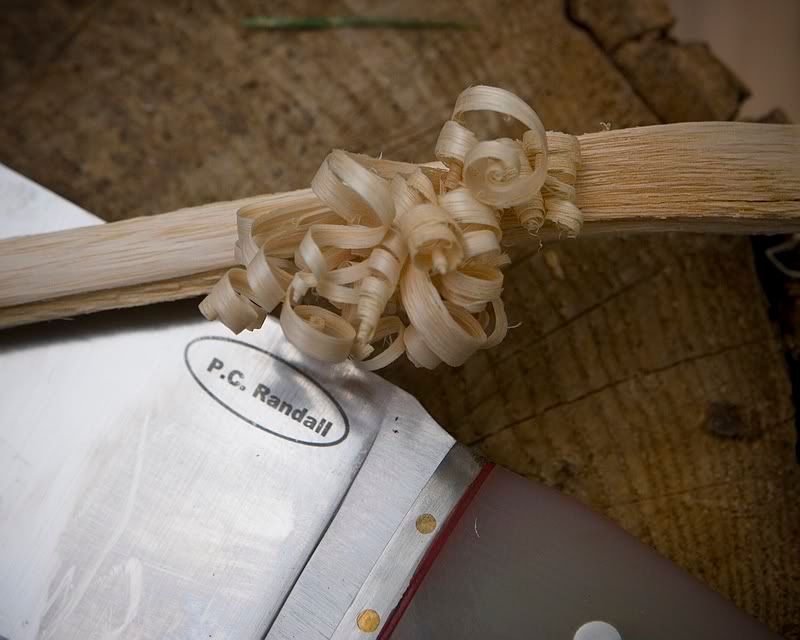

For someone who claims to have “bushcraft” as their first love, my little wimpy pet project for these knives is going to seem lame. I really wanted to come up with some grand scale project, that would be worthy of switching between 11 different knives! But, the actual task of switching between 11 different knives, trying to get a feel for them, and write down my impressions was MUCH more time consuming than I ever imagined.
So, what I did was to just do a simple project. In this case I built a simple cooking crane. I also did this was some green, freshly cut wood. The reason is, a lot of buchcraft things are made out of these types of things, and as you know, green stuff cuts and acts differently than dried wood. I would be doing dry wood cutting later anyway.
Building this quickly would in no way get me a chance to use each knife enough. So, I did a couple things to help with that. First, I made sure and finish the details as much as possible. Instead of just hacking off the stick, I made it nice and round and smooth. Second, I just kept doing the same task over and over again : )

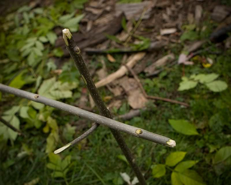

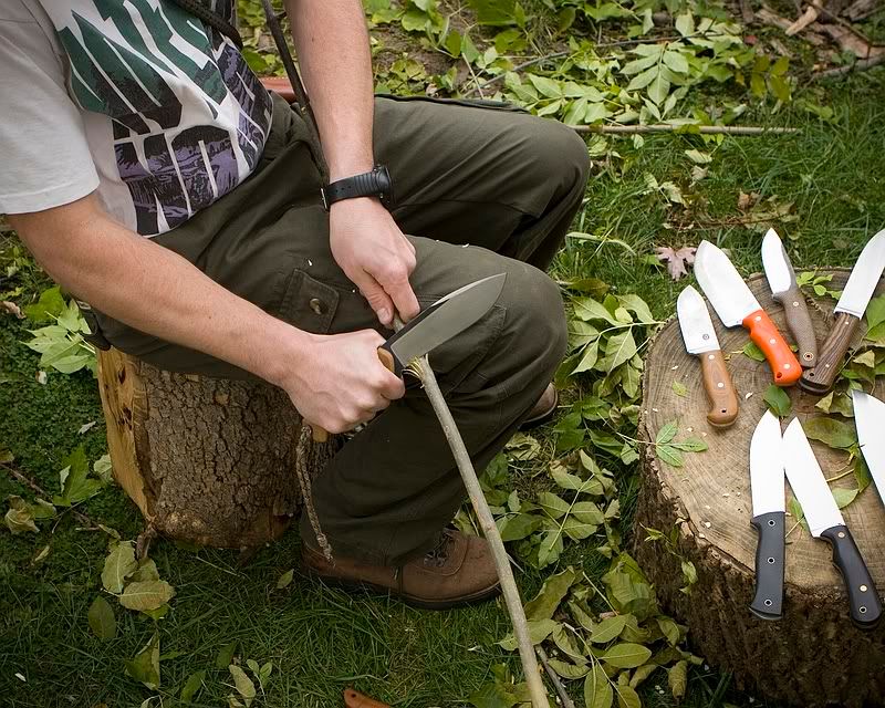

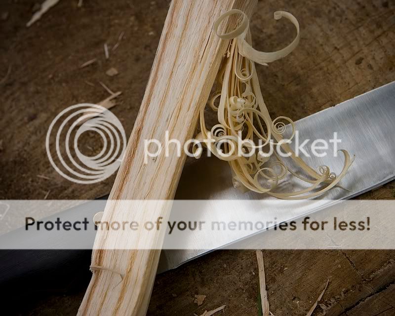

When I cut a stick to length, I rounded over the edge, and kept whittling a way to get a nice finished end. When I was done, I simply moved up an inch and started the whole thing over with a different knife : ) In the end, I am glad I did it this way because it seemed to keep the density of the wood I was working with as similar as possible for doing the same task.
Here is a pick showing I just chopped off my finished end, and started over again.

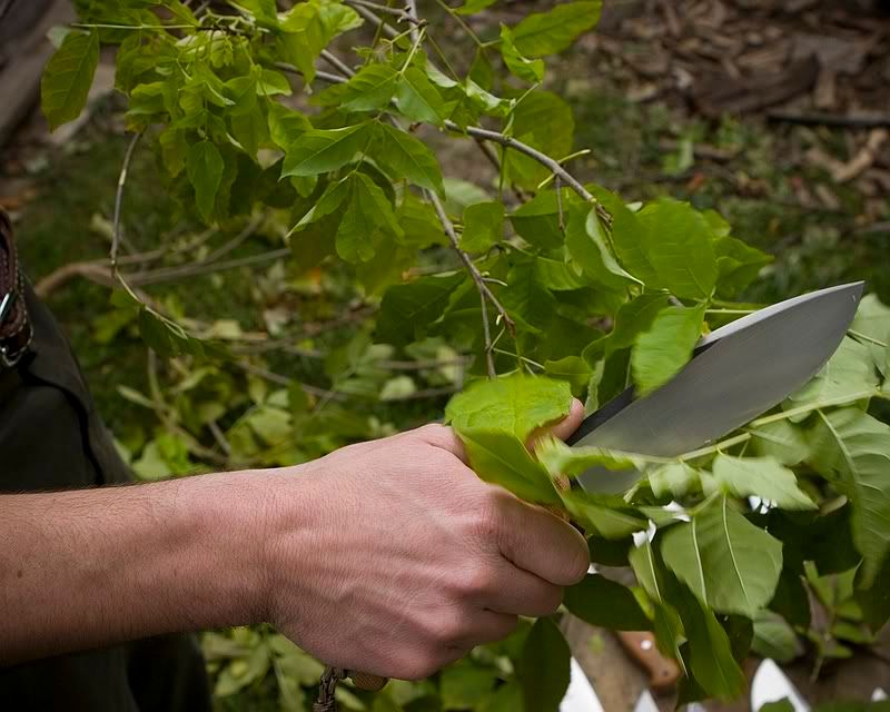

So, what I did was harvest a bunch of ash saplings that were growing like weeds around my place and needed to be removed anyway.
I played a little bit with the knives stripping them clean.

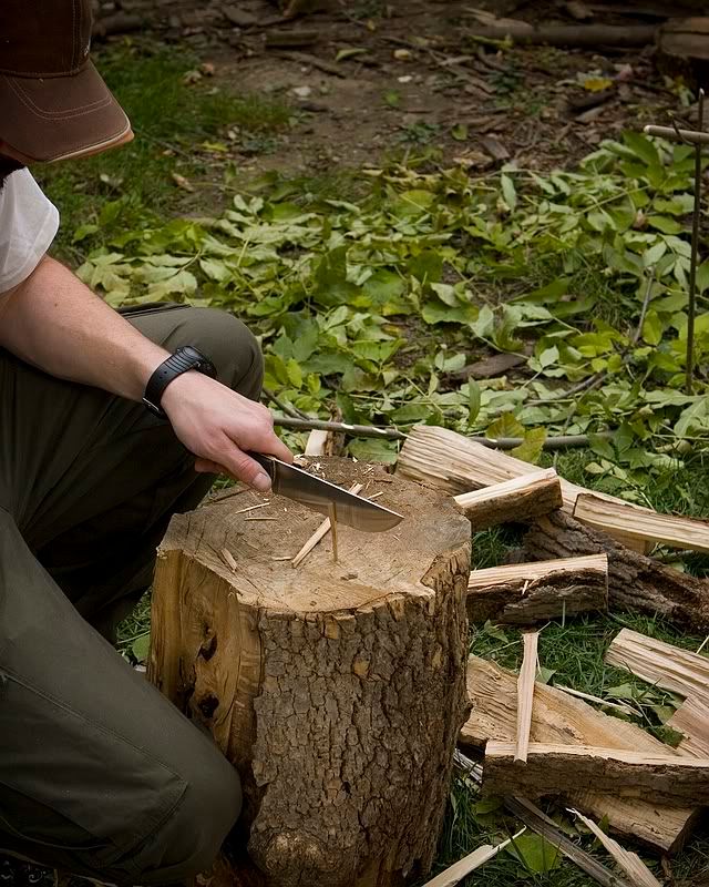

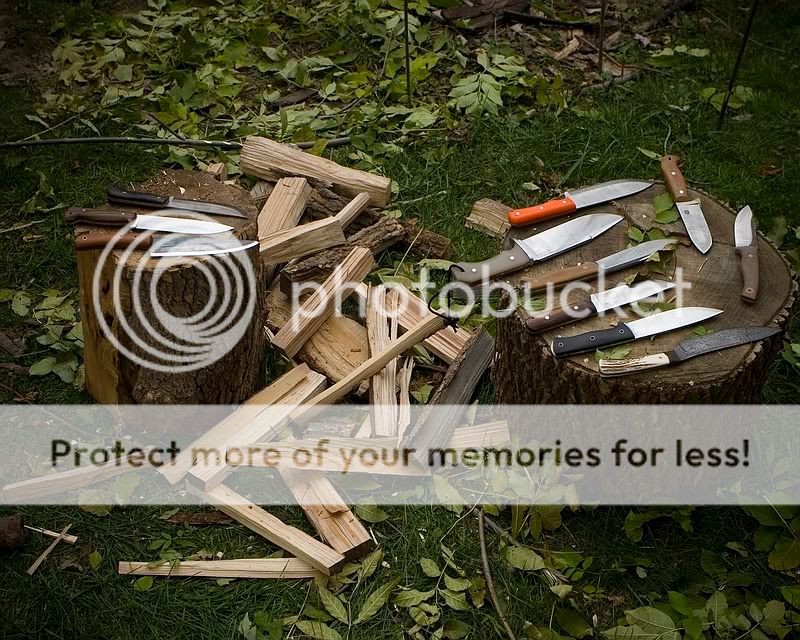

Now to figure out what pieces would work for what part.

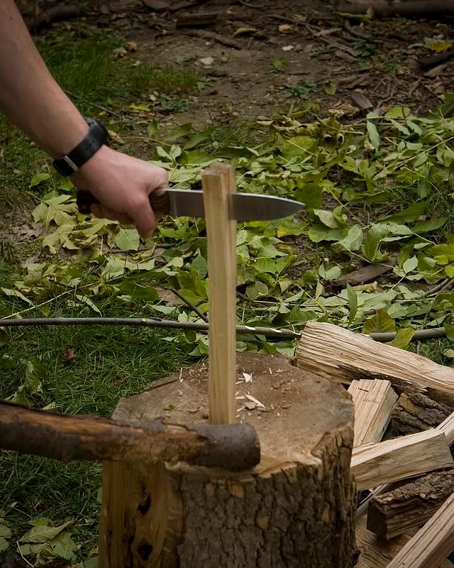

I played with cutting sticks to length, tiding up ends, making points, and was only able to make one notch for this particular project. I also got a good chance to use the knives in various grips. For the most part, I focused on the forward grip, the reverse grip and the chest lever grip. I will comment about all those each individually. Here are some of those “in use” pics.

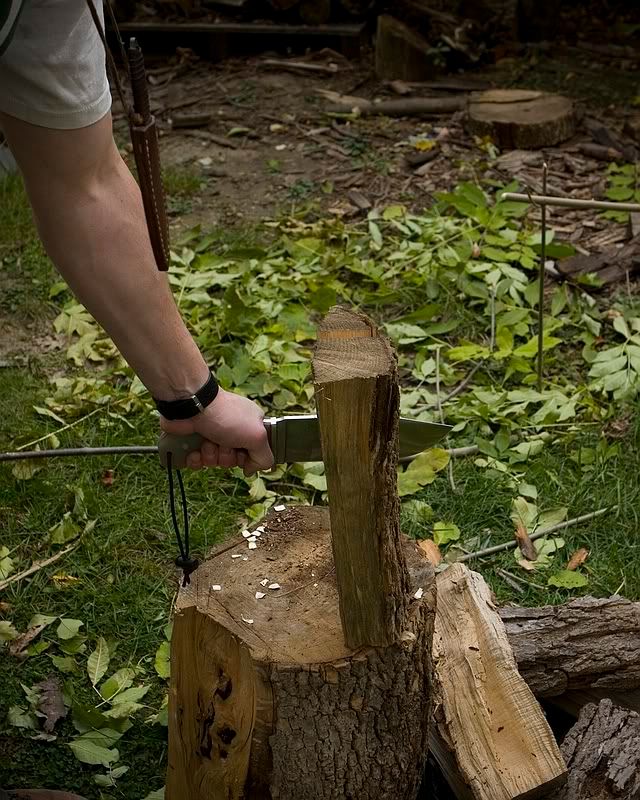

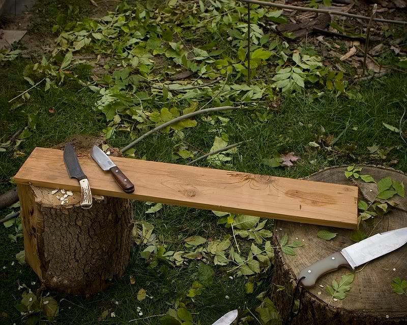

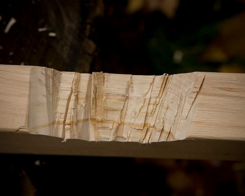

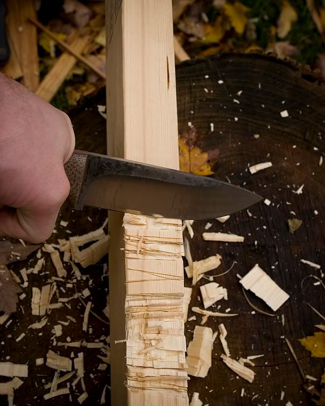

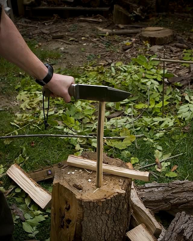

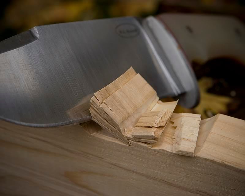

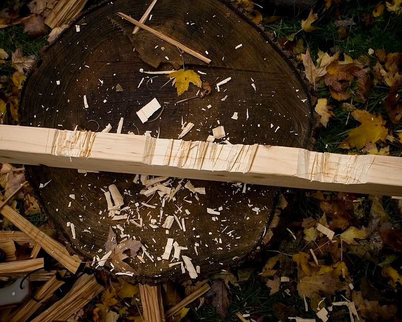

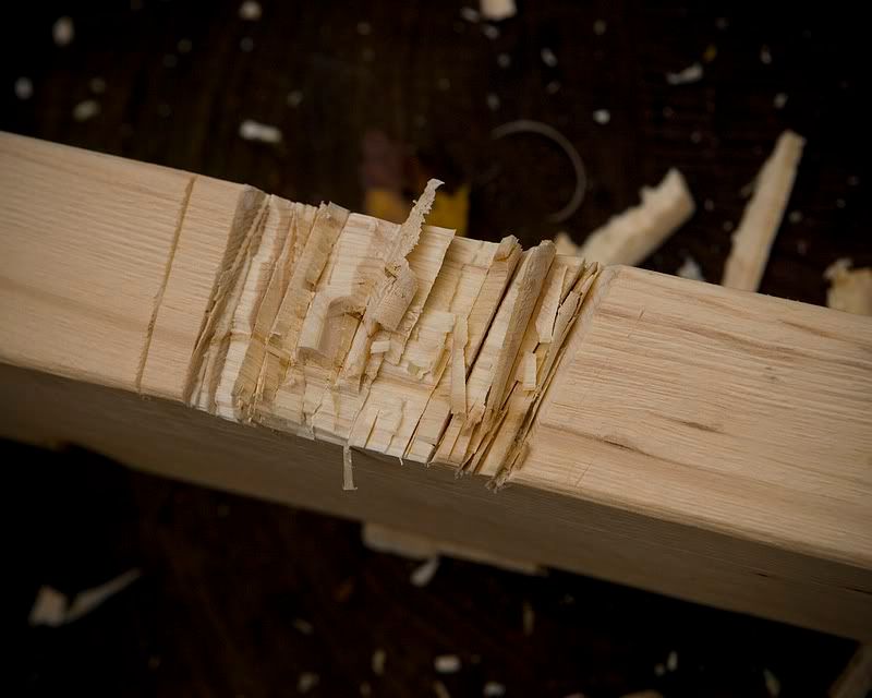

Since notching is a commonly done task for bushcraft projects, I felt like I didn’t get to do enough of that. So, after I was done with my crane, I took 3 additional limbs and just kept notching them over and over. Both with the batoning method, and with nothing but standard cutting. For making many notches, I much prefer to baton the end part of the notch as it really speeds things up. Here are some pics of that.

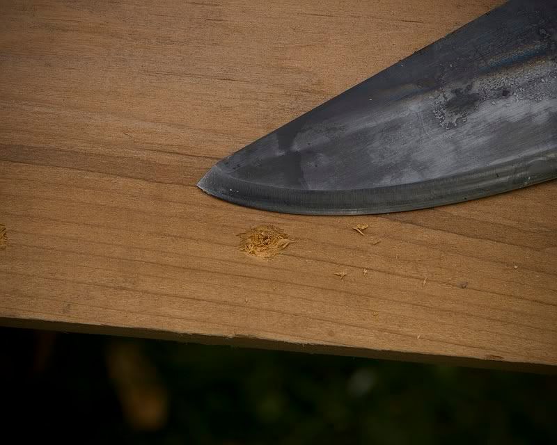

Finally, I wanted to see how each knife did in drilling. While I will often do this for certain applications when building stuff with green wood, I think by far, the most widely used application of drilling is in creating a fireboard. Having pretty much all hardwood around my place, I wanted to make it more realistic and use a medium density wood. So, while I weaseled a bit on this, I pulled out a piece of cedar lumber. While not my first choice of wood for a fireboard, it certainly was the hardness and density I would want. So, I went with it.
Here is a couple pics of me drilling my home depot board : )
I ended up doing about 6 points with each knife. This was much harder to tell variation between knives, with the exception of a couple standouts. Will tell about those below.

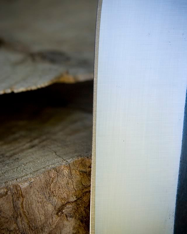

This picture shows the sharp radius that I was talking about. I am comparing it Rick’s knife which is the most similar, but has a larger, sweeping radius. I will detail in Rick’s section how his did.
Definitely to a point that I was uncomfortable cutting in this way. Since reverse grip cutting is such a big deal for me, I had to rate this knife lower because of it.
So, I rated this knife a 7. However, I must comment that the cutting ability was great, and comfort was top notch as well. If not for my small dislike of the reverse grip, I would have definitely rated this one higher.

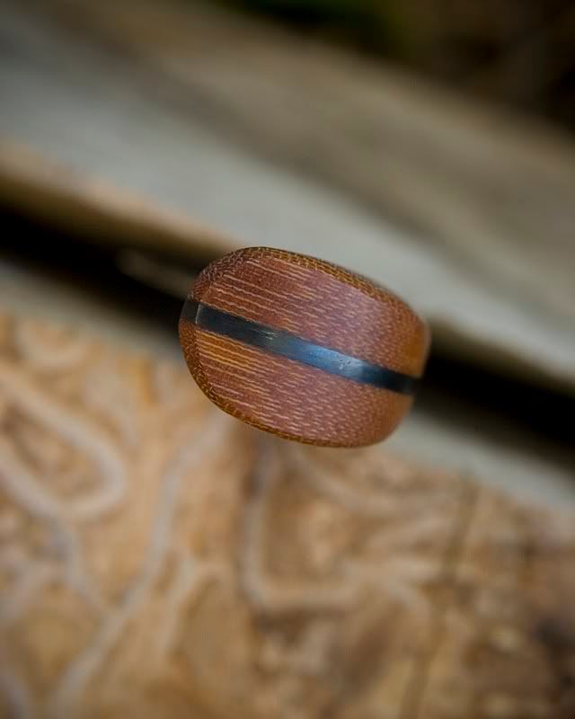

Rick
All of this stuff I was doing, really revolves around cutting. While cutting, sharpness is King! So, it is no surprise that this knife did extremely well.
The rear hump on the handle makes this an extremely comfortable knife to hold. Meaning that forward grip is really nice. The chest lever grip is awesome on this knife, and it did good for drilling too.
The reverse grip did just fine, but I feel you have to know what you are doing while using it this way.
I feel that the handle hump and the sweeping radius from handle to edge does keep your hand in a great position. However, I feel that you do have to know more about what you are doing and therefore requires a bit more concentration.
While I do not think I would change the design at all, I did knock it down a point in the rating, and gave it a 9. I don’t know if that is fair or not. I just felt that in my hands, I was comfortable, but it could be an issue for others. Again, I personally wouldn’t change it.

Batoning and Firemaking
I decided to combine these two sections, and give 3 different ratings. The reason is, I have plenty of large, dried, hardwood logs around my place. In order to get smaller wood for firemaking, I was going to have to get out an axe and start splitting up pieces. Or, I could kill two birds with one stone, and just baton everything down to size for firemaking : ) So, that was the route I went. The rating sections are Large Wood Batoning, Medium Wood Batoning, Small Wood Batoning and Fire Preparation as one.
I still will however rate these independently, and let you know where I draw the line between batoning and tinder prep.

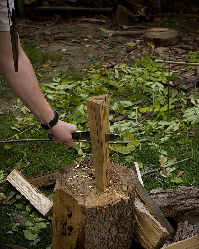

I have about 20 face cords of wood that is mostly split and have everything up to full size tree rings : ) I started with some larger pieces of wood, to be worked down. This is all ash. While it is generally straight grained, and one of the easiest woods to split, I managed to get a hold of yucky grained stuff! Some will split easy, and as you will see, some is just a bear!

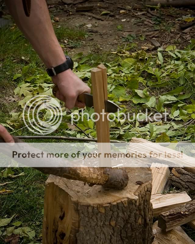

Here is the wood I started with.
I then started with larger pieces, and will the give each knife a rating on this section alone. I have to state that the two shorter knives in the group are going to get an extremely low rating. Nothing to do with how good the knives are, but this was one task that I thought was key in a “Camp Knife.” Being of size to not allow any tip to protrude to baton, means essentially that the task can not be completed : (
Here are a few pictures of that going on.
I started laying into a piece of particularly twisty wood with Koyote’s knife. It was giving me a lot of trouble, and I noticed that blade was starting to bend. The effort was also getting beyond what I really wanted as well.
I decided to call that good, and stop right there. In order to get this knife out safely, I did have to give the handle a couple of whacks. It absolutely showed no signs of me doing that at all.
The bend was actually only (in my opinion) a slight flexing of the blade. Everything was cool with it, and in fact is a sign of a good heat treat. If you remember, this is the thinnest knife in the lot. Way to go Koyote!
I did experience this exact same issue with Craig Wheatley’s knife as well.
Again, I decided to call it, and remove the knife. I was about to move on, then decided “What the heck. Let’s send Patrick’s Big Boy in after this log!”
Tada! We made it. That thing is a beast of a knife. But, let me step back for a moment in order to get all philosophical on my outdoor and survival perspective.
I decided to drive this monster knife through this logs for shits and giggles. It was a TON of effort. My baton arm was fatigued, my knife hand was hurting, I was sweating, and breathing hard. Regardless of what the knife can or can’t do, we can choose to make smart decisions in the woods.
If this was a survival situation, I would feel this was a waste of precious energy. To me “survival” is more about smart energy conservation than it is Bear Gryls theatrics. I would never do this under those circumstances.
In a non life threatening “woods bumming” situation, I would have again saved my energy and simply looked for a different piece of wood : ) Knowing these things are the tricks that separate a truly good woodsman from the others, in my opinion.
Long way of saying that while I think it was cool to go ahead and do this, I personally see it as totally unnecessary for a knife to HAVE to complete in order to be deemed an excellent camp knife.
Enough of my rambling, back to the test.
I am moving on to medium wood batoning and will save all my comments and ratings until the very end.
Medium wood was just more of the same. Getting smaller and smaller.
Smaller wood is not getting into fire prep territory.

Here is my summary of each, followed by the rating for each section.
Koyote
While this knife was the thinnest of the bunch, the length was fine for large wood batoning. I already filled you in on my thoughts for an absolutely unforgiving knife. So, I am more than fine with this one as is.
The thin blade made the medium and small wood a dream! It was down right great on those!
The handle is extremely comfortable on this knife and a pleasure to use.
The characteristic of the scandi-vex edge really makes wood almost curl by looking at this knife while making fuzz sticks. It should also be noted that in just making shavings (not fuzz sticks) this knife works great and it good in the grips I use to do that.

SDS
This is one of the knives that will not get such a good score in the large wood batoning, simply because it didn’t have the length. It really had nothing to do with the overall design.
It worked just fine for the medium wood and smaller, and was a great fuzz stick maker and good for making fine tinder.
Craig Wheatley
This knife did work good on all the batoning sections, despite the one bending part, which I feel I have already beat to death : )
In made really nice fuzz stick and in general cut very nice.

Laconico
Awesome, awesome, awesome is about the only way I can describe this knife. I really wish I could get more wordy on this section for this knife, but I can’t think of much else to say. I don’t have anything negative to comment on, and I can only say awesome so many times! : )
Patrick
The Beast! In batoning large wood, mass is king. So, this thing certainly had the ability to get through any piece of wood that you wanted, given enough effort. Hence, the high score in that category.
As you start working to finer and finer work, this same mass starts taking its toll on the user. So, the scores go down and down. While it can perform all the tasks just fine, it is just not quite as elegant at them as the others.

Chopping
Let me first tell you how I decided to test these knives. I have to say, that I am not a fan of the 2x4 chopping test. It just doesn’t seem to make much sense to me. Being up here in the north, I try to avoid pine as a firewood because of the pitch. Pine is really soft compared to the woods I would normally go after, so I kind of figure “what is the point in chopping pine?
But guess what? That is exactly what I did. Why? Because I had 11 knives to test, and I was looking for wood consistency from knife to knife. At least if there were knots in a 2x4 I would be able to work around them, and chop on clear sections. With bark covered limbs, I just figured there were too many variables involved. So, while I am not a fan of it, I decided to keep it simple.
The testing…….first let me say, that none of these knives are what I consider a “good chopper.” Just the overall length of them is not impressive in getting through something relatively simple, like a pine 2x4. Doing that over and over was definitely more exhausting than I had planned!
I only snapped a few pics, and there was almost no way I was going to get some action pics being by myself.
Let me say, if I saw anyone chopping wood with an axe, and producing super small chips like these pictures show, I would immediately be calling technique foul! However, the lack of penetration was making it so that small chips were about all I was going to get. While I am on that topic, let me say one thing about technique. I love axes, and always will. I know my knife chopping technique is not going to be up to par with many other folks. However, since I am imparting my same crappy technique to all knives, I am hoping that I am at least consistent : ) Warning given : )
Different knives being capable of different size chips.
When I got bored or fatigued with one knife, I set it down and move on to another notch.
As you can see from the scale, the smaller knives were not going to fair so well. They were almost just making “marks” instead of chopping.
Lord this was a long day!!! Getting through the wood with these tiny little chops was insane!
Here are some of my favs.

Patrick
Again, the beast! This one was not as elegant to use as Rick’s knife. But, you can not deny that the size and mass of this knife led to deeper penetration and better chopping than any other. So, I rated this one the highest.
I rated this one a 9.
